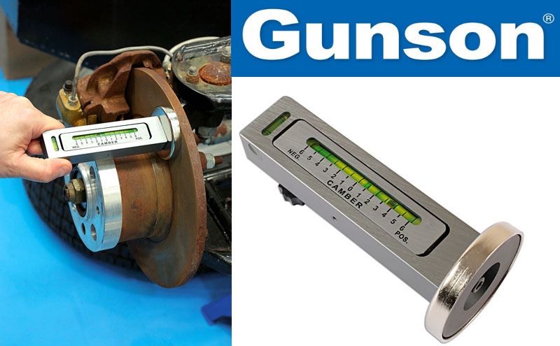

2 hours ago, Regal said:
 Been told by multiple shops there’s no alignment or anything for the back.
You've been going to the wrong shops.........the toe is adjustable as is the camber angle
there is a setting for the proper camber angle, if one does not have in their possession a camber angle gauge then one goes to an alignment shop.
As I said the desired is .5 negative
