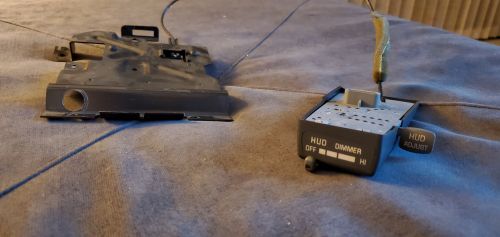

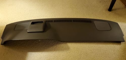

Good news!  Your SE is pre-wired with the connector for the HUD.  There are a few things to consider:

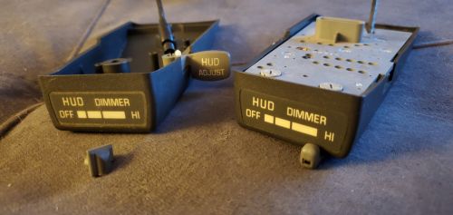

1. In addition to the obvious parts, such as the dash pad, HUD itself, and HUD switch, you will need to remove a bracket that the HUD sits on.  Be careful with the lever on the side of the HUD adjustment switch...those snap off easily because the adjustment cables tend to bind as they age.  Also, you'll have to swap the trapezoid-shaped cluster trim for the HUD switch because it has a hole cut in the underside of it.

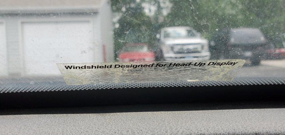

2. HUD-equipped cars had windshields that were "HUD suitable."  Since windshields are actually two layers of glass with a laminate layer in between, it is possible to have your HUD image "ghost."  HUD suitable windshields had minimal ghosting.  I'm sure you don't want to get involved with pulling windshields, so just give it a try after you install everything.  I retrofitted a HUD into my car and the HUD image is fine.
If the GTP interior is in good shape and you have the AQ9 fully articulable seats, I'd consider swapping them too.  The interior swap isn't hard, but it helps if you have a lot of space to work and you don't need the car for a couple days assuming you can work on it then.  Along those lines, the trip computer is easy to get out, and so is the harness for it once you get the carpet out.

I concur.  The HUD parts inside the adjuster are pretty easy to switch out if you happen to have spares.  I made a good one out of two bad ones.
