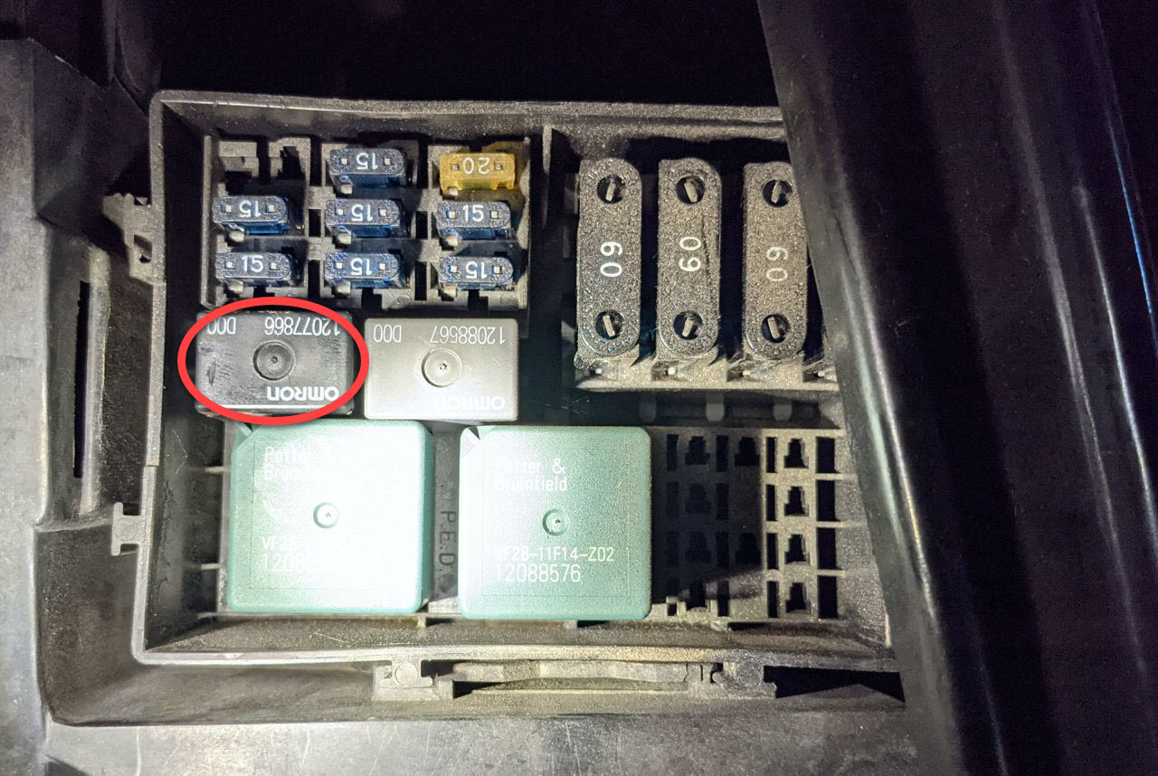

The car is a 1995 Cutlass Supreme with the 3.4 L DOHC engine. I want to measure my battery voltage while cranking the engine for about 10 to 15 seconds. I pulled the fuel pump relay (circled in the photo below), but the engine started and ran. What do I need to do get the engine to crank but not start?
Thanks for any ideas on this.

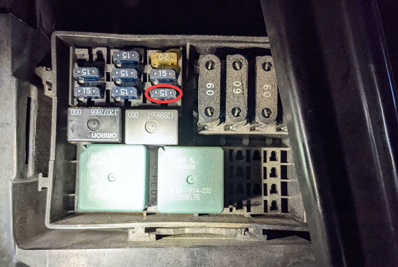

Pulled the Electronic Ignition Control Module fuse instead (circled below) and got the no-start condition I needed.
