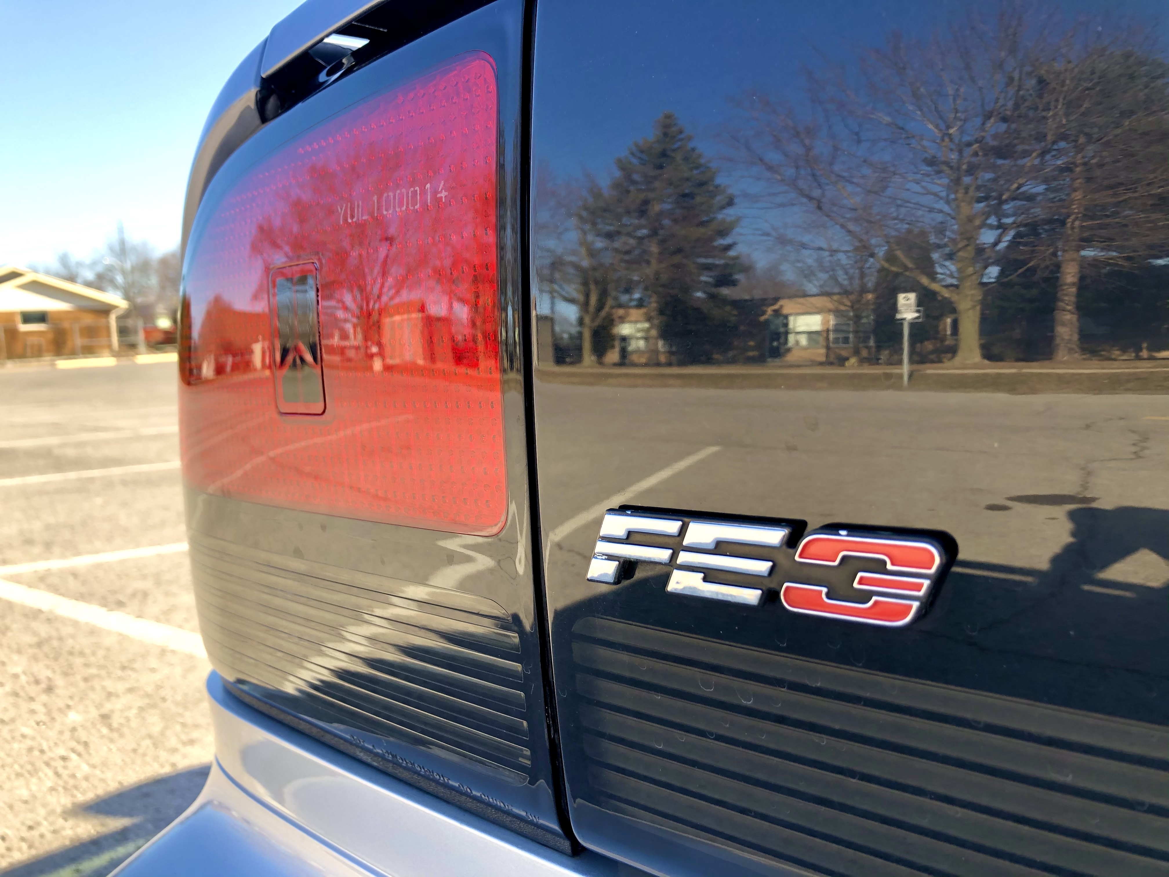

I have a '90 Cutlass Supreme SL Sedan with 18,000 original miles. Fully optioned out with the FE3 suspension. I am attempting to determine exactly what the FE3 suspensions consisted of on these cars. I see many different specs quoted online. I want to replace the rear struts because they are 31 years old. Any opinions or suggestions will really help. This car is new to me.
