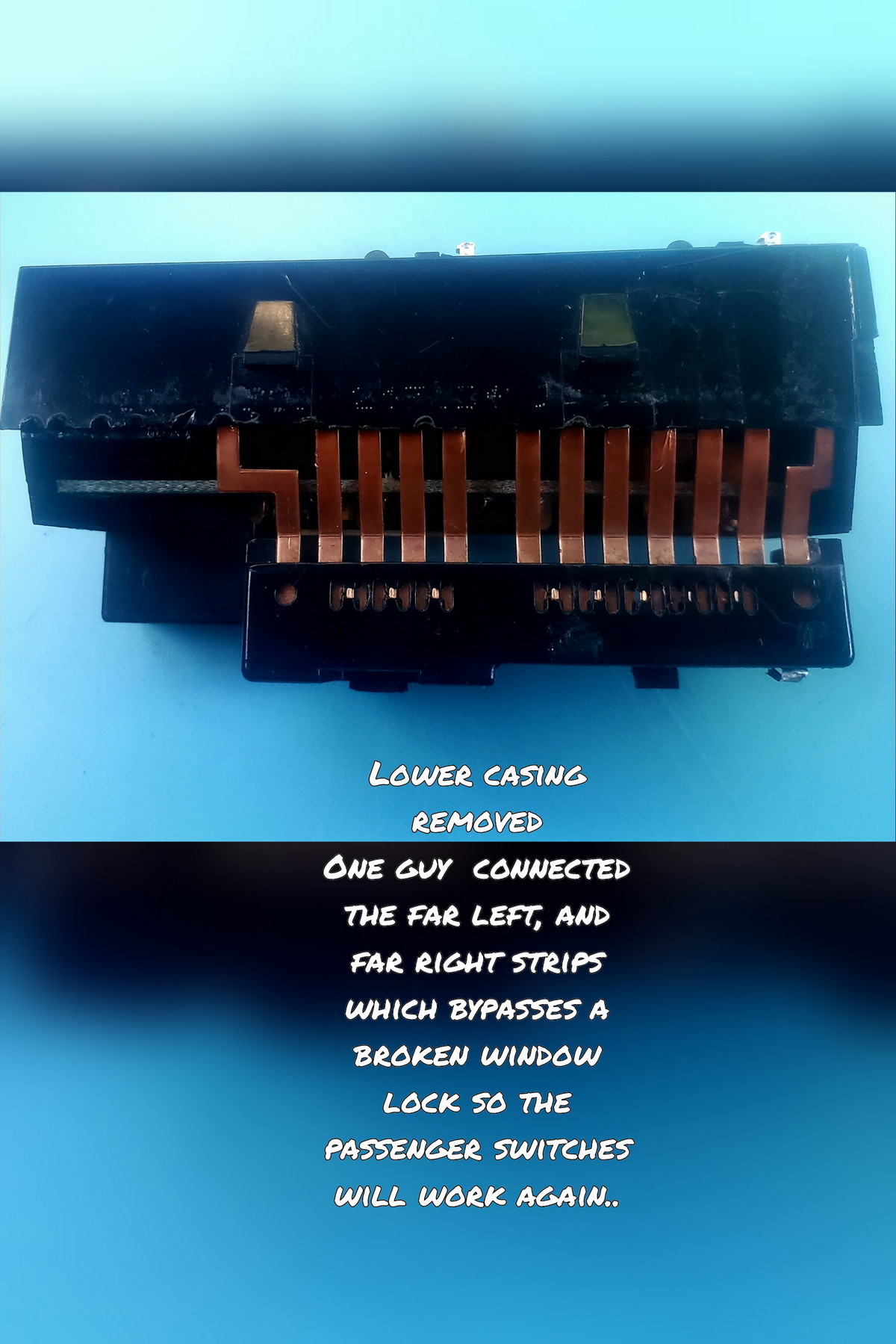

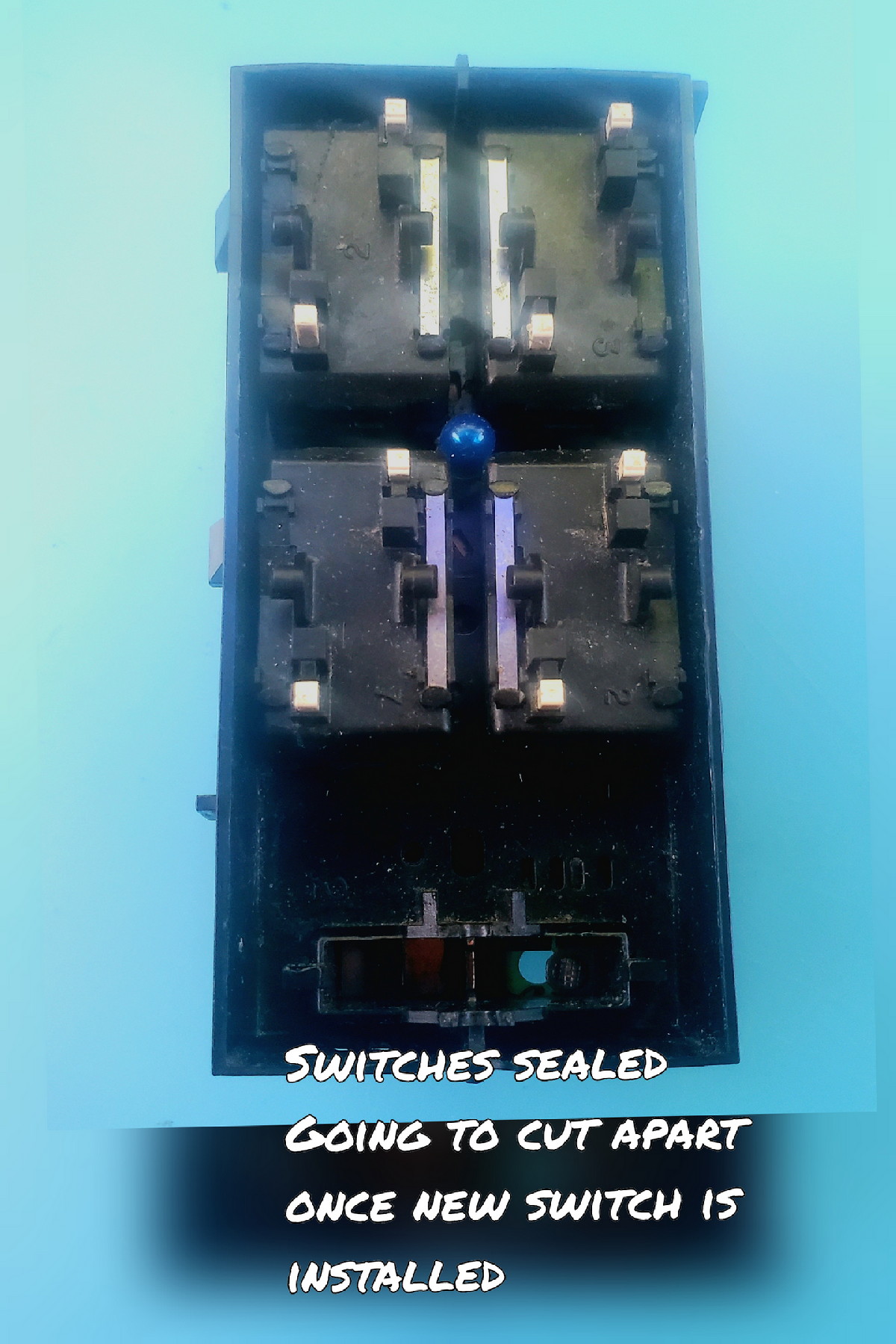

  I dismantled it, but once down to switch level, they seem sealed .. part of the black plastic.. no clear pieces that snap off.. the circuit board has tabs twisted through it, was thinking of attempting untwisting, and separating that...

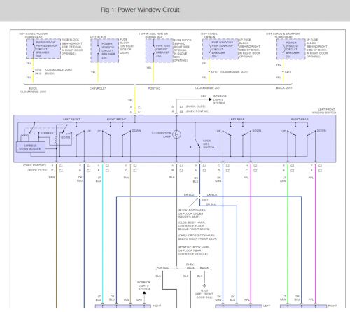

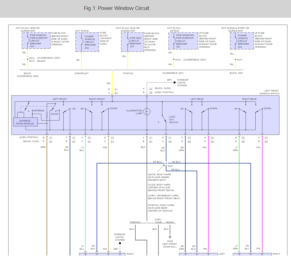

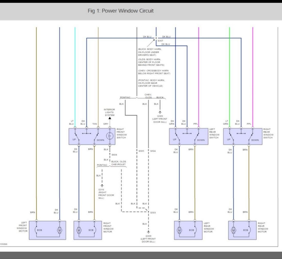

Took forever to locate a wiring schematic, found these, brown is down wire, blue is up, for drivers window..
First attempt to bypass was with switch connected, from the now exposed copper strips along the side that correspond to the adjacent wires in connector..  "DO NOT DO THIS"....  Buzz... Sizzling... POOF.. SMOKE.. 😬

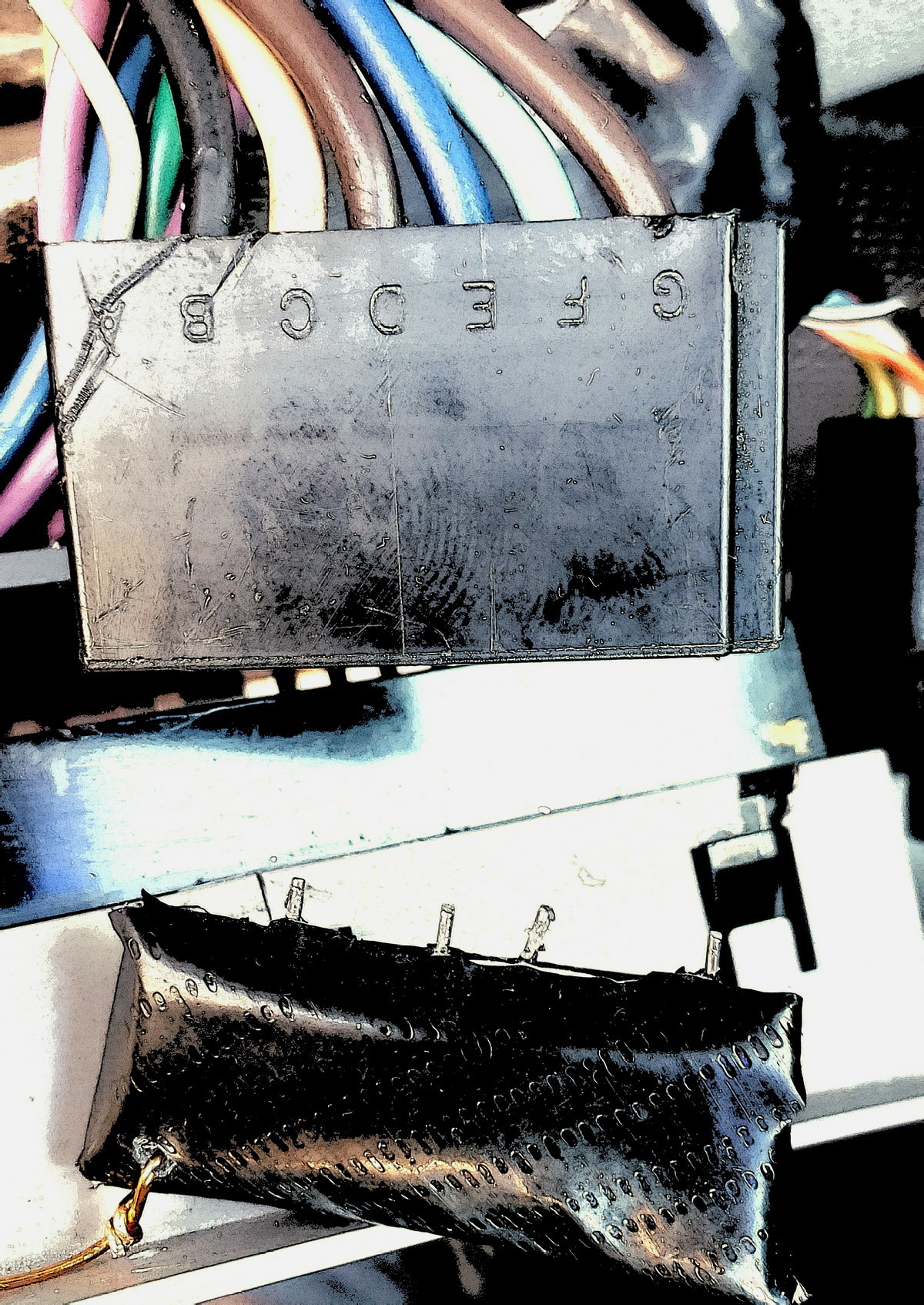

You must bypass from the "UNPLUGGED CONNECTOR" with key On, or car running...
Position "G"/ Brown is Power .. Position "B"/ Black is Ground..

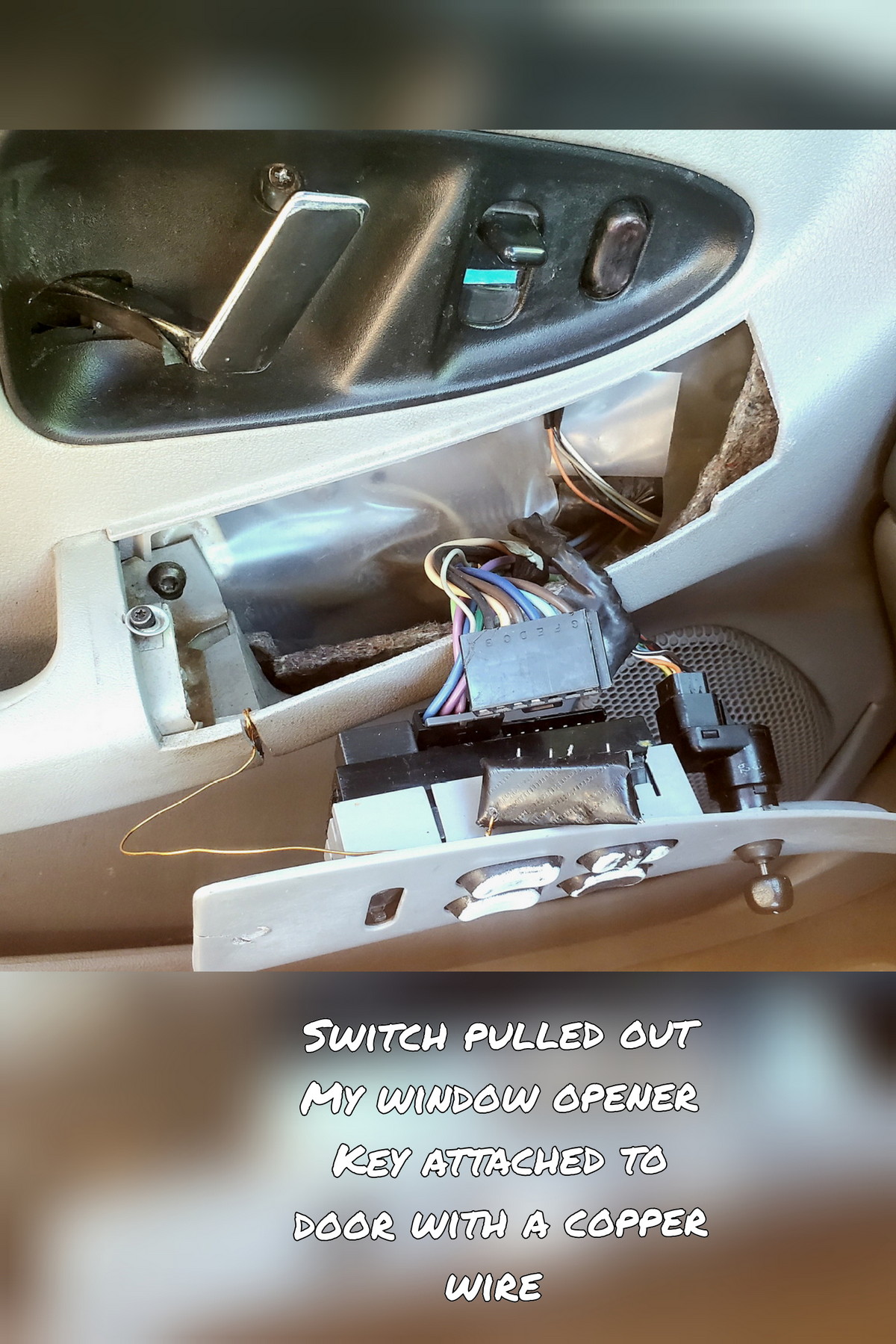

So, I fashioned a little "key" out of thin folded plastic from a notebook/binder, separating the 2 wires coming out the side at the appropriate connector points.... #1- Brown to Brown... #2- Black to Dark Blue..... SUPER EASY to roll window down.. Unplug switch, press key into connector.... window down...

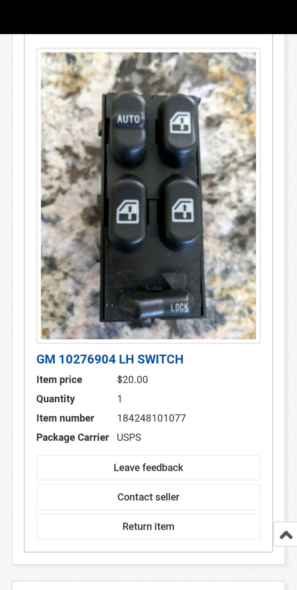

Just signed on to Rock Auto to get the CUTLASS ACI for $65..  Then suddenly thought I'd enter the original GM part number online...  And... O...M...G..... ebay ad pops up.. Estate sale..  No Car/ year description, just "GM part number LH SWITCH", and pictures.. A NOS GM switch, still in its box... FOR...  $20 "Buy It Now"....... CLICK... It arrives TOMORROW  !!!
