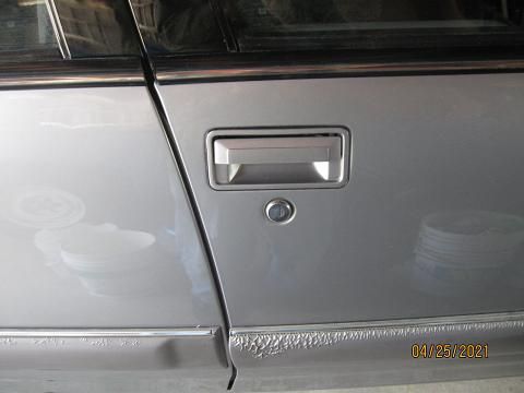

When you pull on the door handle the release lever lifts unlatching the door.

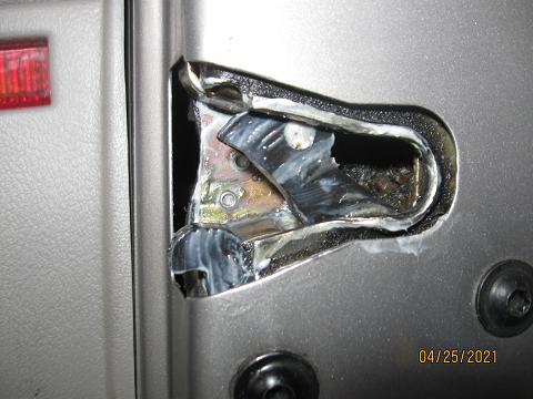

Picture of the latch unlatched and a picture of the latched locked.

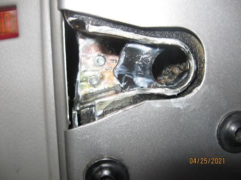

 Picture of the latch that the locking lever holds shut

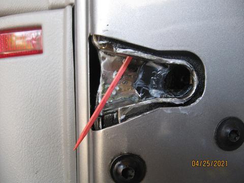

Picture with the red toothpick shows the lever that lifts up when you pull on the door handle. This was what was gummed up.

Another picture with the red toothpick showing where the lever is located.
