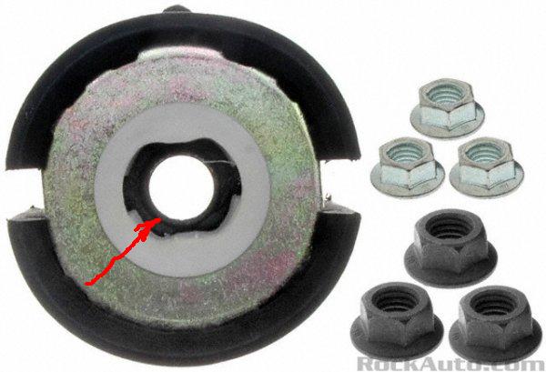

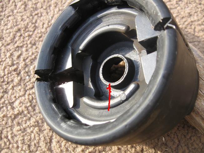

ron350 Posted March 3, 2021 Report Posted March 3, 2021 (edited) A short time after replacing my front struts and mounts car started having a clunk. I used Monroe struts and mounts and the struts came with washers that had to be installed between the top of the strut and the large hollow retaining nut. I thought that I might not of gotten the large nut tight enough with the half wore out tool from autozone. I found the same OEM strut kit #27034 on ebay a purchased it. When I took the struts back out the large hollow retainer nuts were slightly loose but the noise was coming from where the struts clamp to the strut mounts. The off brand mounts had an uneven surface where the top of the strut shaft is clamped to the strut mount. The uneven surface allowed the strut to flatten out the uneven parts that treated a gap that caused all of the noise. I removed the silver bottom plate from the rubber mounts and attacked the uneven black steel flange with a dremel a drill and grinding stones until I had a solid flat surface. Put it all back together and all the looseness and clunks went away. Arrow in picture shows where the surface needs to be flat and smooth. Edited March 3, 2021 by ron350 rich_e777 1 Quote
TheKidInBuff Posted March 4, 2021 Author Report Posted March 4, 2021 On 3/2/2021 at 7:57 PM, ron350 said: A short time after replacing my front struts and mounts car started having a clunk. I used Monroe struts and mounts and the struts came with washers that had to be installed between the top of the strut and the large hollow retaining nut. I thought that I might not of gotten the large nut tight enough with the half wore out tool from autozone. I found the same OEM strut kit #27034 on ebay a purchased it. When I took the struts back out the large hollow retainer nuts were slightly loose but the noise was coming from where the struts clamp to the strut mounts. The off brand mounts had an uneven surface where the top of the strut shaft is clamped to the strut mount. The uneven surface allowed the strut to flatten out the uneven parts that treated a gap that caused all of the noise. I removed the silver bottom plate from the rubber mounts and attacked the uneven black steel flange with a dremel a drill and grinding stones until I had a solid flat surface. Put it all back together and all the looseness and clunks went away. Arrow in picture shows where the surface needs to be flat and smooth. This is extremely usefull... thank you. I'll keep it in mind when replacing mine. When I did the struts, i didn't do the top mounts. But I do remember the new struts coming with washers. I had trouble getting the strut housing tight so the struts didnt move. Quote
