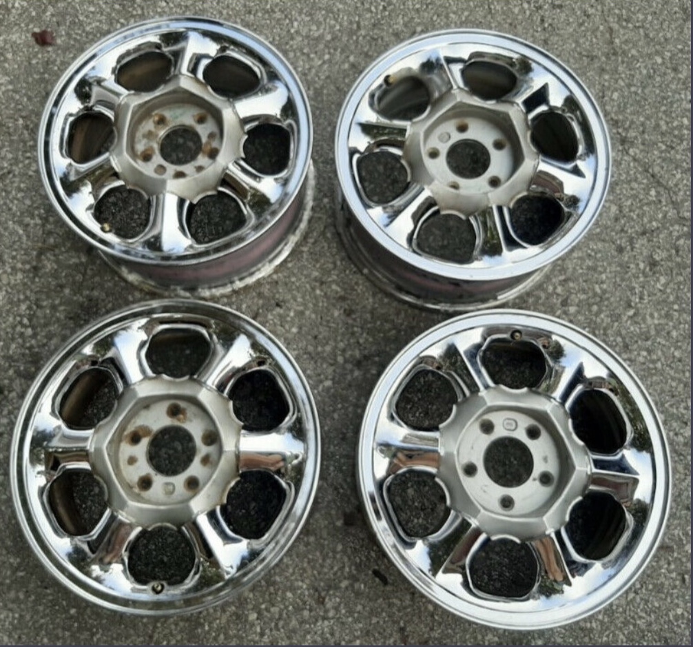

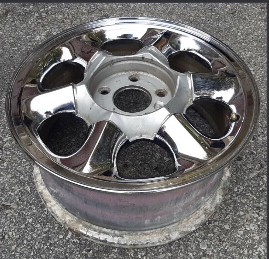

I have a set of 4 16x7j chrome rims from a 96 Aurora in good condition. Has anyone ever successfully fit them on mid 90’s Cutlass Supreme?
The wheels came off an Aurora (G platform) the wheels might have the same bolt circle as the W platform (but they could be either 115 or 118mm bolt circle) but will have the G & H platform design for brake hardware clearance. They will not clear the calipers on the 1st gen/1.5 gen W cars, they should clear the calipers on the later 2nd gen W cars as those vehicles adopted the H platform brakes/wheels.
I'll second what Steve said.  Physically they will bolt right up, will the brake caliper hit? maybe? probably? not sure.
1G seem to have a weird offset that makes most wheels look sucked in more then they should.
Should you go the route of spacers assuming they don't make it look ridiculous they should work.
Test fitting would probably be your best course of action.
