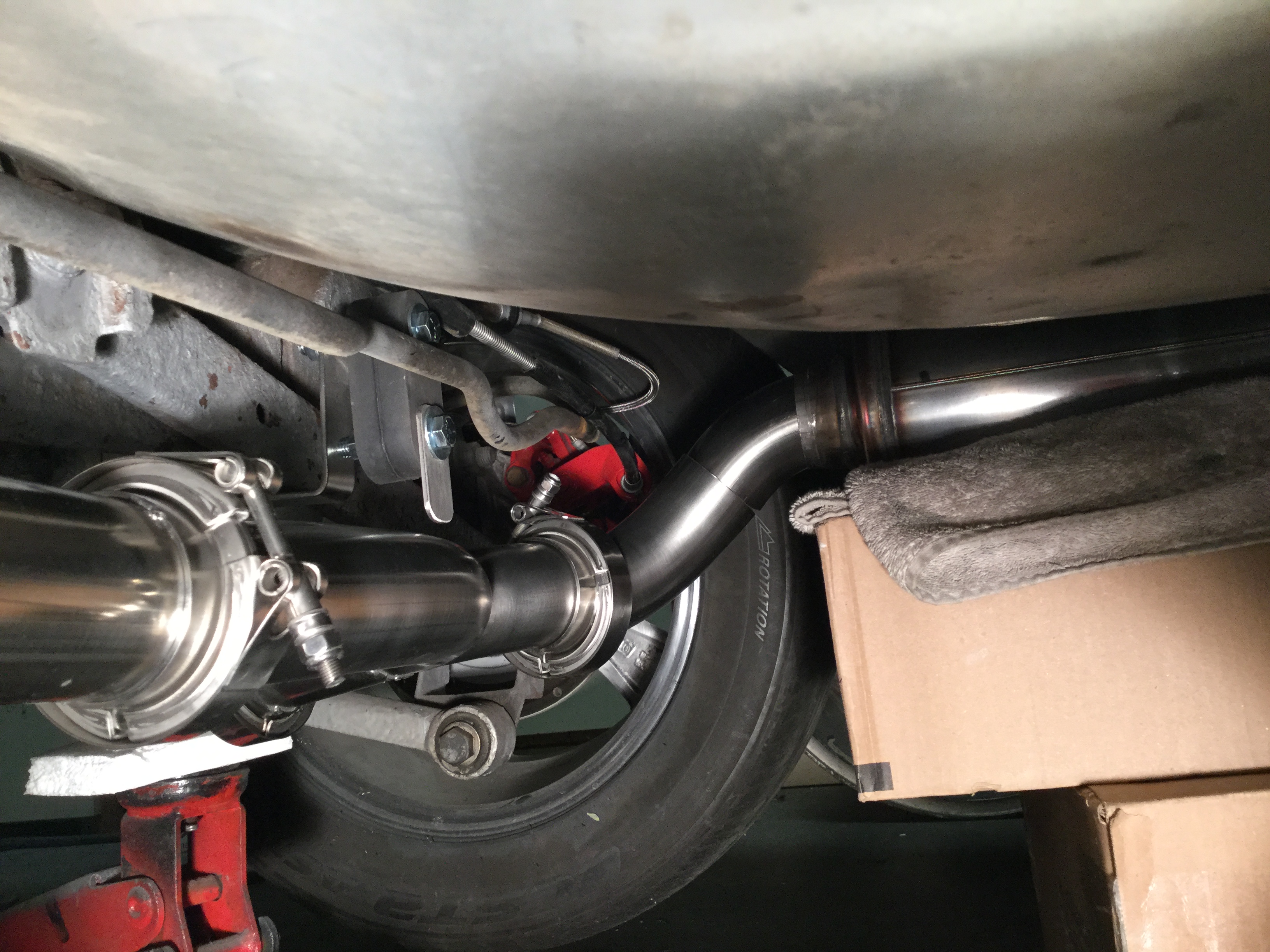

GTP091 Posted January 28, 2021 Author Report Posted January 28, 2021 (edited) Had to build a y pipe so that set me back a day or two. Original magnaflow Y’ was to long and I coudnt make the turns into the mufflers with it. Also realized it was a merge pipe and would have been bad for flow. Still need to finish the tack and size the last two bends. Good progress though. Pipe in the right is almost at the height I want. Another 1/2” up and should be good. Edited January 28, 2021 by GTP091 Regal 1 Quote

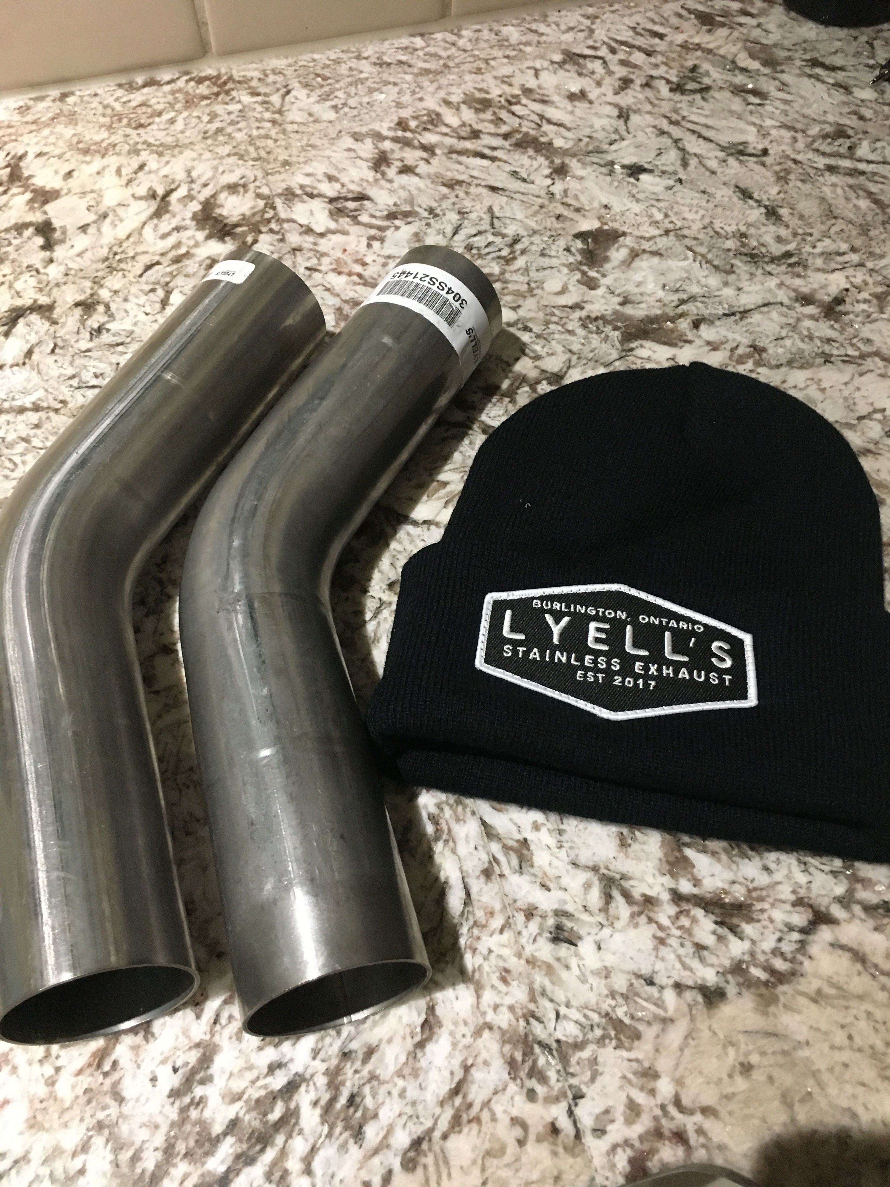

GTP091 Posted February 11, 2021 Author Report Posted February 11, 2021 (edited) Well shit never goes to plan wrenchin on cars. I found the pipe ordered didn’t have quite enough bends to get the mufflers tucked up like I wanted them. Ordered two more 45s to lift the inward side of the mufflers up another two inches. They sent two 2.5s instead of the 2.25 I needed. A few more days and they should be here. I guess that I get to keep the incorrect tubes though, my f150 is getting worried now. Edited February 12, 2021 by GTP091 Quote

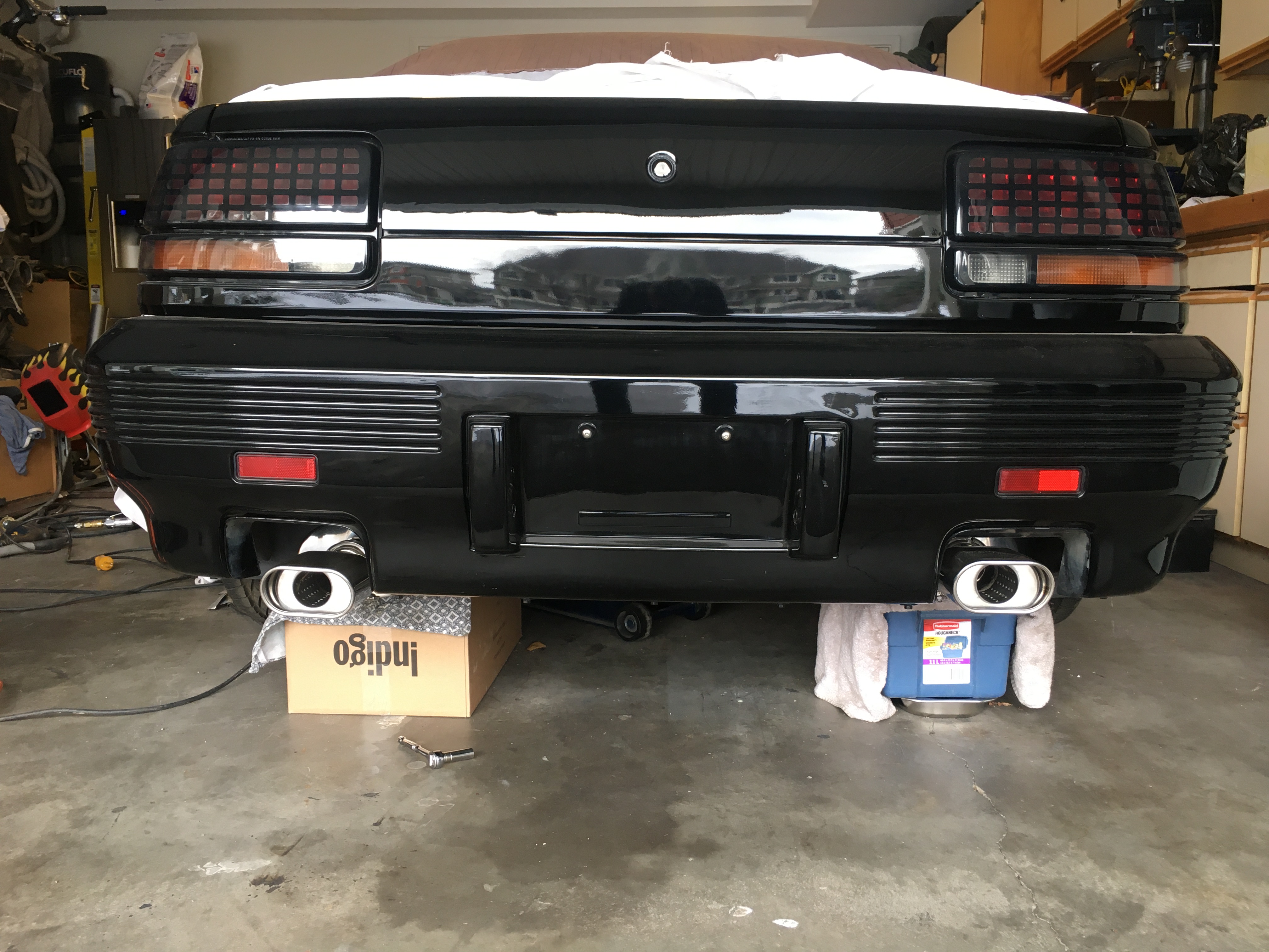

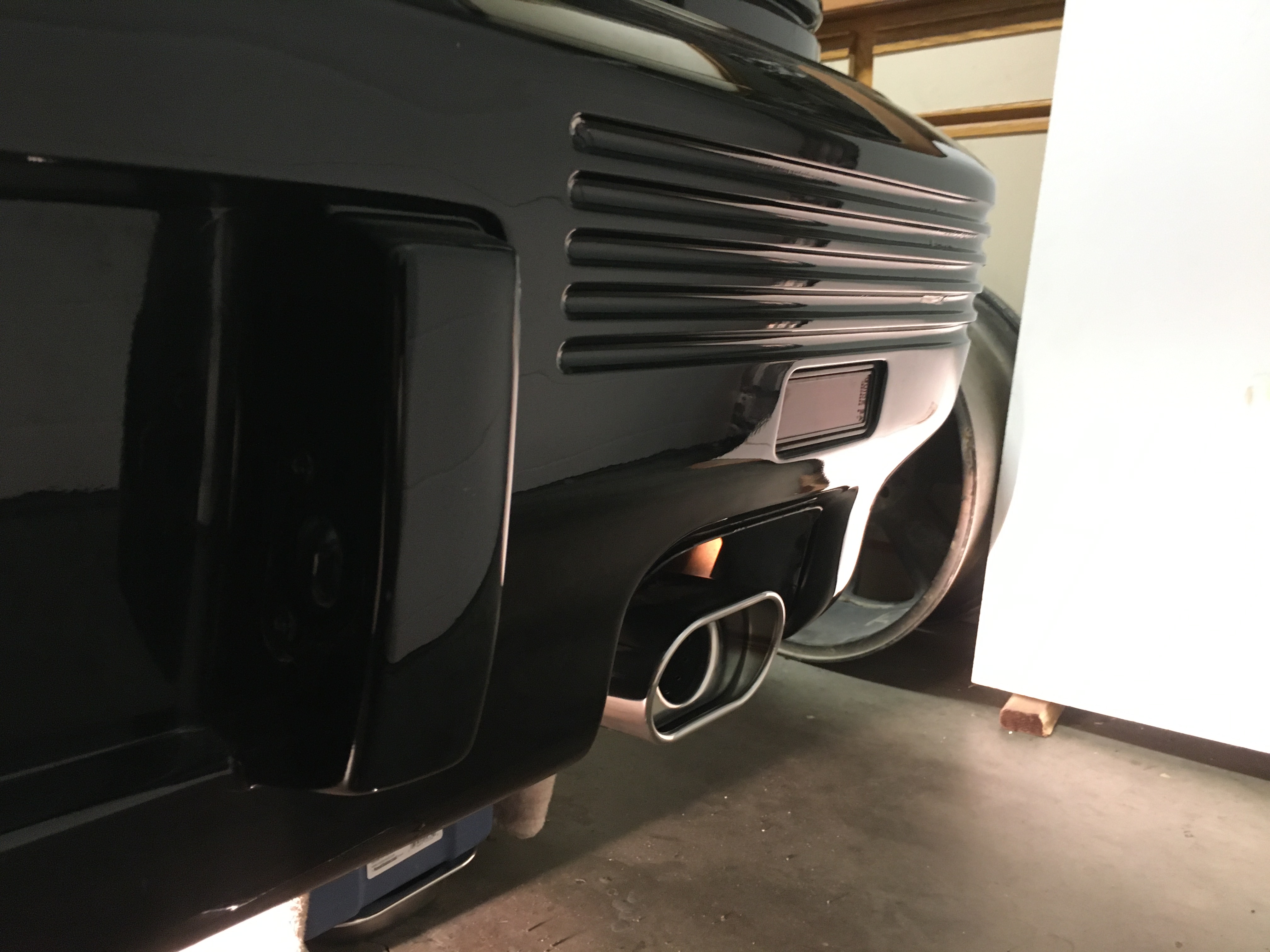

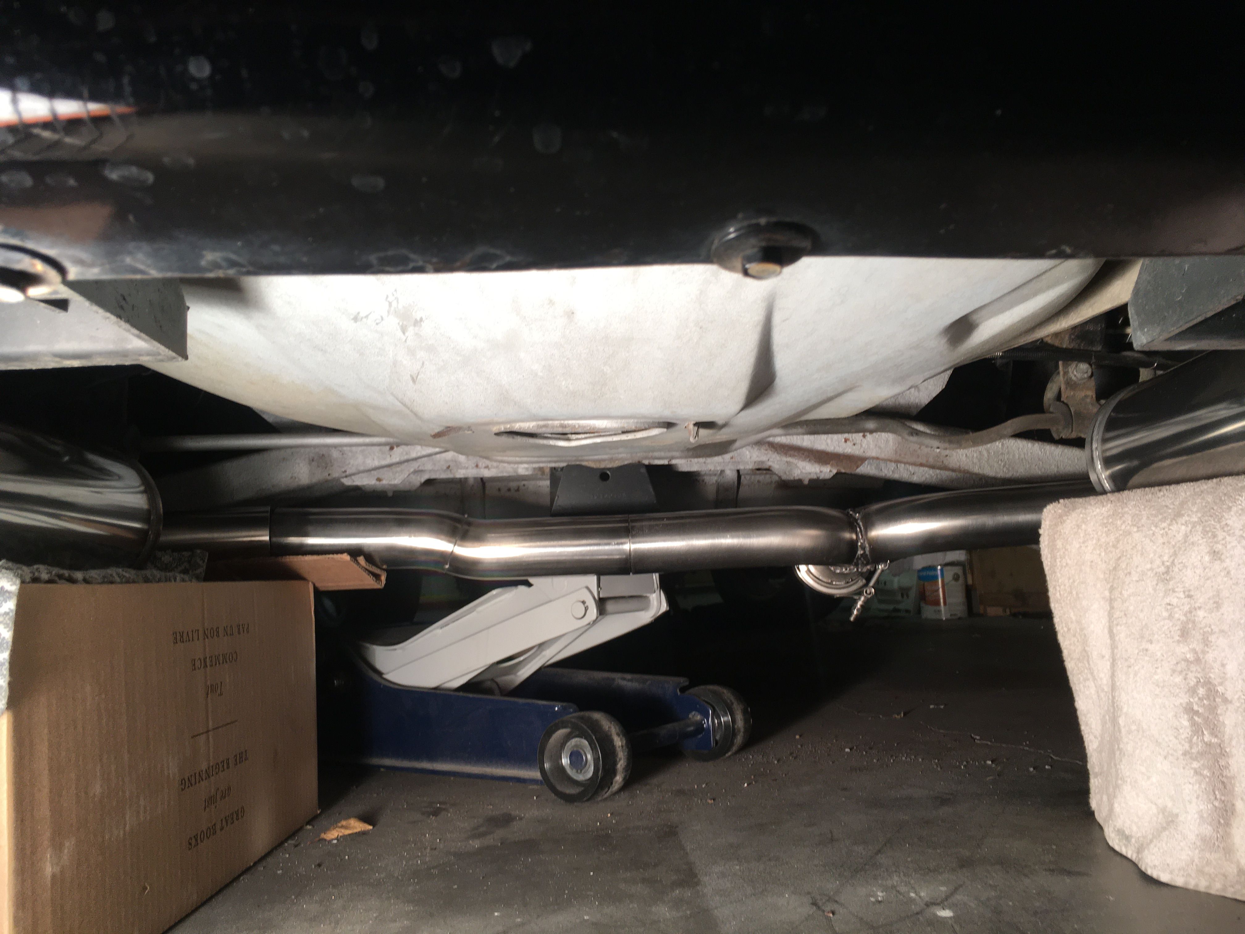

55trucker Posted February 11, 2021 Report Posted February 11, 2021 ^Well I was going to suggest to you that before you begin to assemble the rear section to hang in place everything up to the Y split & finish that portion off so it is placed at the height it needs to be & then begin cutting & assembling the back end, but you had already tacked the back end together in the pics you provided. In those pics the system seemed to be hanging on the low side. Is everything still just tacked together? Quote
GTP091 Posted February 11, 2021 Author Report Posted February 11, 2021 Nothing is tacked together yet in the back. The mufflers were just mocked up in the pictures so how I realized I needed more pipe to raise the mufflers a bit more. The y pipe is higher up than stock by just under 2 inches. Quote
55trucker Posted February 11, 2021 Report Posted February 11, 2021 I'm just guessing that because the tips are straight you have to keep the muffler down lower to align the outlet of each muffler to the inlet of each tip so the tips both clear the rear bumper cover cutout. I don't have that issue at all, when I did mine the mufflers are tucked up close to the floorpan & I made use of a pair of * S bends* to drop the pipe height and align the tips which hang lower than the mufflers do. Quote

GTP091 Posted February 12, 2021 Author Report Posted February 12, 2021 The correct pipes came today so I can get back at it now. They sent a free toque! Quote
55trucker Posted February 12, 2021 Report Posted February 12, 2021 Now isn't THAT a coincidence, Lyell's is where I go to to get all of my tubing! The only difference is I can drive to Burlington to get it. Quote
GTP091 Posted February 21, 2021 Author Report Posted February 21, 2021 Got the left test fit on nicely. It’s all tucked up where I want it. SuperBuick and pwmin 2 Quote
