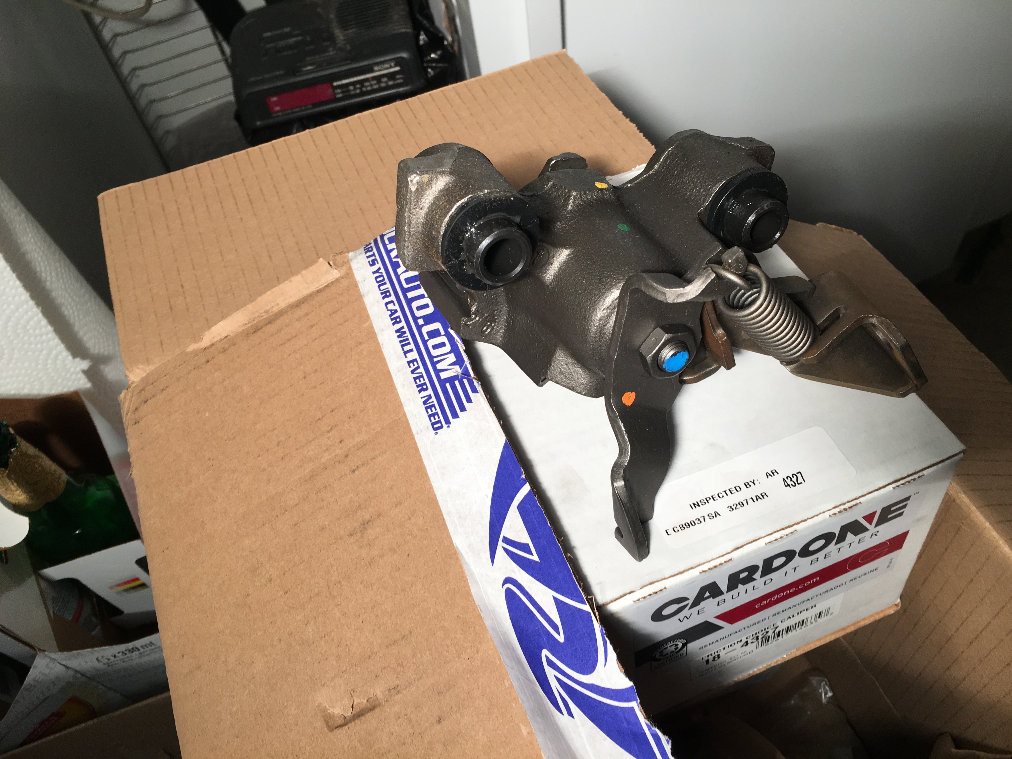

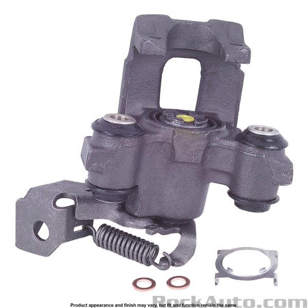

55trucker Posted December 15, 2020 Report Posted December 15, 2020 (edited) What you selected were Cardone items & they were pictured exactly like this?... but the slider pins & boots do NOT match what you selected from the display? Fill out the return, when you get to the procedure where they ask why the items are incorrect you fill out that what you received doesn't match the suppliers description of said item. As far as I know all of what Rockauto supplies (from whomever) is an OEM rebuild and there shouldn't be this sort of adjustment in the rebuilt parts used regardless if the supplier is AC delco, Nugeon, Raybestos, Centric or Cardone, but don't blame Rockauto themselves. Edited December 15, 2020 by 55trucker Quote

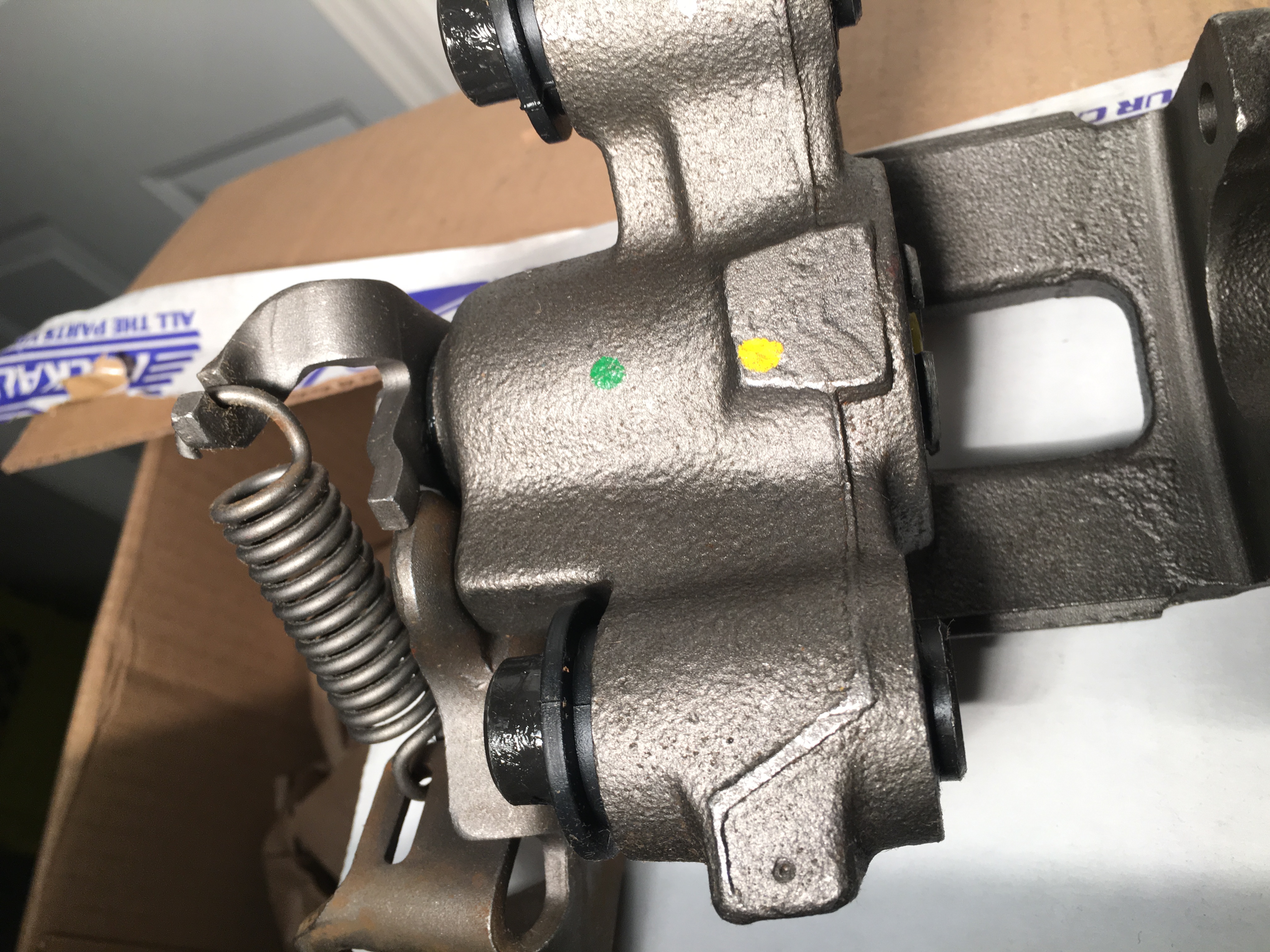

Regal Posted December 15, 2020 Author Report Posted December 15, 2020 (edited) See for yourself. Slide pins greased yet immovable. This was one of the reasons I was replacing the old calipers in the first place!? I'm not sure what other part you referenced nor whether it's there or not. These are going on the car and complaints will be made to Cardone in the morning. I just cannot deal with RockAuto and their return policy right now. Could not even go on with this charade even another week and there's about zero chance of any more parts arriving before the holidays. This is my only car. Edited December 15, 2020 by Regal Quote

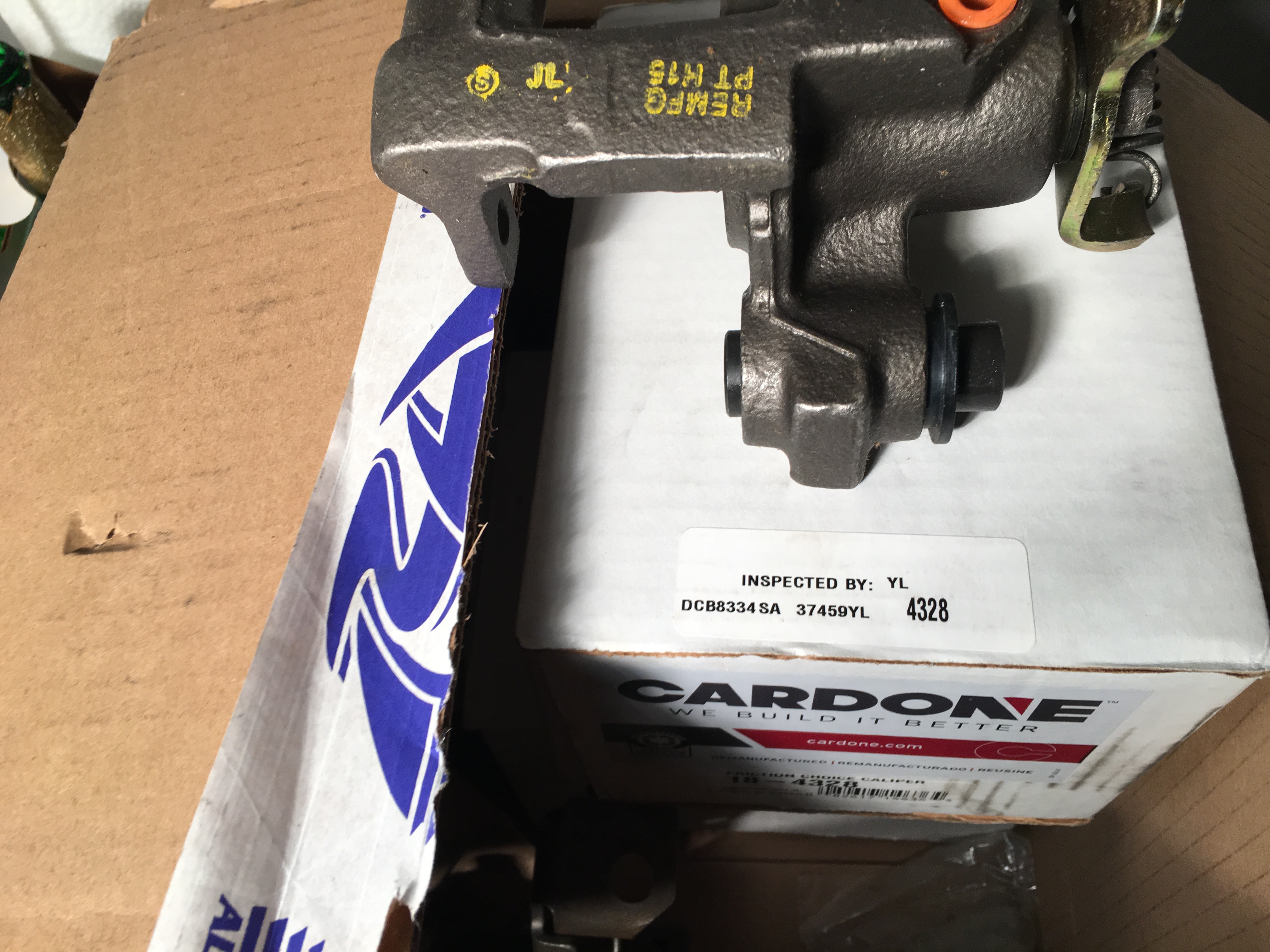

55trucker Posted December 15, 2020 Report Posted December 15, 2020 (edited) You understand that Rockauto themselves are not to blame for this, when one selects a product from their catalog the item is shipped from the suppliers warehouse, not Rockauto. Cardone would be on the hook for this, I see what you're referring to, I've never come across that particular slider pin design at all, as for the part I was referring to...regular rebuilt product for all 88-93 rear calipers. Cardone # is 184327 RR, 184328 is the LR Raybestos # FRC5293 RR, FRC5294 LR off topic....where are you located? *being out-of-country* Edited December 15, 2020 by 55trucker Quote
Regal Posted December 15, 2020 Author Report Posted December 15, 2020 Am not sure with Rockauto as several unrelated items I made on that order came from the same warehouse. When I've ordered elsewhere (like JC Whitney) the items did come directly from the manufacturers which was nice in a way as I was able to deal with them directly when an issue (also with Cardone, but they did make it right) arose. Any opinion on Raybestos rebuilds? I don't buy their pads nor rotors anymore, instead opting for domestically manufactured if I can. I know this design will work but won't have the longevity of the factory setup and may be noisy. What I don't get is that one side of the previous ones was proper and one wasn't despite both being Cardone rebuilds. Quote
