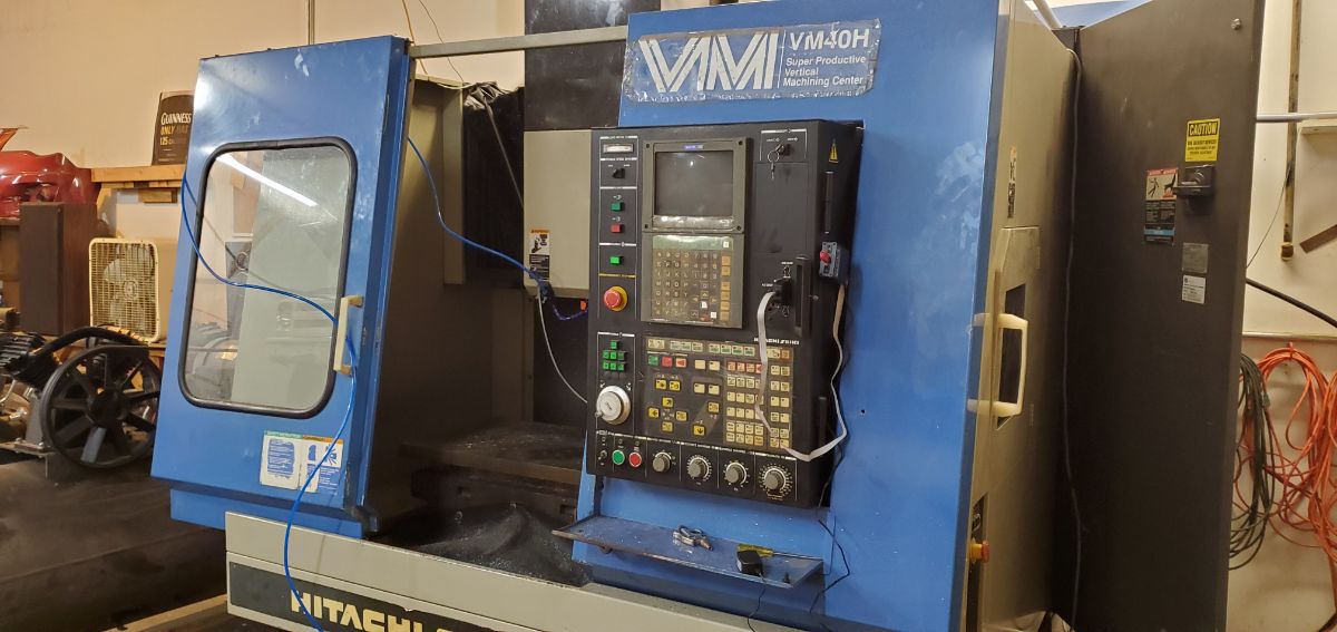

A friend at work is wanting to make some money on the side since he just bought a CNC machine.  He unfortunately sold his lathe and he won't be able to make axle shafts, etc but he might be able to make other components.  I am not educated in these 5 speed parts so that's why I'm reaching out to you guys for a list.  He also has a 3D printer and can make other parts as well but I really would like a list of manual trans specific parts that are unobtainable now.
Please be as specific as you can with any details or concerns, questions that you may have.  I will pass them on to him and see what he says.  Also, pictures would be helpful too.  Thanks guys!

there is the issue. there is no technical drawings for any of those, at least not locked away in a dusty filing cabinet at Getrag's HQ.
You'd basically have to take a worn one and its matching gears and first make a duplicate of it then build the friction surface back up till it does its job properly again. it would be a bunch of messing about to get it just right since short of taking apart a known good unit... of which I do have.
basically getting the proper metals and buying them in bulk is the easy part, being able to recreate it in G code that a CNC mill can use to program is the ultimate challenge.
