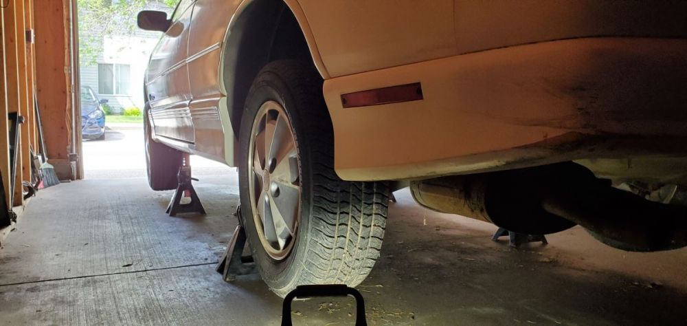

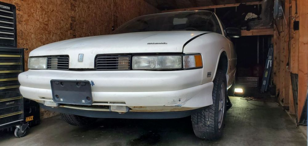

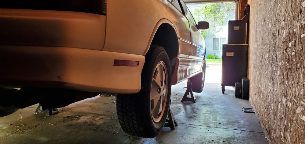

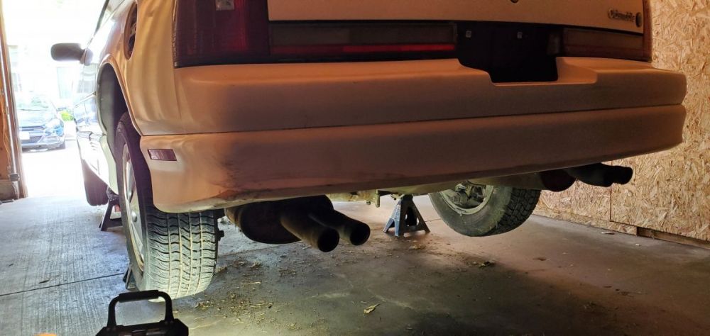

I never use the pinch welds as a lifting point but instead rely on the front subframe or the rear axle lift pad.  I also have these really nice jack stand cushions.  Very happy with how they provide some protection when supporting the International at the pinch weld points.
