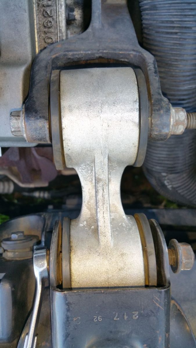

crazyd Posted November 24, 2020 Author Report Posted November 24, 2020 It's slightly offset; the brackets don't precisely align for some reason. You can see it, and how much play there is in the bushings after only a few thousand miles, in the below pic. Incidentally, I did use a jack handle to yank around the engine fore/aft while the dogbone was out, and it was moving maybe 1/2-3/4" (13mm-19mm). Snug. Quote
55trucker Posted November 25, 2020 Report Posted November 25, 2020 something you could try to *align* the engine side is.. to remove all of the paraphernalia 1st & then back out the engine lifting bolts & slip in some hardened washers in between the head & lift support to move it away from the head slightly to true up the alignment. Quote
Schurkey Posted November 26, 2020 Report Posted November 26, 2020 ...or find out why the engine isn't positioned properly. Failed mounts? Bent cradle? Bent body/rad support? Quote
crazyd Posted December 6, 2020 Author Report Posted December 6, 2020 I noticed it when I went to the 282 mount on the 284. There are no more new 284 mounts, so if that's the cause then spacing the dogbone bracket is really the only proper solution. Or get a dogbone with a lifetime warranty. Quote
