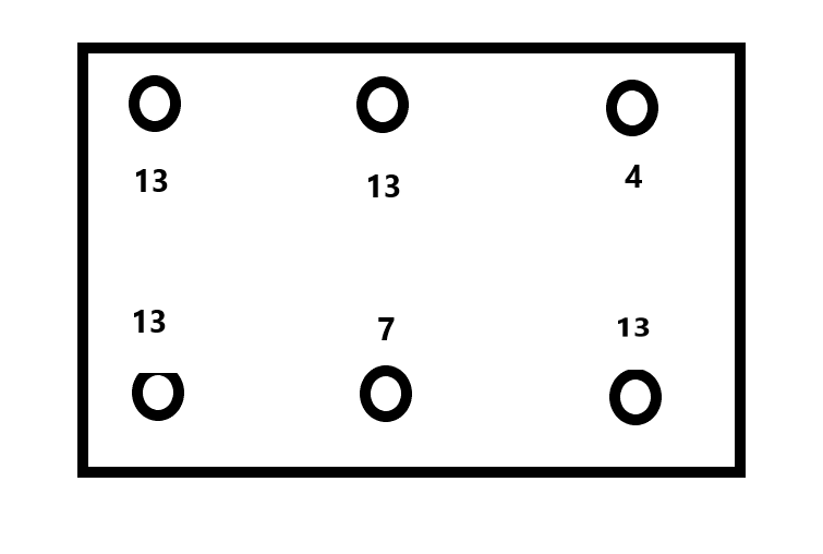

Sigurd Jarlson Posted October 3, 2020 Author Report Posted October 3, 2020 I broke down and pulled off the intake manifold. Not great not terrible, The hardest part was the damn clamps on the coolant lines to the throttle body. Here are my results. Numbers are in ohms, left is front of engine. So clearly I have two wonky ones. Would this completely explain the issue I'm having? Thanks. Quote

55trucker Posted October 3, 2020 Report Posted October 3, 2020 (edited) 1 hour ago, Sigurd Jarlson said: So clearly I have two wonky ones. Would this completely explain the issue I'm having? Thanks. The injectors are high impedance (12 ohms), #4 & #7 are not looking happy. What I'm seeing here would not shut them all down as a group. Edited October 3, 2020 by 55trucker Quote

Sigurd Jarlson Posted October 4, 2020 Author Report Posted October 4, 2020 46 minutes ago, 55trucker said: The injectors are high impedance (12 ohms), #4 & #7 are not looking happy. What I'm seeing here would not shut them all down as a group. I guess I'll change those two out, but it sucks that I have to button everything back up to see if any of my work has fixed the issue. Since I have access to the fuel pressure regulator, could that failing be the cause of the issue? As long as I have the IM off, I may as well change it. But I'd hate to do a bunch of work, button the IM back up and still have the problem. Quote

digitaloutsider Posted October 4, 2020 Report Posted October 4, 2020 IMHO, the 4 might be enough to bring down that entire bank. They don't need to be a dead short. In any rate, those both need to be replaced. Quote
mfewtrail Posted October 4, 2020 Report Posted October 4, 2020 (edited) Too late now, but you can ohm each bank of injectors without plenum removal(injector harness toward the computer). You won't get individual results that way, but can tell if something is wrong. Each bank is wired in parallel so you're looking at three injectors at a time if you ohm from that connector. Using your results of 13ohms and assuming all injectors should be 13ohms, you should see a reading of roughly 4.33ohms when ohm testing each bank. With one that's nearly shorted, your reading would drop(13 + 13 + 4 for example would roughly be 2.5 ohms) showing there is an issue before you remove the plenum. Either way in your case, the plenum would need to be removed because you definitely have two injectors that need replacing. edit: Just remembered this old video on the subject above. ScannerDanner on yt is an excellent resource for auto electrical diag if you've never came across him. The video shows the connector I mentioned above. Edited October 4, 2020 by mfewtrail Quote
