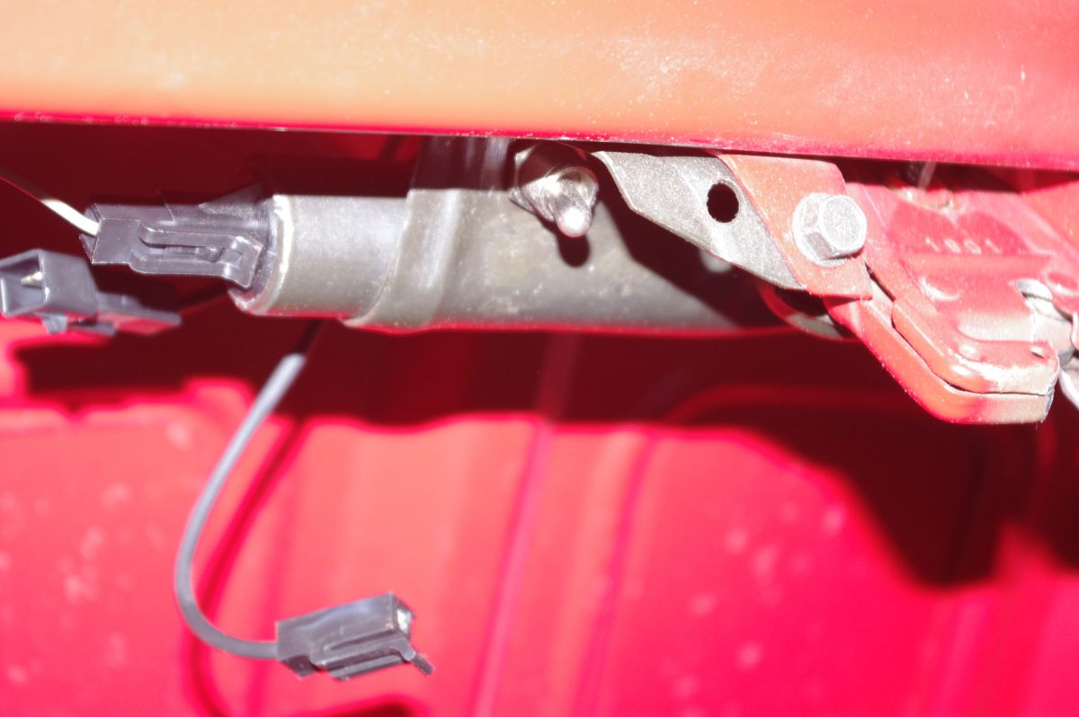

Human Posted September 19, 2020 Author Report Posted September 19, 2020 So I went to the junkyard today and got an actuator off of a 1996 Buick Century--same part with a different electrical connector and no hole for the lockout switch. Before taking things apart on the convertible, I decided to do a little experiment with my voltmeter and connected the red lead to the wire that goes to the actuator and grounded the black lead to the body of the actuator. I pressed the trunk button on the remote, heard that same faint click but registered no voltage. It would seem the problem is further up the line. Quote

ron350 Posted September 24, 2020 Report Posted September 24, 2020 A relay in the Remote Keyless Entry Module controls 12 volts to the trunk lid solenoid. Sounds like there is a flaky solder joint in that module. Bubinga 1 Quote
