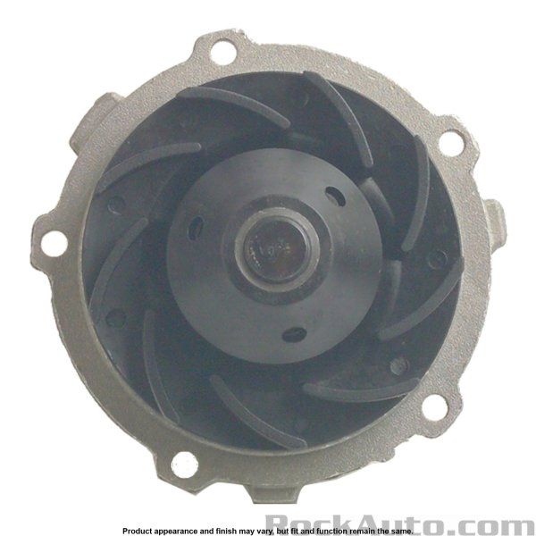

bluecalais79 Posted August 28, 2020 Report Posted August 28, 2020 Quick question on r + r of my water pump on my 1994 CS, the giant green manual advises I need to remove the coolant tank before removing the water pump. I took a look and I'm wondering, is that really necessary, there seems to be enough clearance to get at it, but I could be wrong. Thx, looks like the water pump is one of the few things on this motor which you can actually remove fairly easily. Quote
55trucker Posted August 28, 2020 Report Posted August 28, 2020 (edited) Yepper, pull the recovery tank, the pump (assuming it is the original) has a deep cone shaped cast impeller, when you're looking for a replacement Get the same, try not to fall into the *oh, the chinese aftermarket pump will do*, not so. Edited August 28, 2020 by 55trucker rich_e777 and digitaloutsider 1 1 Quote
digitaloutsider Posted August 28, 2020 Report Posted August 28, 2020 Unless you have some super dainty hands and arms, I don't know how you'd get to it without removing the overflow tank. Regardless, it's like 2 bolts and comes out in 30 seconds and would make the whole process infinitely easier. And I agree, find the one with the proper impeller. Quote
bluecalais79 Posted August 29, 2020 Author Report Posted August 29, 2020 Thanks, got it, I pulled the original overflow tank a few months ago to replace it with an NOS one. I was hoping to leave it but out it goes. As for the pump, I'm ready to go with a new A/C Delco pump (not a reman or junk chinese replacement). I'm the original owner of this car and I know it's the original pump, it was never replaced during the time my Dad or my brother owned it. The bearings are starting to sing (I recognize the sound from the w/p that croaked on my 3.1 last year) so it's time for it to go. I'm long overdue for posting some photos of these 2 cars on this site, I'll try and get to that over this weekend. Quite frankly my 1994 has come out so well I'm thinking about selling the white 1996. Time will tell. Quote
bluecalais79 Posted October 25, 2020 Author Report Posted October 25, 2020 Finally got the water pump in last weekend. Is there nothing on these 3.4 motors that's easy to install?!? The coolant tank was removed, that certainly was a must. But, man what a booger getting the old pump out, there's just no clearance to work anywhere. I got really lucky getting the (new GM) one in, you really need to set the gasket on the pump with sealer and hope it doesn't shift when you are jamming it through to get it to where it needs to go. Fortunately it set correctly and it wound up not leaking at the seal meaning I don't have to do the job all over again. The WP I took out was the original one (not bad, 26 years, 91,xxx miles), so I am going to send it out to Gould Rebuilders and have it rebuilt to have as a spare. Quote
