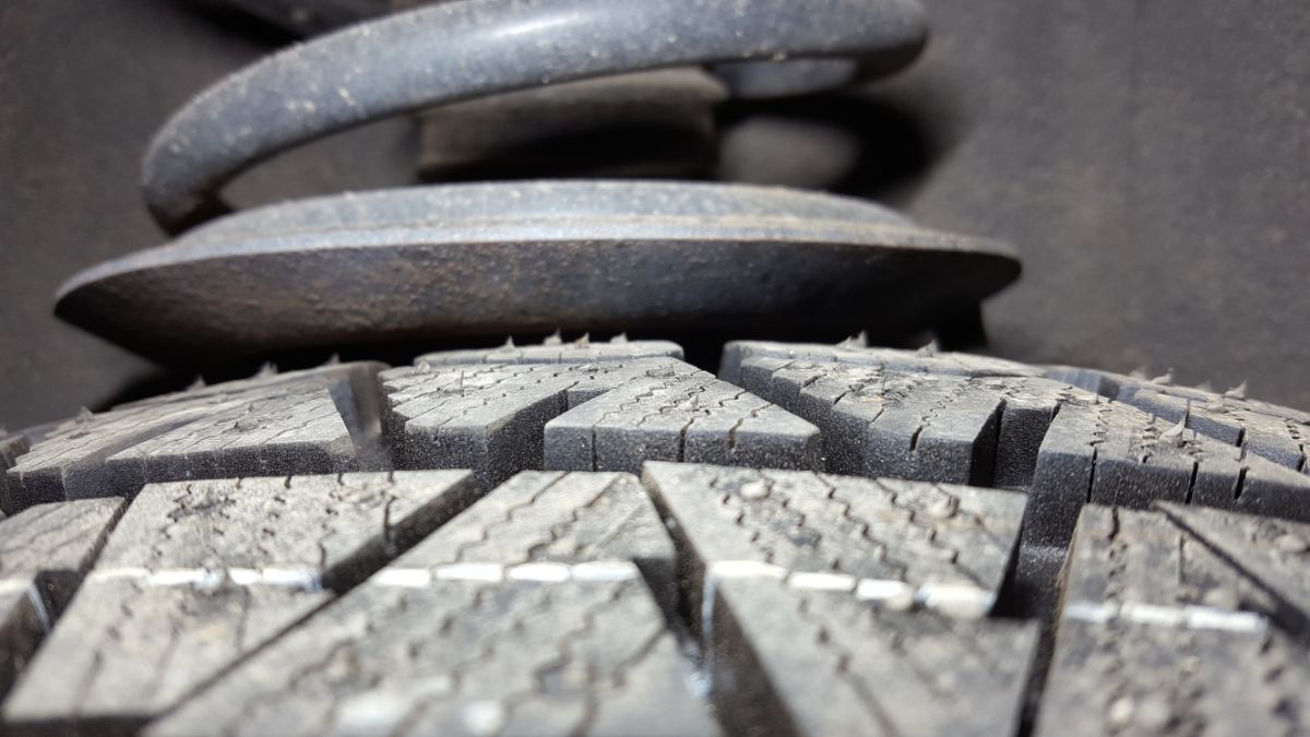

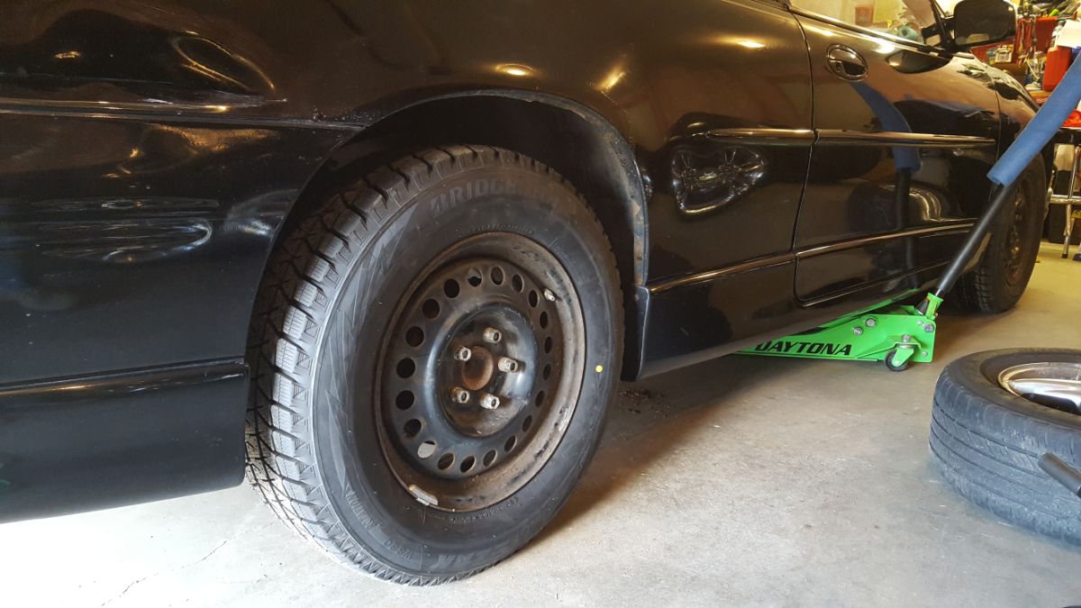

carkhz316 Posted August 25, 2020 Report Posted August 25, 2020 Just like the title says, I'm wondering if the above size will fit without spacers on stock polished 5 spokes or steels? I have tried searching to no avail. The 225/60 indicates to be a 26.7 inch tire diameter, vs 27.6 on the '65 series tire. I have stuck my fingers in between the strut and the tire and there is about 5/8 inch gap on the front, but less than half at the back. I do have spacers I can use, but figured I ask here. Quote

oldmangrimes Posted August 26, 2020 Report Posted August 26, 2020 Will the taller/wider tire hit the front wheel well liner on sharp turns, or the fender lip? Turning in and out of a driveway or parking lot is where you'll often reach the limits of the suspension. To test, maybe turn the wheels to full lock, sit on the fender above the wheel and bounce up and down and see how close the gap is to the tire. Also, by putting on a 1" taller tire, you're putting a 1/2" lift on a Grand Prix, it will affect handling. It'll look a little funny, too, but you may not care about that. I totally understand about the frugal part of your decision. I've put larger diameter tires on two of my SUVs because better tires were far cheaper at the larger size, and driven 100k+ miles with larger tires with no problem. But SUVs have more clearance in the wheel well than a passenger car. If you've got a fixed amount of money to spend, and your choices come down to iffy tires in the 225/60 size and nice new tires in the 225/65 size, the handling compromises may be offset by the improved traction and braking of the better tire. But you could also put on 215/60 tires, they are closer in size to the 225/60, and slightly smaller so they'll fit fine, they may be cheaper too. It's a risk analysis, and only you can weigh the risks. The rest of the world votes for you to put the safest tire on your car, to avoid getting into an accident with us. Keep shopping, get the best tire you can for your money. Tires are super super important. Quote

carkhz316 Posted August 27, 2020 Author Report Posted August 27, 2020 (edited) Thanks for the replies guys. I have means by which to reflash tire size settings in the PC, so not too worried there. I'm not a spirited driver either, and with winter coming up (most of the reason I bought the car in the first place) I'm not going anywhere quickly anyway. The tires I'm looking at are brand new tires on Tire Rack, so in case anyone was wondering that I was going to be putting some bald dry rotted things on it. I absolutely believe in tires being one of the most important things on a car, hence why I'm willing to spend $500 in tires on a $400 car (which is what I actually paid for it w/ 300k miles from original owner). Everything I've measured will clear, save for most likely the rear strut perch, but a .25" spacer will solve things it seems. Edited August 27, 2020 by carkhz316 Quote

carkhz316 Posted October 16, 2020 Author Report Posted October 16, 2020 For those wondering, they fit just fine. Fronts have plenty of room, about 1/2" and the rear has about 3/16". It's all moot because I acquired a different beater, 2006 Monte Carlo, and they're going to go on that and the GP is going away. 94 olds vert 1 Quote
