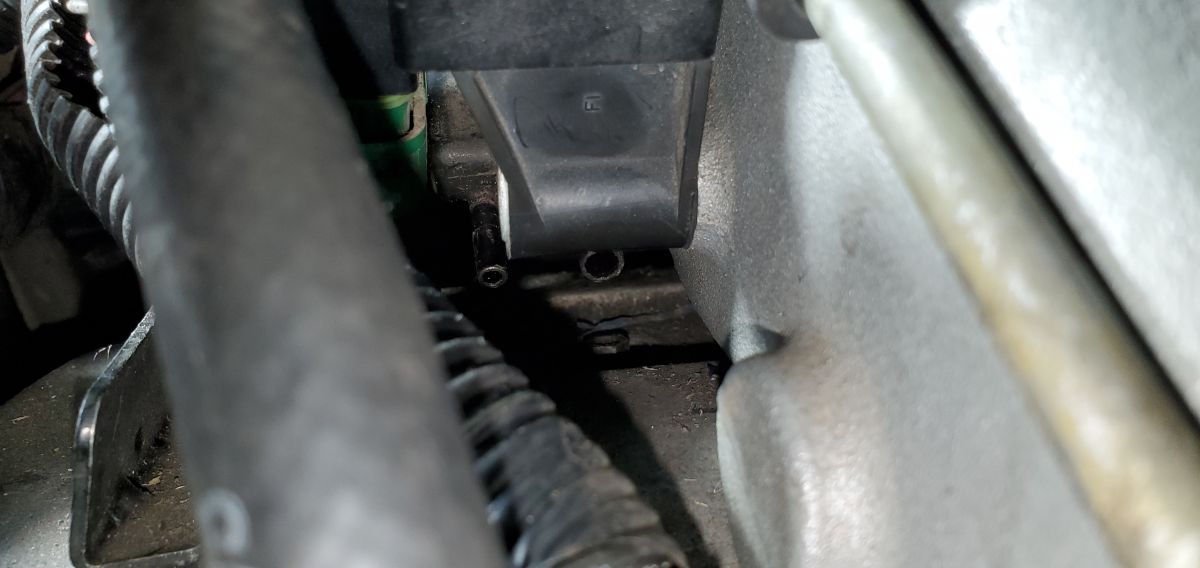

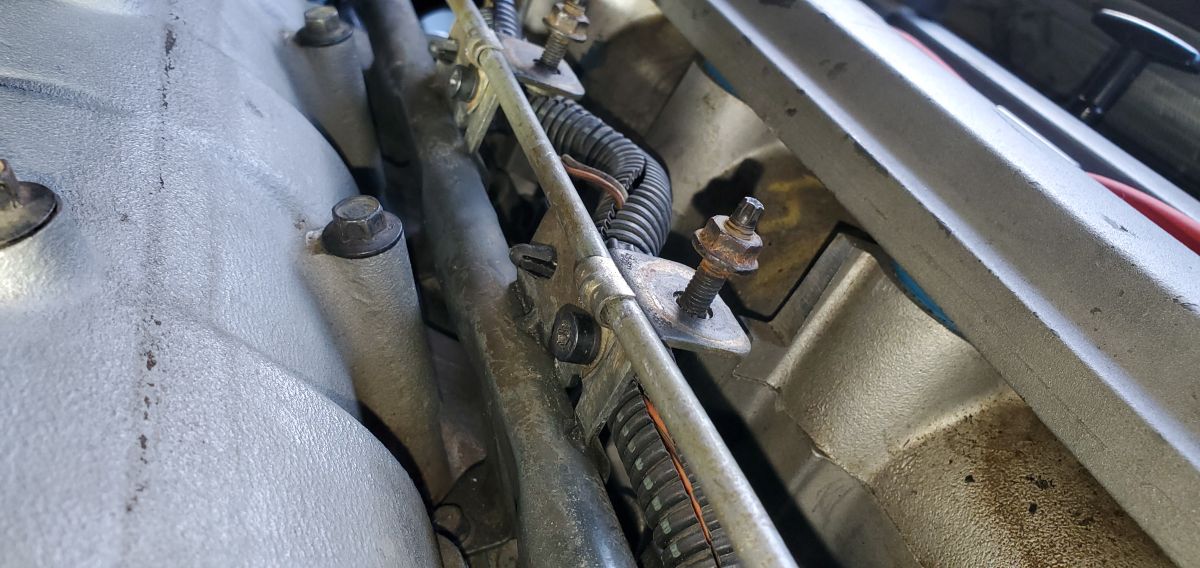

jiggity76 Posted August 16, 2020 Report Posted August 16, 2020 Ok, I don't know if it's called MAP or MAP sensor (I'm embarrassed to say that) for the 91-93 LQ1's. Does the metal tube going from the left side of the motor across the fuel rail where it locks into the two metal C clips and then over to the sensor? Here's a pic of my conundrum. The metal tube is mounted correctly but then it's sitting way to high, about 3-4 inches to where it connects into the MAP or MAP sensor. Quote
jiggity76 Posted August 16, 2020 Author Report Posted August 16, 2020 (edited) You know what, I bet I have those tube clips are upside down. I bet if I rotate them down, it will line up. I'm going to try that. Thanks Greg. You're welcome Greg. Edited August 16, 2020 by jiggity76 Quote

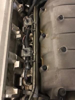

cessna Posted August 17, 2020 Report Posted August 17, 2020 Hey Jiggity yes flip it over bud it goes to the map sensor should look like this jiggity76 1 Quote
jiggity76 Posted August 18, 2020 Author Report Posted August 18, 2020 17 hours ago, cessna said: Hey Jiggity yes flip it over bud it goes to the map sensor should look like this Will do and thank you! Quote
