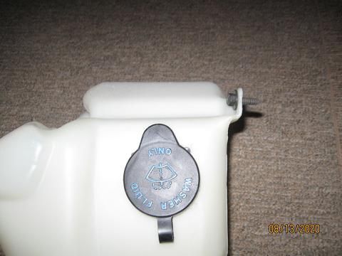

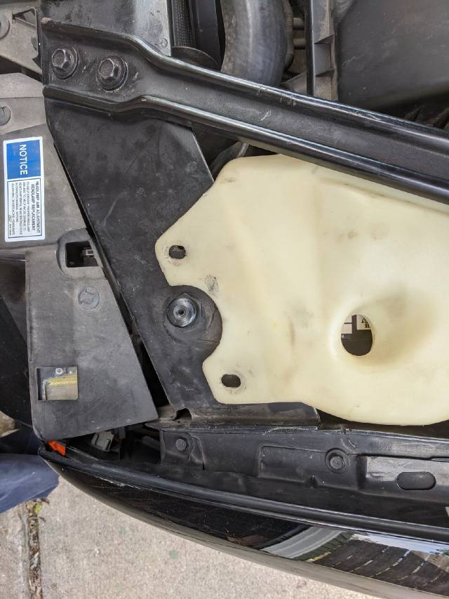

kcac Posted August 13, 2020 Report Posted August 13, 2020 (edited) What fastener is used for the two front fasteners on the washer fluid bottle? I have checked multiple U-Pick recycling yards multiple times, but because the yards remove the batteries when they get a vehicle, and the battery is under the washer bottle, the fasteners are pitched when the battery is removed. Just need to know what I am looking for. Edited August 14, 2020 by kcac Quote

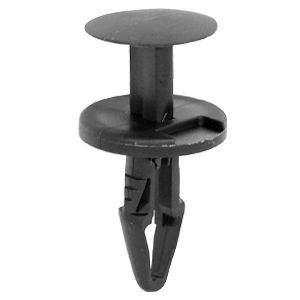

jiggity76 Posted August 13, 2020 Report Posted August 13, 2020 I don't know what they are called but they are a plastic push type retainer. I just found mine at my local GM dealer. Quote
55trucker Posted August 13, 2020 Report Posted August 13, 2020 (edited) It's not a bolt, it's a push pin/rivet Edited August 13, 2020 by 55trucker jiggity76 1 Quote
ron350 Posted August 14, 2020 Report Posted August 14, 2020 Don’t forget the sheet metal bolt in the back. Quote
kcac Posted August 14, 2020 Author Report Posted August 14, 2020 (edited) Thanks for the help everyone. I had removed and lost those two front fasteners many years ago. Shows how bad my memory is, I would have sworn I was missing two bolts. Went to the hardware store and got a couple of the push pins that jiggity76 an d55trucker mentioned. All set now. I did have the side bolt, maybe that is why I thought the other fasteners were bolts, too. Edited August 14, 2020 by kcac jiggity76 1 Quote

jiggity76 Posted August 14, 2020 Report Posted August 14, 2020 11 hours ago, kcac said: Thanks for the help everyone. I had removed and lost those two front fasteners many years ago. Shows how bad my memory is, I would have sworn I was missing two bolts. Went to the hardware store and got a couple of the push pins that jiggity76 an d55trucker mentioned. All set now. I did have the side bolt, maybe that is why I thought the other fasteners were bolts, too. No problem. I always use one hand to pull up the pin and my other hand to cover the pin so it hits my hand and doesn't fly off somewhere. That's how I lost them before I started doing this little trick. Quote
rich_e777 Posted August 15, 2020 Report Posted August 15, 2020 Upholstery clip removal tool is a must have for dealing with these things, I havent destroyed one with a flat head or needle nose pliers since picking a set up from HF a few years ago. Quote
