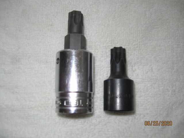

55trucker Posted June 25, 2020 Report Posted June 25, 2020 Also get yourself a good quality impact T-60, they will twist/break at high torque loads. Quote
ron350 Posted June 25, 2020 Report Posted June 25, 2020 (edited) After shattering a Lisle T-60 I was told I needed a Snap-on STX60. The STX60 is a snug fit for the job at three and one half inches long but I don’t have to worry about it breaking. This is a picture of a STX60 beside a Lisle T-60 socket. Edited June 25, 2020 by ron350 Quote
