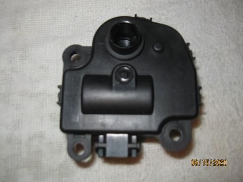

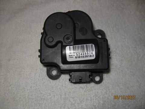

Anyone here familiar with these small HVAC blend door actuator.used in 2006 Impalas and Monte Carlo.
 I see that these were also used in 2004- 2008 Grand Prix's.
Delco 1574122 or GM 22754988 or 52409972 etc.
I see that there is now a replacement plastic gear sold on ebay for these little actuators and was wondering.

Turns out the reviews on the small gear replacement are all bad. Research says to replace the actuator with a new ACDelco and leave the aftermarket alone. Only time will tell.
