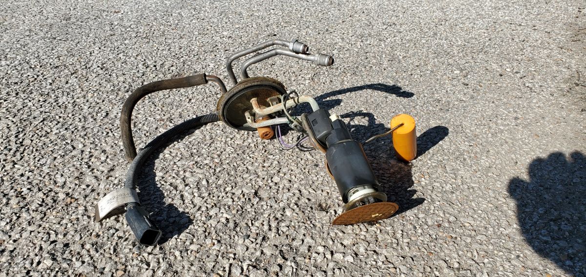

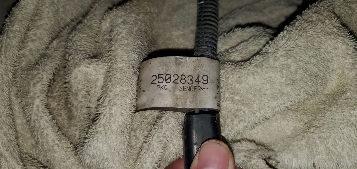

jiggity76 Posted May 28, 2020 Author Report Posted May 28, 2020 (edited) 19 minutes ago, digitaloutsider said: Yeah, that's it returning to the normal inertia lock mode. Maybe they just tapped into that circuit for the lock light, but that's what the click you're hearing is. Awesome! This has been bugging me for literally 5 years now! Hey, what's your take on fuel sending units? I've found some replacement NOS ones but are these obsolete now? Should I get a new design one with maybe better technology that may be more accurate? Here's my original one. I'm not sure if I should got an NOS one or a new gen one? Edited May 28, 2020 by jiggity76 Quote
digitaloutsider Posted May 28, 2020 Report Posted May 28, 2020 Is your sending unit bad or the pump itself? Quote
jiggity76 Posted May 28, 2020 Author Report Posted May 28, 2020 The digital dash is reading at a full tank when there is only 2-3 gallons. Pump is definitely bad but not sure about the sending unit. Quote
55trucker Posted May 28, 2020 Report Posted May 28, 2020 Greg, that much discrepancy in the gauge reading vs what's in the tank is more than just the float being a little out of calibration. When we were discussing this some time ago & I made an alteration to my float position it was only off by a little less than a quarter of a tank. That's not much movement on the float arm. I don't think that an NOS piece will cause you issues, it's a pretty simple device, if it's a domestic piece I'd lean to that before an asian offshore item. jiggity76 1 Quote
jiggity76 Posted May 28, 2020 Author Report Posted May 28, 2020 2 hours ago, 55trucker said: Greg, that much discrepancy in the gauge reading vs what's in the tank is more than just the float being a little out of calibration. When we were discussing this some time ago & I made an alteration to my float position it was only off by a little less than a quarter of a tank. That's not much movement on the float arm. I don't think that an NOS piece will cause you issues, it's a pretty simple device, if it's a domestic piece I'd lean to that before an asian offshore item. Thank you. Yes, I think an NOS one is the way to go. I've found a couple and ordered them already. I want one for the STE. If the STE or sedans have a different one and I can't use it, at least I'll have a spare for the International. Thanks for your help and you too Digital! Quote
55trucker Posted May 28, 2020 Report Posted May 28, 2020 To test the fuel gauge & sender................. jiggity76 1 Quote
jiggity76 Posted May 28, 2020 Author Report Posted May 28, 2020 (edited) 1 hour ago, 55trucker said: To test the fuel gauge & sender................. Oh my goodness. So something might be going on with the sender or harness then. I say this because both of my clusters are showing the tank being full. My original one and my spare one thats currently in the car. In other words, it can't be a bad cluster since both of them are saying the tank is full when it's not. Edited May 28, 2020 by jiggity76 Quote
