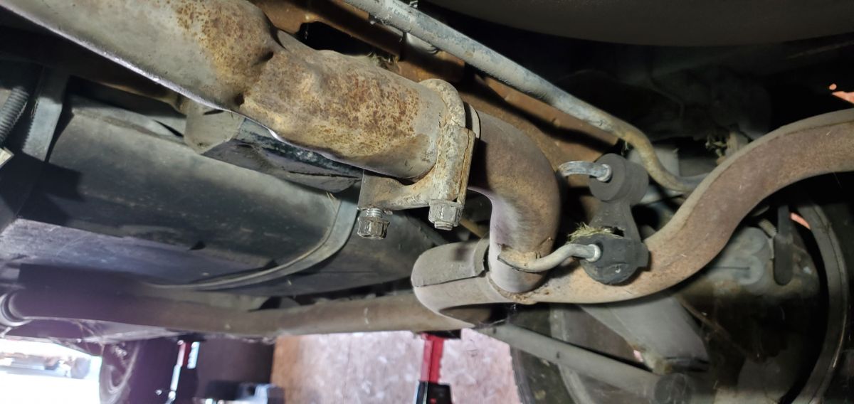

jiggity76 Posted May 24, 2020 Report Posted May 24, 2020 I think this is a clamp of some kind on my 91's LQ1 exhaust system. Is this factory or not? Do I need to get rid of it? I think I do but not sure. Any pics of your system would be great! Quote
digitaloutsider Posted May 24, 2020 Report Posted May 24, 2020 It's supposed to be all one piece. Some muffler shop must have put a new muffler or something on at some point. I wouldn't get rid of it because it's clearly been cut and it's just going to leak if you do. jiggity76 1 Quote
jiggity76 Posted May 24, 2020 Author Report Posted May 24, 2020 Thank you. I wonder if they could weld it and then I could get rid of the clamp? It still has GM mufflers on it if it's been replaced. Quote
digitaloutsider Posted May 24, 2020 Report Posted May 24, 2020 Yeah if you want to get it welded you can certainly get rid of the clamp. Is that some really early production 91 car? Maybe they did it that way for some of the first LQ1 cars. I know my '91 Cutlass was not like that and neither was my '92 Z34. jiggity76 1 Quote
jiggity76 Posted May 24, 2020 Author Report Posted May 24, 2020 36 minutes ago, digitaloutsider said: Yeah if you want to get it welded you can certainly get rid of the clamp. Is that some really early production 91 car? Maybe they did it that way for some of the first LQ1 cars. I know my '91 Cutlass was not like that and neither was my '92 Z34. Maybe. It was built in Feb of 91. Yeah, I really want that clamp off of there. It's actually loose and slides back and forth a little. One bolt is not tightened all the way. Quote
rockfangd Posted May 24, 2020 Report Posted May 24, 2020 You could replace the clamp, or if not a issue have it welded. If rust is a concern then I would be leery of welding it for later replacement. jiggity76 1 Quote
Schurkey Posted May 26, 2020 Report Posted May 26, 2020 If that were mine, I'd "tighten" the loose nut(s). Either they actually tighten, and the loose clamp is no longer a problem...or the clamp breaks. If the clamp breaks, you buy a new clamp just like it, tighten it like it should be, and walk away before you screw something up. Welding this is just a waste of money. A proper clamp is all this needs. When you buy a new clamp, be sure to tell the parts dude that you want a "heavy-duty" clamp, not a light-duty clamp. Light-duty clamps are for use with exhaust hangers, they just secure the pipe to the rubber mount. Heavy-duty clamps are intended to crush the outer pipe to the inner pipe to make a gas-tight seal. In other words, you're buying a U-bolt that takes 3/8-16 thread instead of 5/16-18. Significantly stronger. jiggity76 1 Quote
55trucker Posted May 26, 2020 Report Posted May 26, 2020 That replacement piece looks like an old Walker or Maremont aluminized item, they were notorious for crushing the pipe in the manner you see there. Personally that wouldn't sit well with me. I suspect a previous owner was into a shop and that's what they installed instead of leaving the pipe intact & just welding on a new muffler. That's your Cali car? jiggity76 1 Quote
jiggity76 Posted May 27, 2020 Author Report Posted May 27, 2020 19 hours ago, Schurkey said: If that were mine, I'd "tighten" the loose nut(s). Either they actually tighten, and the loose clamp is no longer a problem...or the clamp breaks. If the clamp breaks, you buy a new clamp just like it, tighten it like it should be, and walk away before you screw something up. Welding this is just a waste of money. A proper clamp is all this needs. When you buy a new clamp, be sure to tell the parts dude that you want a "heavy-duty" clamp, not a light-duty clamp. Light-duty clamps are for use with exhaust hangers, they just secure the pipe to the rubber mount. Heavy-duty clamps are intended to crush the outer pipe to the inner pipe to make a gas-tight seal. In other words, you're buying a U-bolt that takes 3/8-16 thread instead of 5/16-18. Significantly stronger. I really want it to go. If it's not original to the car, I don't want it on there MORE than a weld. Thank you for the guidance. I'm going to see if I can take it off on my next day off. It's loose and not doing anything for the exhaust right now. Quote
jiggity76 Posted May 27, 2020 Author Report Posted May 27, 2020 2 hours ago, 55trucker said: That replacement piece looks like an old Walker or Maremont aluminized item, they were notorious for crushing the pipe in the manner you see there. Personally that wouldn't sit well with me. I suspect a previous owner was into a shop and that's what they installed instead of leaving the pipe intact & just welding on a new muffler. That's your Cali car? Yeah, it looks like the pipe is crimped a little doesn't it. I think it needs to go and hopefully a good looking clean weld will replace it. Nope, she's my Cutlass that lived in Oklahoma all it's life until I bought it. The STE is the Cali car. Quote

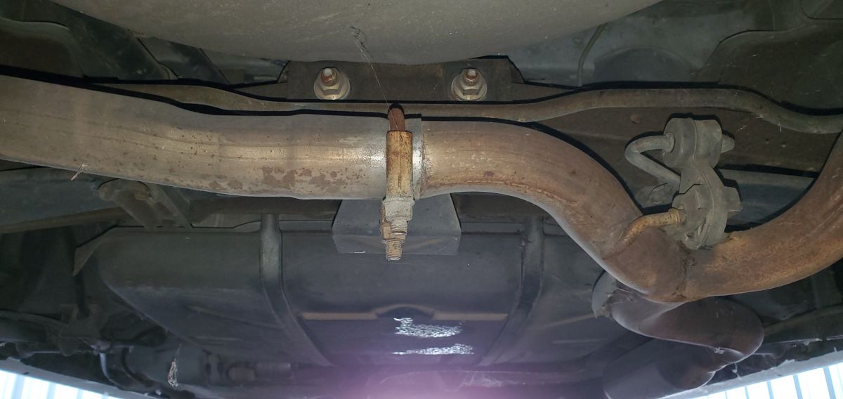

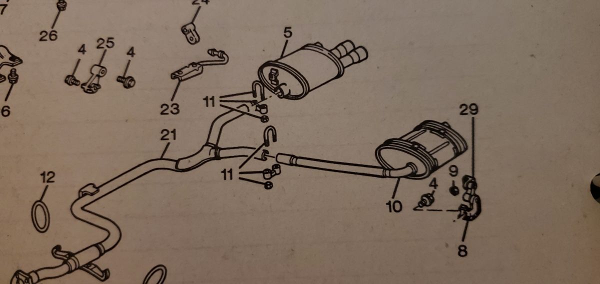

jiggity76 Posted May 29, 2020 Author Report Posted May 29, 2020 (edited) Sorry guys, I keep forgettin I have a PARTS BOOK!!! Geez! Yes, this clamp is factory. My STE has it as well and it's #11 on the diagram, part #10114791 for the clamp and part #10199232 for the dampener. It's staying on the car and going to use the STE as a guide to where it's suppose to be and tighten it down. Sorry to put you all thru this. Edited May 29, 2020 by jiggity76 Quote
