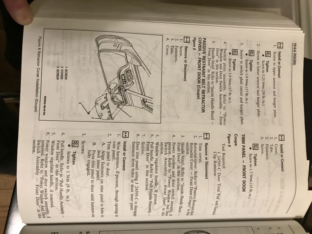

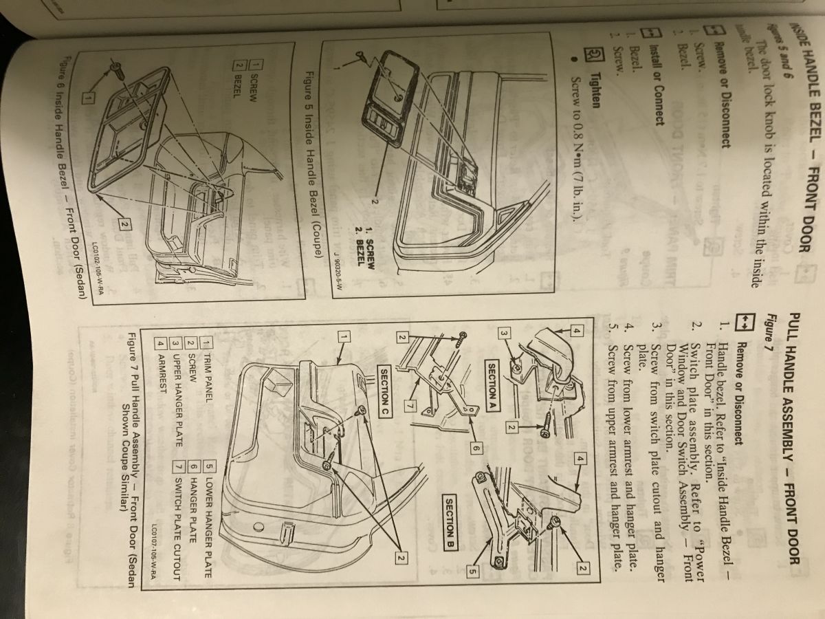

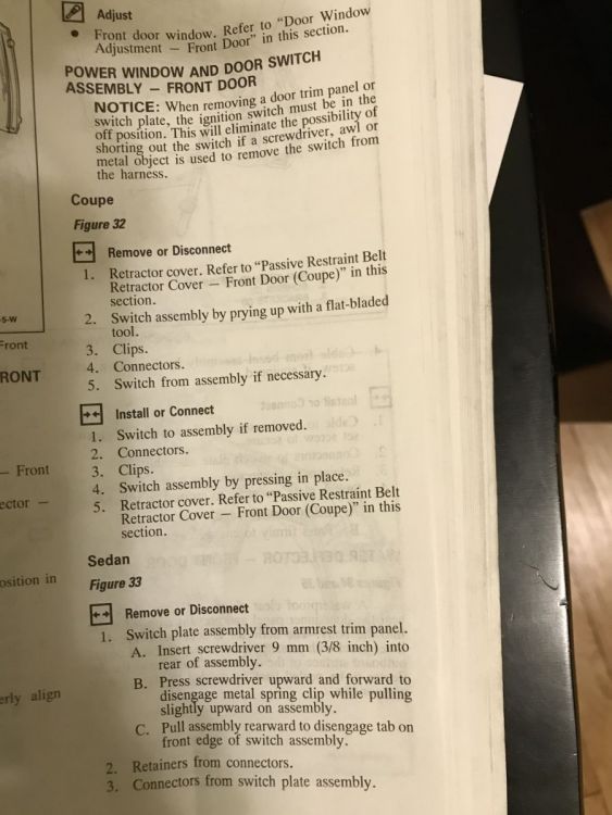

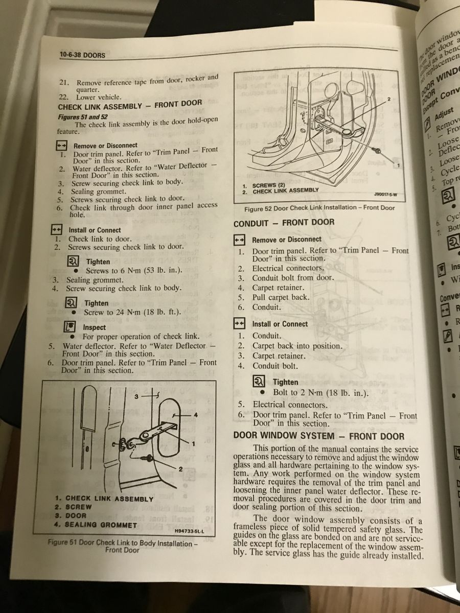

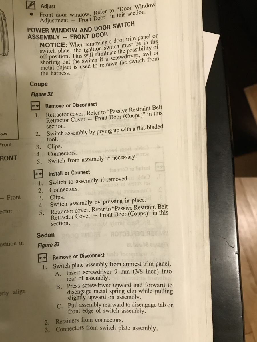

jmjp5055 Posted March 3, 2020 Report Posted March 3, 2020 (edited) Well seems to be common.1st. Get panel off , pics may help , next remove door check , replace, pictures should help. go to the local bone yard find some 90 to 95 and practice. the harder is getting the door panel off. good luck Edited March 3, 2020 by jmjp5055 Wrong picture Quote

Bigal8632 Posted March 3, 2020 Author Report Posted March 3, 2020 Jmjp5055 - Thanks for sharing the manual info. I recently had the door panel off to replace the dreaded door handle. Have not been able to findpp replacement check. Quote
