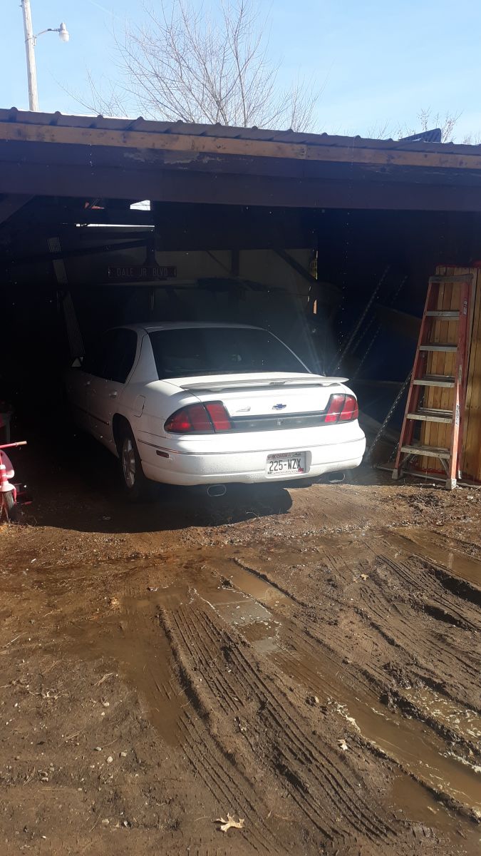

Alecdroxx Posted March 1, 2020 Report Posted March 1, 2020 I purchased a 2000 chevy lumina about 3 months ago, it has the 3100 sfi v6 and felt really sluggish when i bought it. Since then i found out the cat converter was completely plugged up, i put a new high flow cat on and it gave the engine a massive increase in power, i also decided to get bigger piping all the way to the back with a resonator delete and put the back half of an exhaust off a grand prix in it with custom hangers for the dual exhaust, i also made another intake tube that goes into the front bumper for more cold air with a trottlebody off a 3400 sfi, it feels alot better and it will actually chirp the tires at launch. Im looking to get more power out of it but i have a pretty tight budget (around $250) anyone have any ideas to squeeze a bit more juice out of her? Thank you Quote
