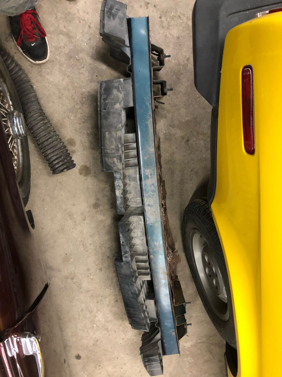

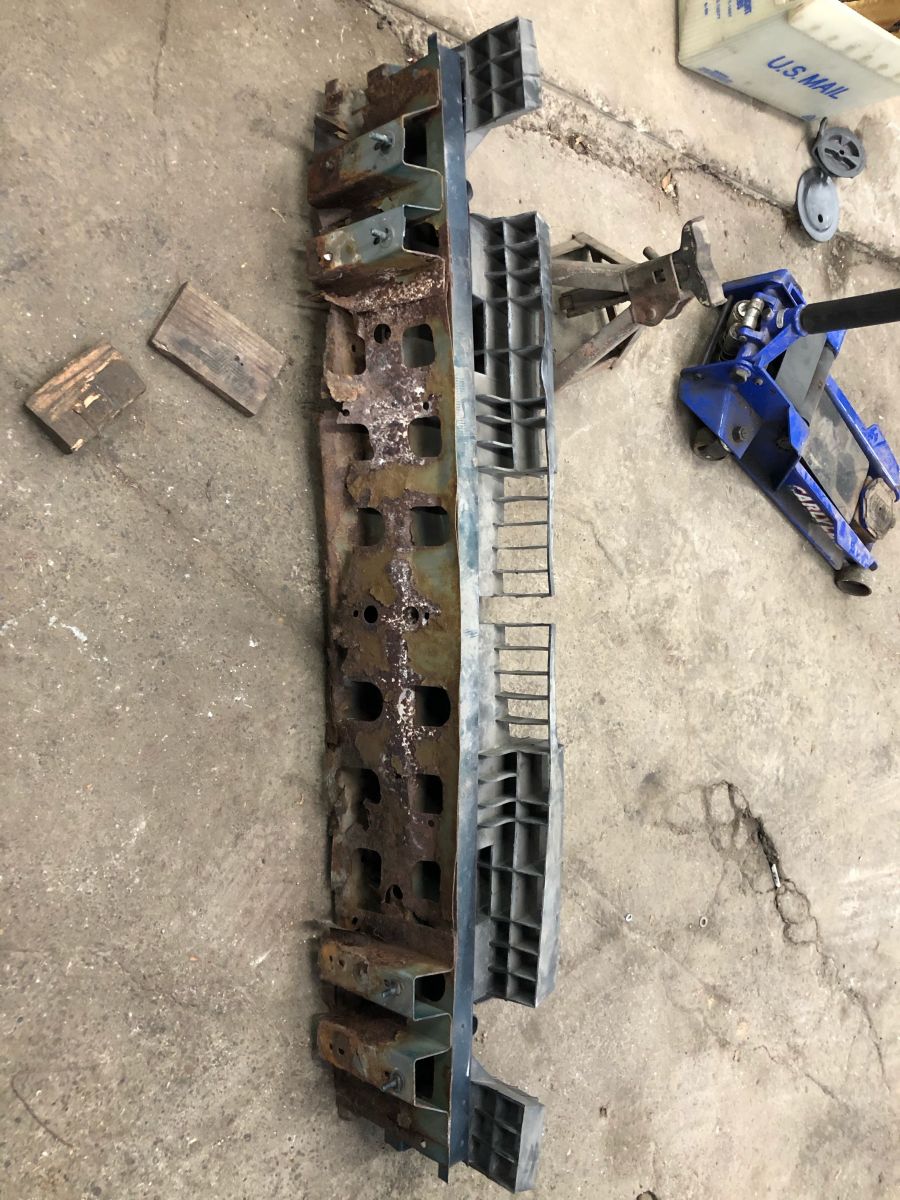

I do have one particular issue here at the shop, and was hoping you all might be able to provide some guidance. We have a 1997 Cutlass Supreme sedan here for some rear end body work. The car needs a replacement rear bumper reinforcement -- the one that was in there was pretty rusted out. The consensus here is that the existing part is beyond repair. I've been trying to locate a good part from recyclers across the country and have had no luck...
This seems to be a common problem for the W-body cars -- at least those that lived their life in the salted Northern winters. So I'm wondering how you all might have dealt with this issue?  If there's a forum conversation you could point me to, that would a great start (tried searching the forums with no luck...). In case you find it helpful, I've attached a picture of the reinforcement we are working with.

Welcome and thanks for joining! The rear bumper support being rotted out is definitely a common theme for the northern cars. The only solution I'm aware of is a junkyard piece. I still see first gen W cars in the pick-n-pull yard every now and then, so they exist, but I think the problem you're gonna run into is that we-pull-and-ship auto recyclers aren't gonna stock them.
I'm not ultra familiar with the logistics of used auto parts, but outside of finding a southern yard that stocks old cars AND is willing to ship, I'm not sure what else you can really do in that scenario.
Hey thanks for the info. I'd been leaning in the direction of contacting recyclers in the southern US states -- I've had some success doing that when dealing with similar parts problems in the past. Don't know if it's at all helpful here, but based on GM part numbers it looks like the following vehicles use the same rear bumper reinforcement as the 1997 Cutlass Supreme:
GM Part No: 10274675
1990-94 Buick Regal (coupe)
1990-97 Oldsmobile Cutlass Supreme
1990-96 Pontiac Grand Prix
If I'm mistaken on any of the above info, please let me know. Thanks again for the help!

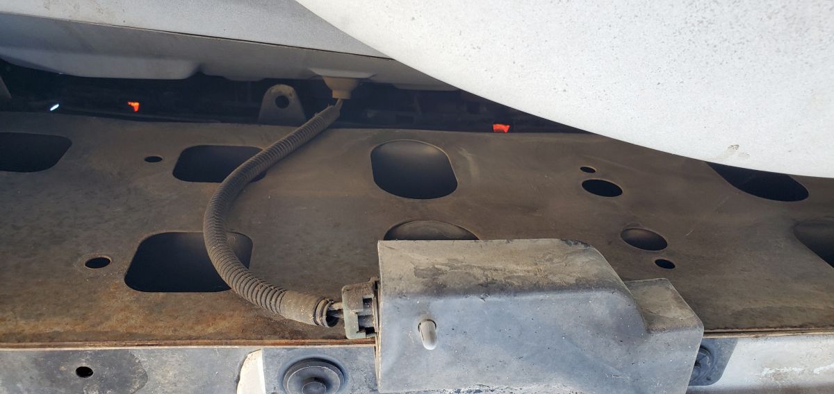

I just wanted to show what a rust free CA one looks like, LOL.  My CA Grand Prix STE.
