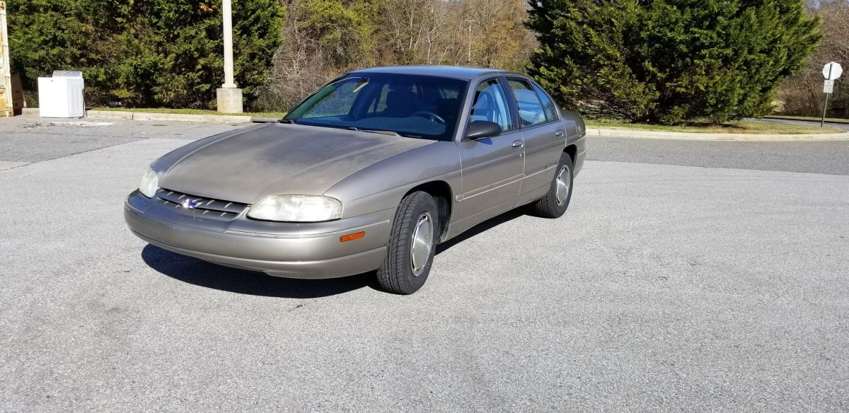

Jim_rockford_007 Posted December 25, 2019 Report Posted December 25, 2019 any idea if its even worth the time to tune this? not really going to be doing any other mods, engine is staying stock. Quote
Dark Ride Posted December 26, 2019 Report Posted December 26, 2019 If you can do it yourself I don't see why not if you plan to drive it for a while. At the very least adding some timing to your cruise table could net a few mpgs. Quote
digitaloutsider Posted December 26, 2019 Report Posted December 26, 2019 Your biggest advantages of a tune is going to be improving the transmission tables for better shifts. Outside of that, not gonna see much from a tune on an stock L36. Psych0matt 1 Quote
Jim_rockford_007 Posted December 30, 2019 Author Report Posted December 30, 2019 Well I found out Friday coming home that it doesn't have a speed limiter below 115 mile-an-hour at least if it has one I didn't run into it and as far as the transmission shifting this 4t65 seems to have a pretty good strategy. The shifts are nice and quick and it doesn't seem to do any hunting looking for the right gear to be in I don't know if these 9c3 is got a different strategy on the transmission side of the programming or not. I currently don't have any program to tune in OBD2 car I just have the dongle that plugs in to the port that I can monitor stuff via Bluetooth not sure if I could send a tune through it. Quote
digitaloutsider Posted December 30, 2019 Report Posted December 30, 2019 Generally GM's speed limiters match whatever the speed rating on the OEM tires were. As far as transmission tables, in my experience they're generally the same between the regular car and the 9C1/3 counterparts. The car cannot be flashed with standard ELM-type Bluetooth dongle, but can be tuned with HPTuners. Or if you can find an old used DHP setup or TunerCATS. Quote
