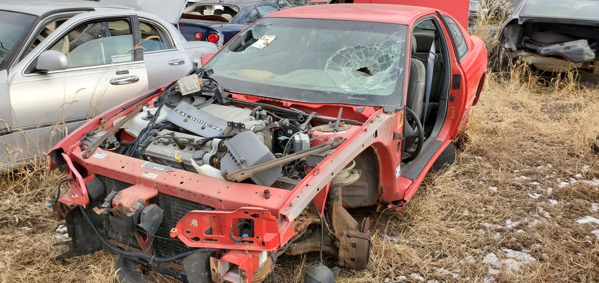

jiggity76 Posted December 22, 2019 Report Posted December 22, 2019 10 minutes ago, ManicMechanic said: The thickest rear was on the 1995-96 Monte Carlo Z34. I think it hits the exhaust on 1st gens though if I remember right. I was just at this yard yesterday grabbing some underhood hardware from this 95 Z34. I didn't know that and maybe I could have grabbed the rear sway. Quote
