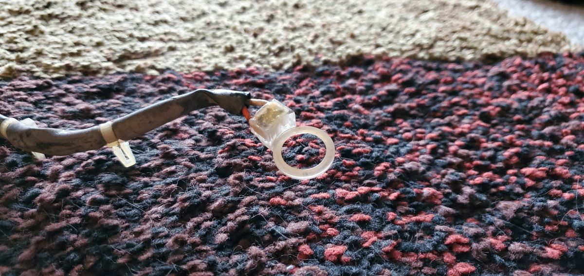

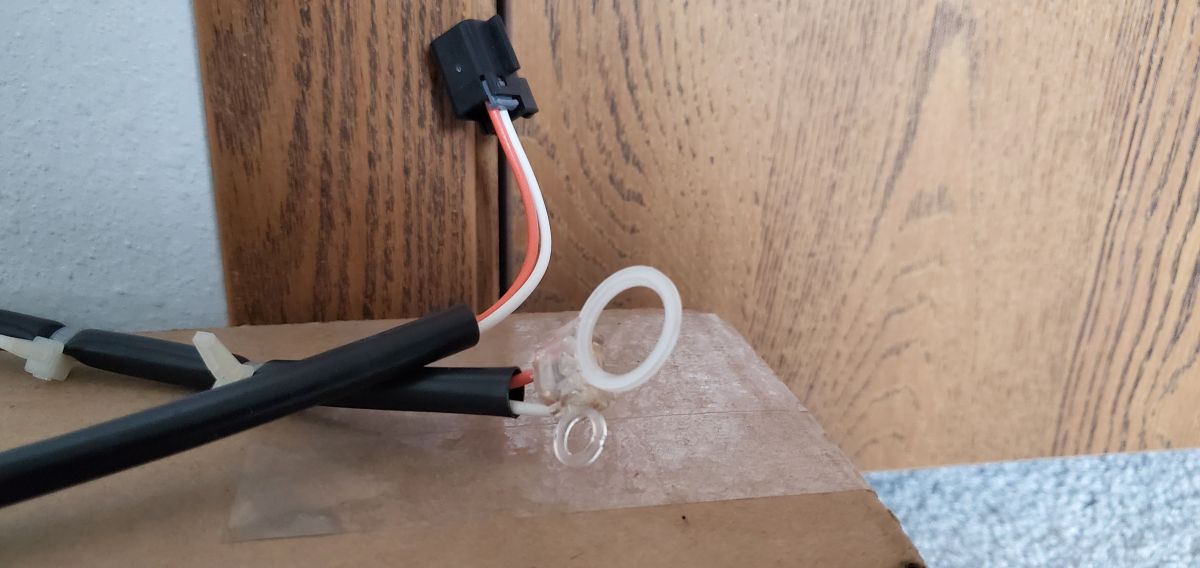

jiggity76 Posted December 16, 2019 Author Report Posted December 16, 2019 I've been talking with MemphisMan, there is a ring that basically clips around the key cylinder and two wires that are soldered on. I'm guessing the wires plug into the harness that runs thru the door and yes, I agree about the bulb. I'm going to open up the parts car and the 91 car and see if I can figure this out. That's what I'm worried about. I lost the illuminated ring. I've tore apart my parts room and I don't know where it's at. Unless I left it in the white car or parts car. I'll look again tomorrow. One good thing, MemphisMan said his 95 vert has this option so I might have better chances of finding one in a yard either thru a newer coupe or vert. Thanks digital! rich_e777 1 Quote

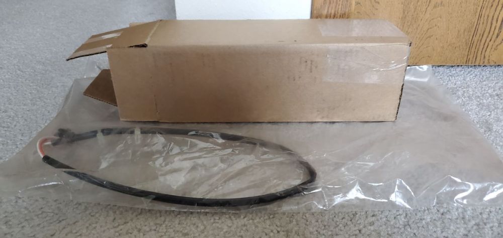

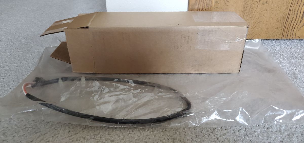

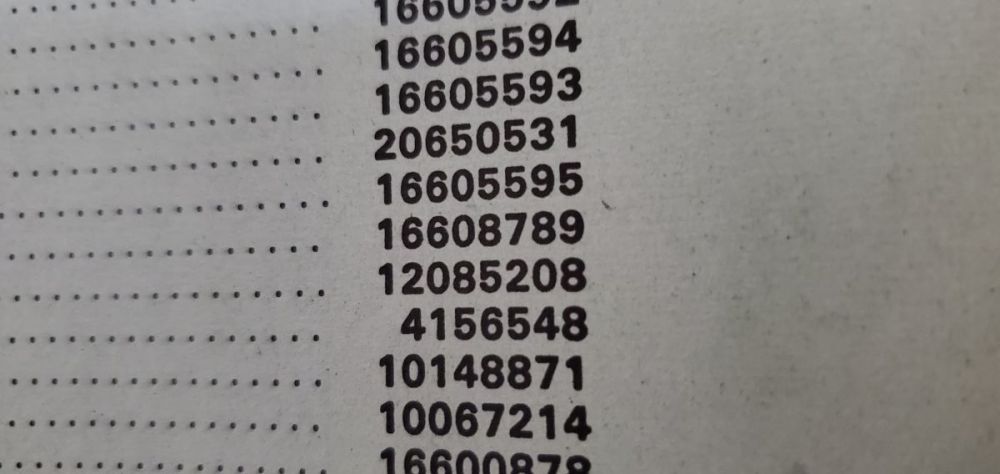

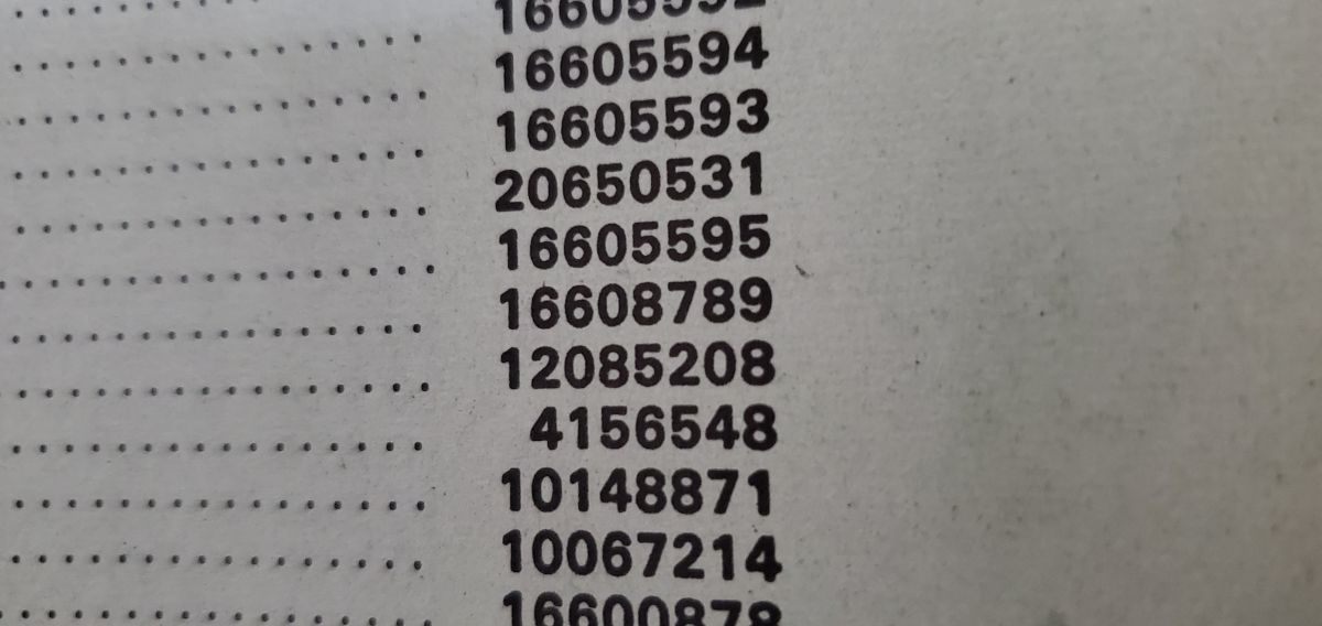

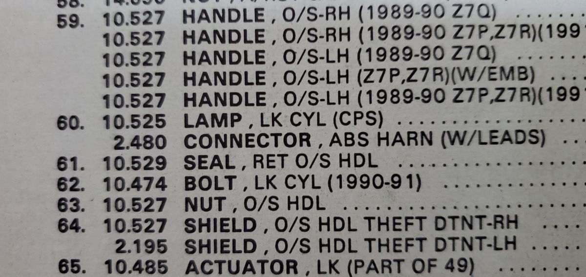

jiggity76 Posted December 16, 2019 Author Report Posted December 16, 2019 (edited) I found the part # for the illuminated lock. I called my local GM dealer this morning and they confirmed the part # of 16608789 LAMP ASY to be correct. They then did a search and came up with 1 NOS unit in NE at a GM dealer. I called them this morning and the parts person actually found it! Took him a few minutes but he also couldn't believe it was there! He described it too me and it seems to match the one I need. It cost me $76 bucks with shipping and should be here tomorrow. I hope it's the right one and will post it when it gets here. Part # 60 in the illustration and description. Edited December 16, 2019 by jiggity76 Quote

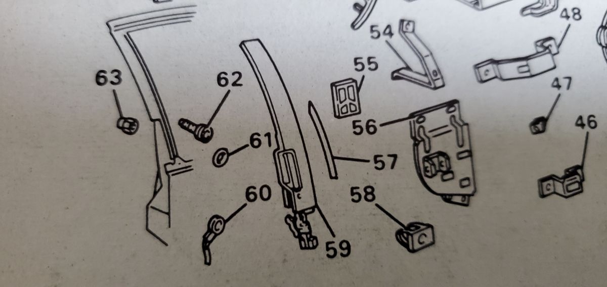

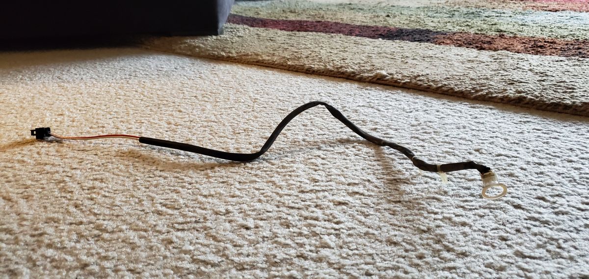

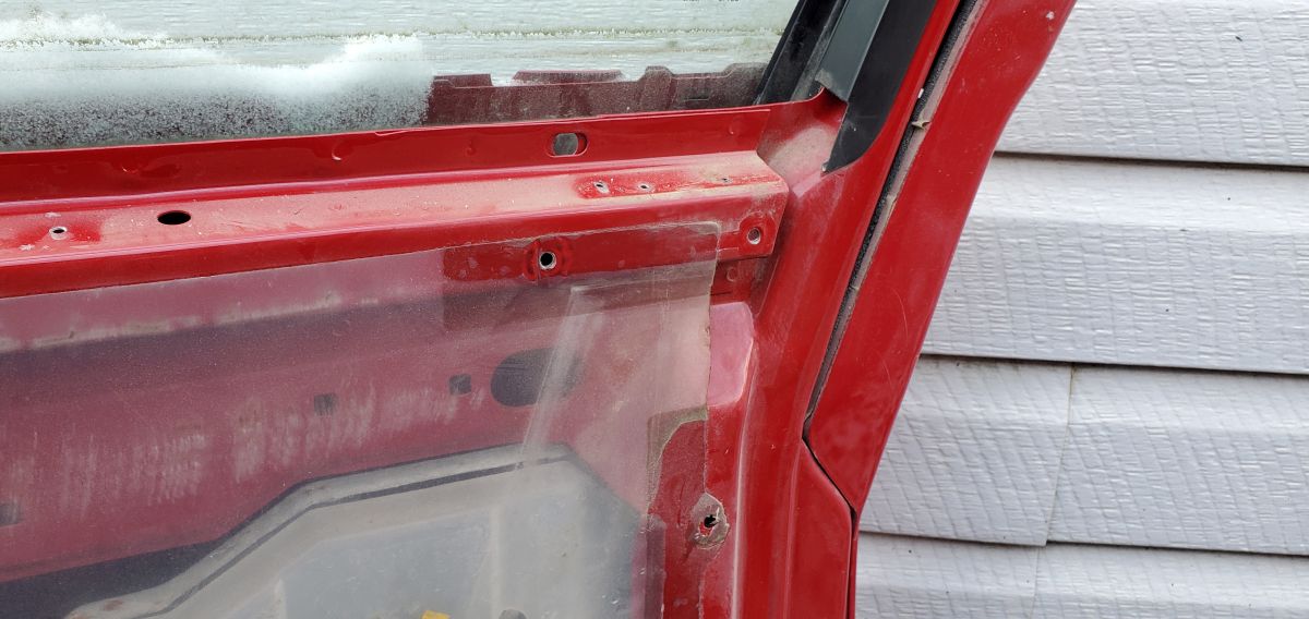

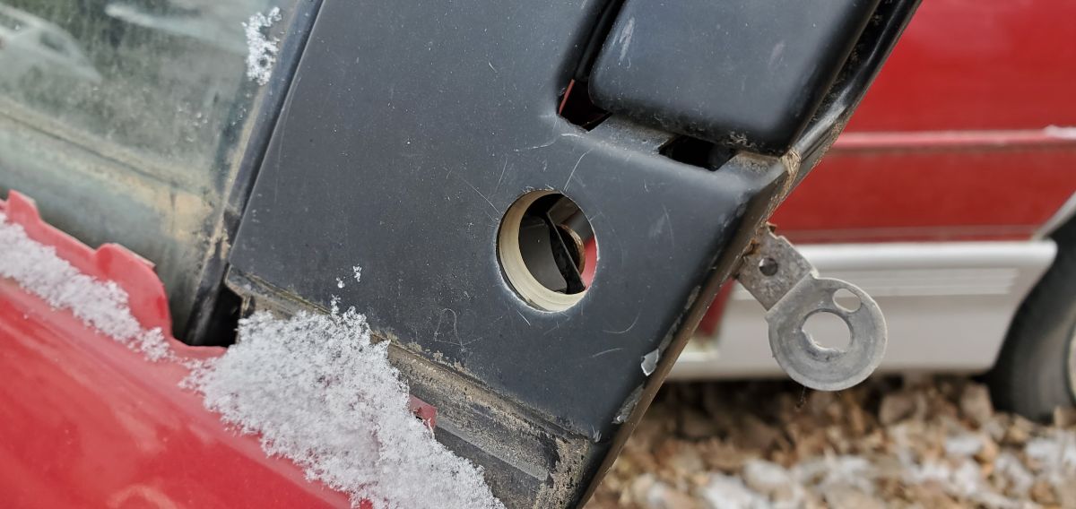

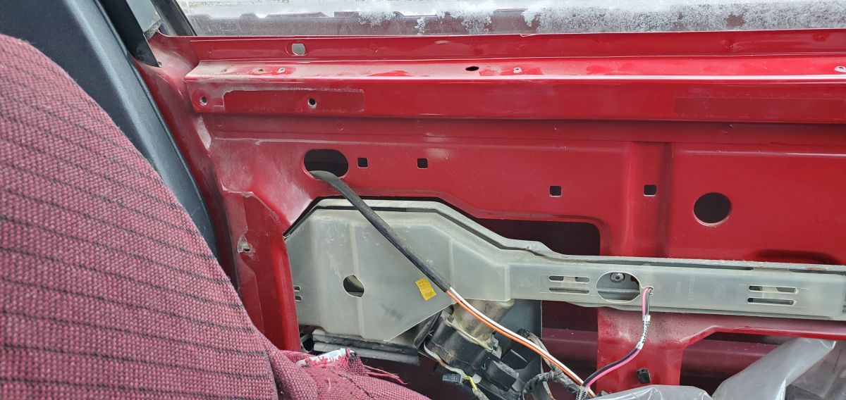

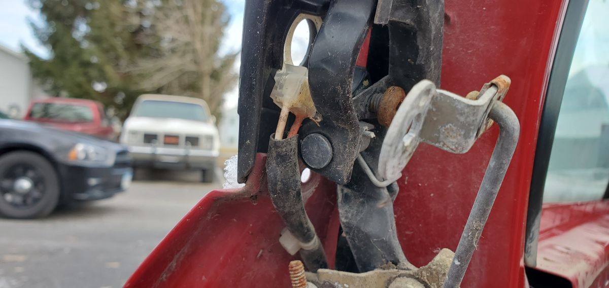

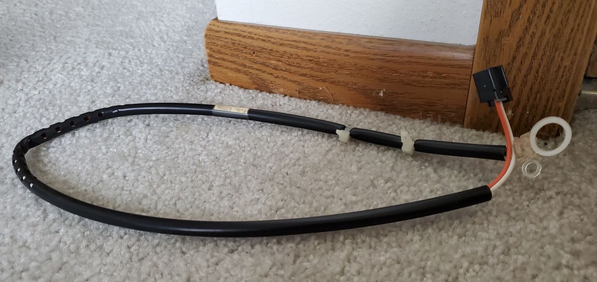

jiggity76 Posted December 16, 2019 Author Report Posted December 16, 2019 21 minutes ago, digitaloutsider said: Your ability to find parts that haven't been made since the Clinton administration never fails to amaze me. LOL! Thanks! I've been very lucky and I guess I'm willing to put in the work. By the way, I just looked at the parts car. I bet this is the wiring harness for the lock. It's only on the driver's door which makes sense since it wasn't offered on the passenger door. The white and orange wires going thru the oval hole up towards the top of the panel. This wiring harness is absent in this same area on the passenger door. I can't remember if I seen this on the white 91 car. I'll have to look at old pics when I had the panel off of that one. digitaloutsider 1 Quote

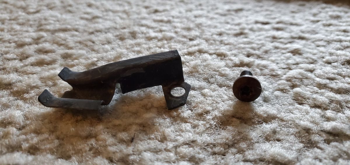

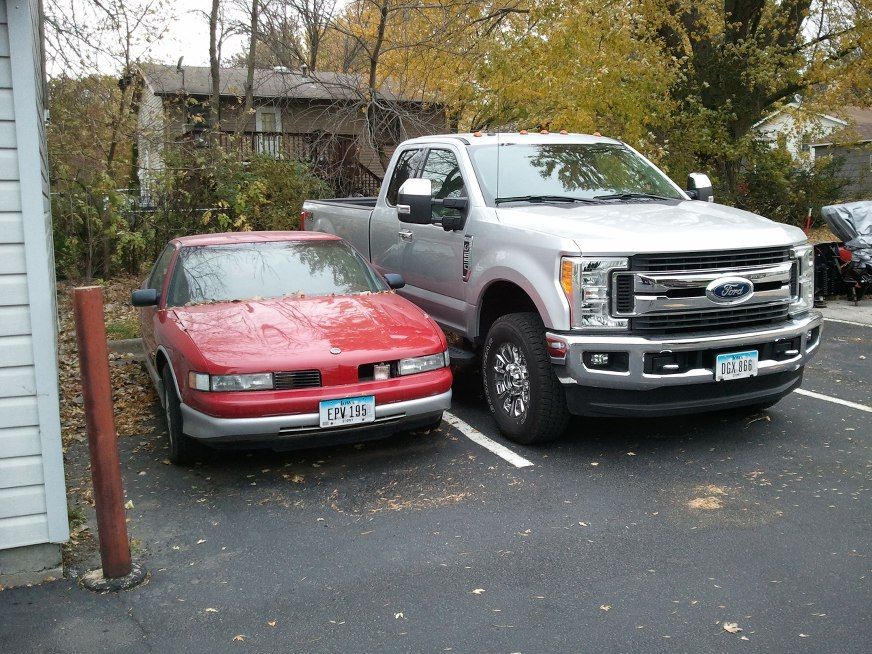

jiggity76 Posted December 16, 2019 Author Report Posted December 16, 2019 So, I'm an idiot! I did it again! Due to my scatter brain, I just went and looked, yeah, the parts car still has it. I thought I pulled it already and was worried I had already pulled it but lost it in my parts room. It's not the easiest to get to the driver's door since my Super Duty is next to it so I just couldn't go out and check. I had to move the truck and open the door from the outside. But I was thinking about it...if the wire was still mounted on the door, and the wire is connected to the illuminated ring, it still has to be on the car and that's why I checked. Sorry guys to put you thru this, my own enemy in this case...AGAIN! At least I have an NOS one coming and this one as well. Not sure if it works anymore and I don't see a bulb anywhere so the ring itself must be it's own bulb? I don't know. rich_e777 1 Quote
Pontiac6KSTEAWD Posted December 16, 2019 Report Posted December 16, 2019 1 hour ago, jiggity76 said: (cop car in background) I saw this and immediatly thought of Bill Engvall/Jeff Foxworthy... Its the cops.. cops cops.. Be Quiet, Act natural! jiggity76 1 Quote
jiggity76 Posted December 16, 2019 Author Report Posted December 16, 2019 25 minutes ago, pontiac6ksteawd said: (cop car in background) I saw this and immediatly thought of Bill Engvall/Jeff Foxworthy... Its the cops.. cops cops.. Be Quiet, Act natural! LOL! That's hilarious and didn't even see the car until now! That's my friend Glenn Goode, he's a DOT Officer for the State of Iowa. He was picking up his dad who lives in my apartment building. Good eye, that's his 2011 Dodge Charger Police package car he bought brand new in the Spring of 2012. It was a left over model, has the Hemi with cloth front bucket seats, column shift, no center console, and vinyl rear bench seat. I asked him today actually, it's got 58,000 on it. On the other side of my 87 GMC High Sierra 4x4 truck pictured there, he is storing his fiancé's Malibu. He was also checking up on it. Quote

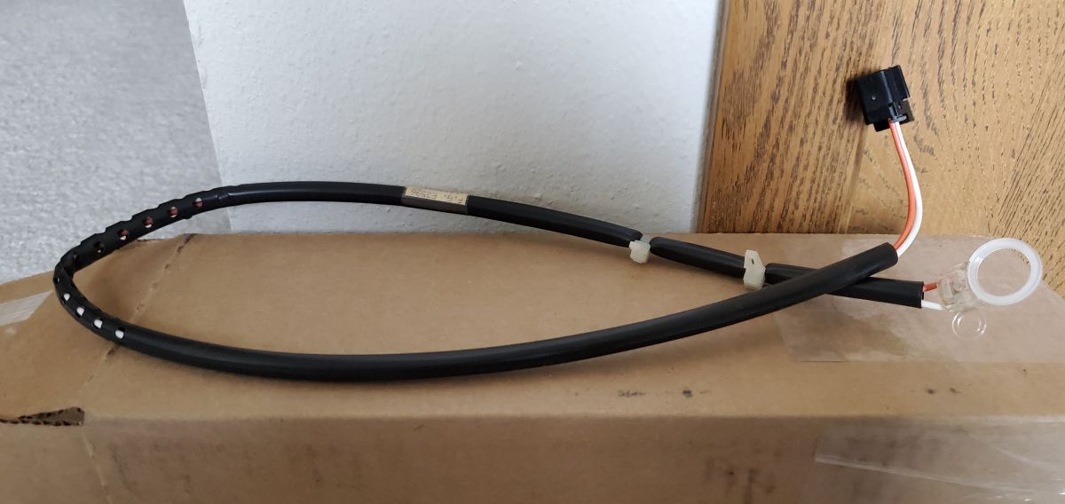

jiggity76 Posted December 17, 2019 Author Report Posted December 17, 2019 Merry Christmas too me! I just got it and it's amazing! Quote

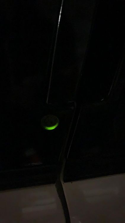

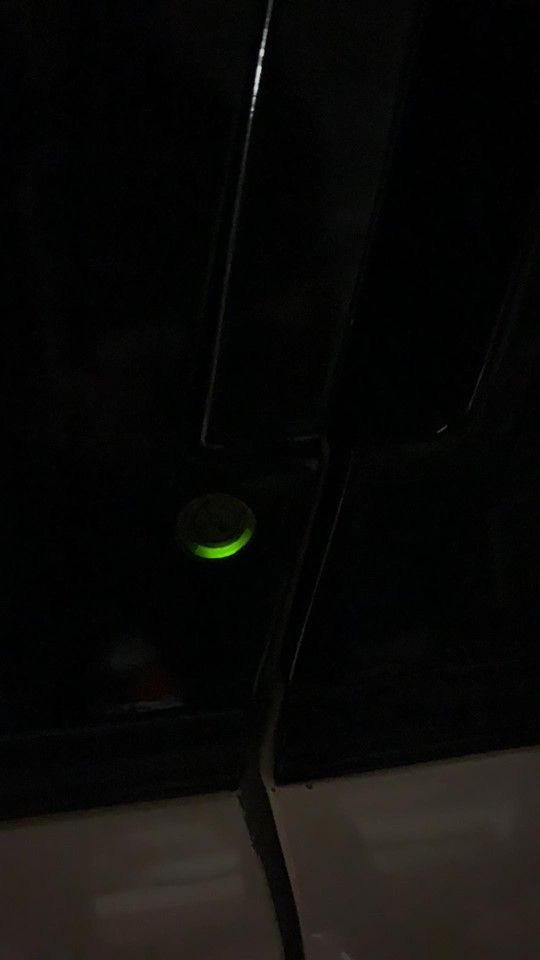

jiggity76 Posted January 29, 2020 Author Report Posted January 29, 2020 (edited) Ok, an update! So yes, the Lumina's have this feature. A gentleman on FB has a beautiful 92 Z34 5 speed car and his illuminated door lock still works. He sent me this pic. The only question now...is his partially burnt out? Only the bottom part of the ring is lighting up. Isn't the entire ring suppose to illuminate? So we know the Lumina and the Cutlass have a green light. I wonder if the GP and Regal use a different color? Edited January 29, 2020 by jiggity76 94 olds vert 1 Quote
94 olds vert Posted January 29, 2020 Report Posted January 29, 2020 The one in my cutlass never worked. I don't recall my 1991 Grand prix having one. Maybe cause it never worked. It is cool to see one actually working still. jiggity76 1 Quote
jiggity76 Posted January 29, 2020 Author Report Posted January 29, 2020 MemphisMan just sent me a video of his working on his vert, looks the same as the one I pictured. He thinks my NOS one should illuminated the entire ring since it's never been used and with age and UV rays, that's why they fail or partially light up. Hopefully he posts the video. If he doesn't, I could post it if he's ok with that. Quote
