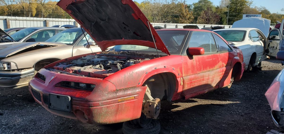

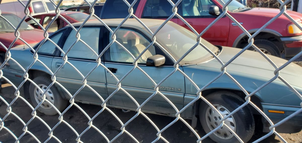

jiggity76 Posted November 4, 2019 Author Report Share Posted November 4, 2019 2 hours ago, 55trucker said: All of the door clips look like these...... There is a large philips headed screw under the pull handle that takes most of the load when one pulls on the door, the bottom seatbelt retractor cover has a pair of screws that are under the very bottom of the trim cover. There is also another retaining screw in behind the door panel lamp at the rear of the trim panel. One has to carefully pry out the lamp housing to get at the retaining screw. Awesome! Thank you. I'm going to order the clips today. Also, I might be going to the yard tomorrow, I'll grab an exhaust shield from this car or maybe this coupe. Would this work for ya? Quote Link to comment Share on other sites More sharing options...

jiggity76 Posted November 4, 2019 Author Report Share Posted November 4, 2019 2 hours ago, 55trucker said: To be lucky enough to even be able to come across these *old* cars in a salvage yard..... yeah Greg, if you find one unmolested please do pull it for me.......just hang onto it........ thx Will do my friend. Pulling the STE door panel as we speak! And this red coupe...yeah, only 72,000 miles on it Quote Link to comment Share on other sites More sharing options...
