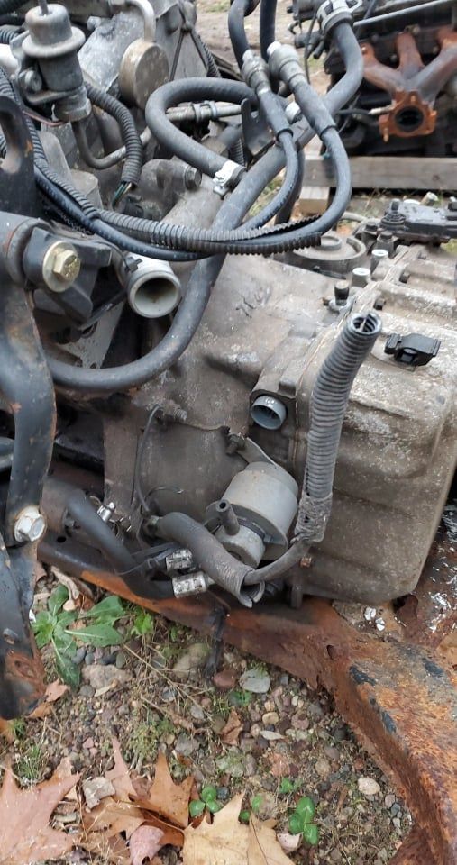

Watchingwolf Posted November 2, 2019 Author Report Posted November 2, 2019 Steve~ Thanks for that information! Here is the donor trans ans it does indeed have a vacuum modulator so it would indeed be a 4T60E. ANy other issues I need to watch out for? Quote
55trucker Posted November 2, 2019 Report Posted November 2, 2019 (edited) Outside of replacing the output shaft seals...nothing mechanical......in situations like these I lean to replacing the trans fluid & filter (at 90,000 miles you don't know the history & how long what's in there has been in there), since the trans has to come off the engine dumping the converter fluid is possible as well (suction gun). You may or may not need to adjust the trans selector switch position after you've got the replacement trans installed. Edited November 2, 2019 by 55trucker Quote
