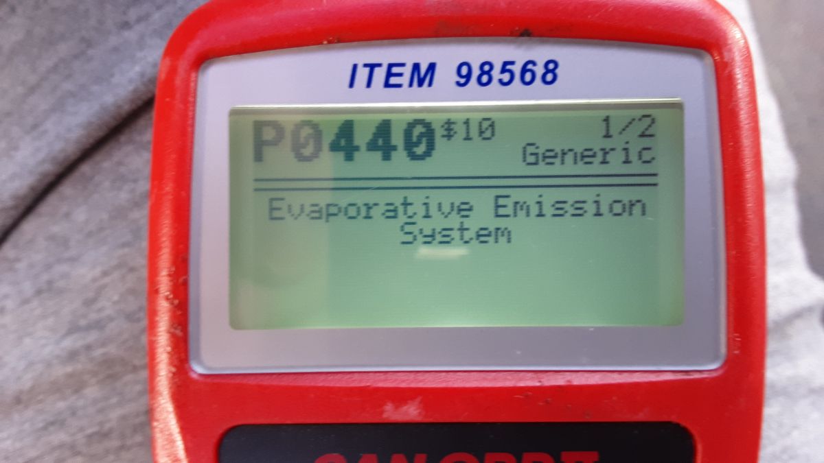

well got a problem with my 1997 chevy lumina 3100 v6 118k miles
the gas tank is doing a "thumping sound" like thump,thump,thump...
and the service engine light is on. code P0440. no gas leaks or smells, car runs just fine, no noticable loss in mpg's.

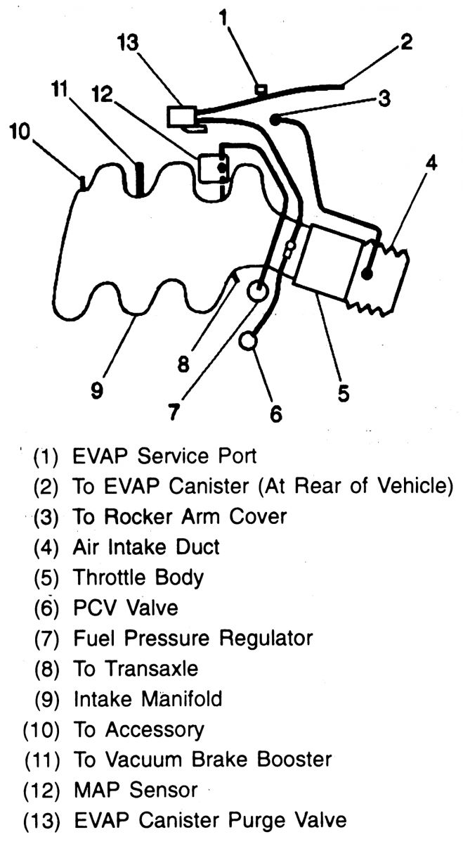

i have the service manuals. but cant locate the evap system part

its the code stayed away for a week, i put 70 miles on the car saturday. no issues. today i'm in it for 20 minutes and P0440 GRRR.  yes damned annoying. !

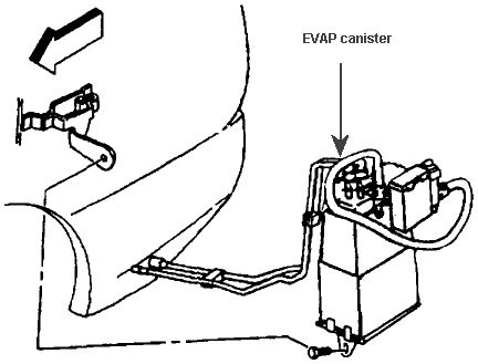

anyhow. i did get the -canister-vent-valve-solenoid off(it was dusty!), it it bench tested good (so did the -canister-PURGE-valve)

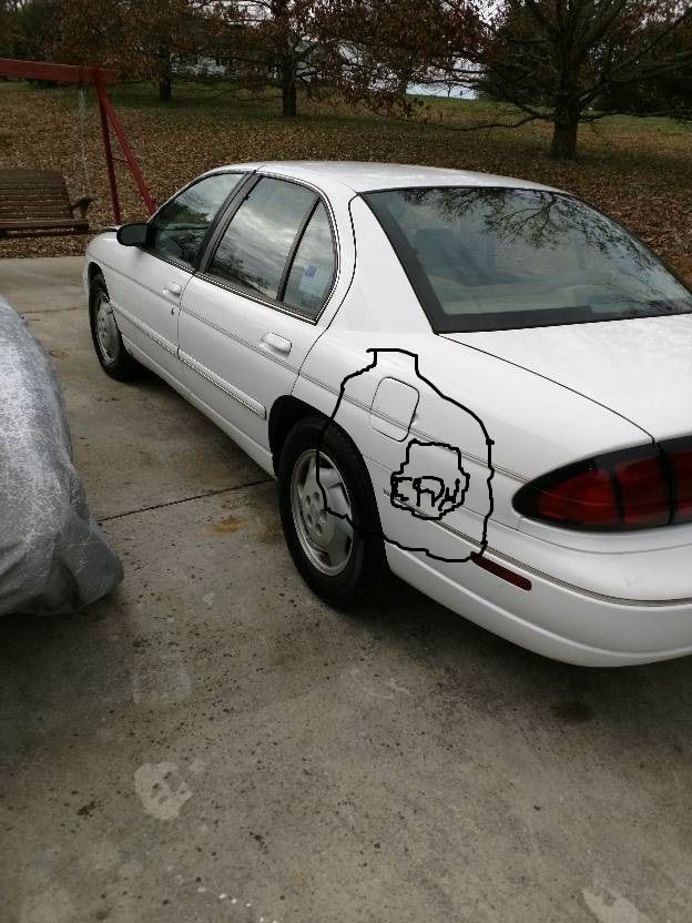

so it may be a wireing problem.  note to 95-01 lumina owners the evap can, can be accesed via the fuel door, remove 3 7mm screws & plastic around the gas fill, its all there! i got a few scrapes but it beats  tire & inner fender removal!!!!!!

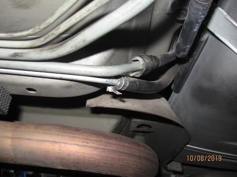

My car is a 96 Regal so this might not apply to your 97 Lumina.
My 96 set a code once when the Purge Valve Solenoid got clogged from charcoal or rotten rubber EVAP lines. Removed it from the car applied 12 volts to the pins and blew out the black crud with caned air.
Few years later it set the EVAP code again and every thing checked good and I gave up for a while. Had the car up on jack stands to change the fuel filter and found a split EVAP rubber line just in front of the gas tank. This is where the steel EVAP line changes to a rubber line and goes up and over the gas tank to the charcoal canister.
From the factory the rubber EVAP line is just pushed on to the steel line with no clamp of any kind. When I pulled the split hose off the steel line was rusted so I had to sand and paint that before cutting off the split rubber and sliding it back on. I then installed a small screw clamp for ½ inch rubber hose to keep the water out and causing more rust. After this there were no more EVAP codes.
Later on when I replaced the fuel pump I upgraded all of the EVAP lines with rubber fuel line. After 15 years the EVAP rubber lines were falling apart.

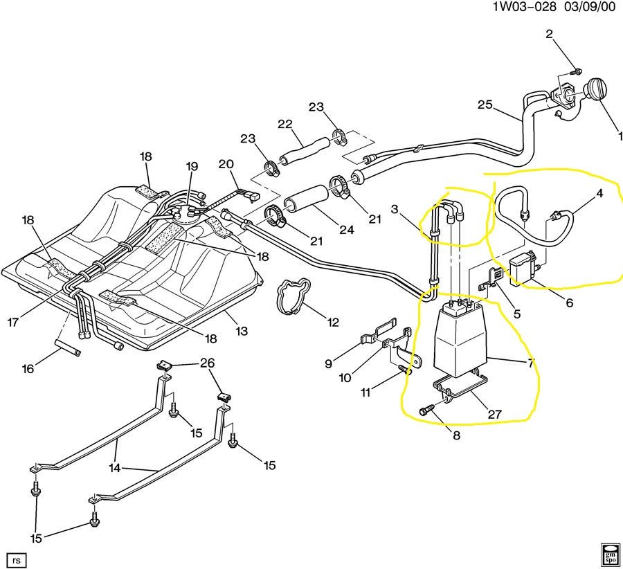

well fixed the leak!  quick connect going to the tank from the charcole canister was loose. no more damn codes!
BUT! its popping WORSE!!!! agggrrrrrrggg WATCH THE VIDEO!
DAMMIT!
i replaced the parts circled . with nos delco parts.0003091W03-028.thumb.jpg.86735b3baf253c3c57bd3d7898579651.jpg

Where is the purge valve located having same issue with that code figured I would start there?
