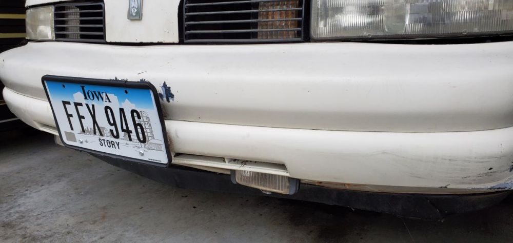

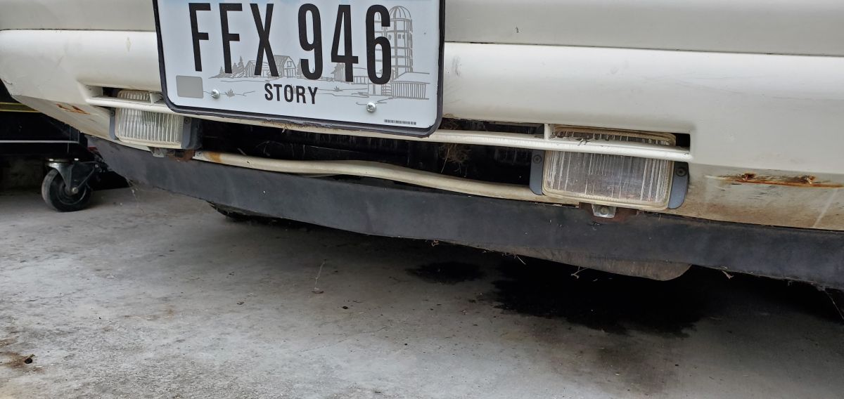

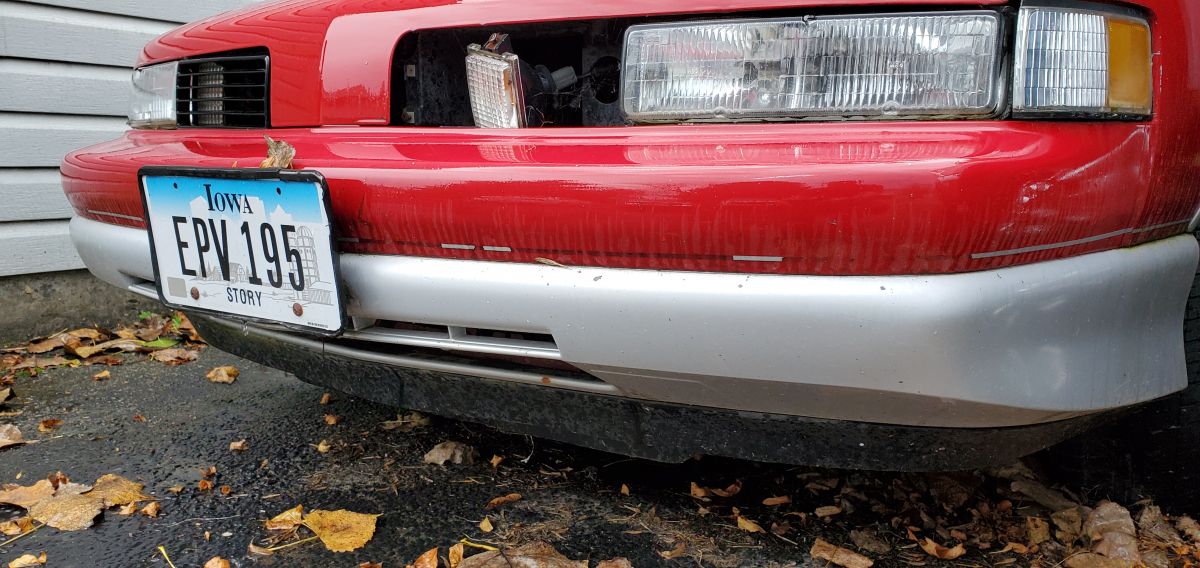

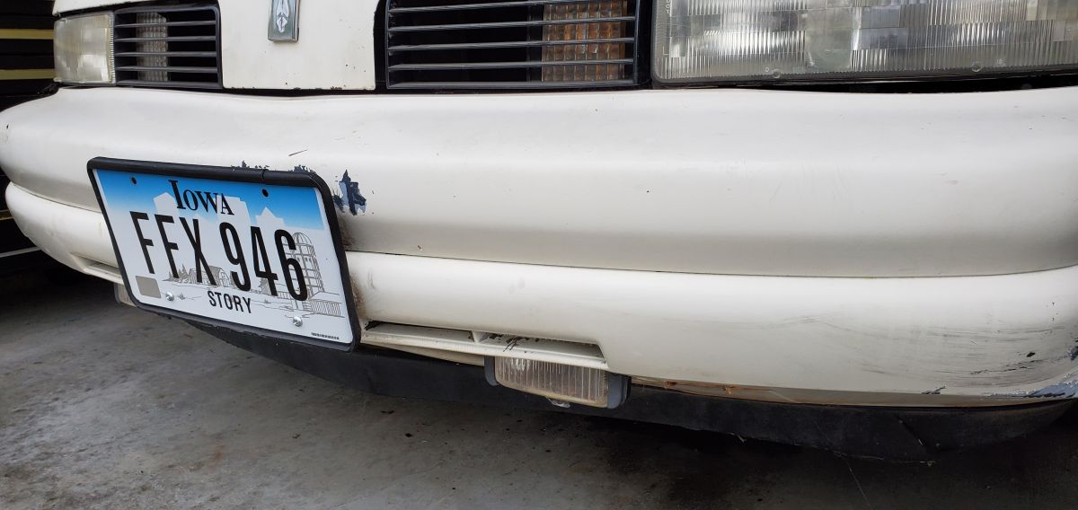

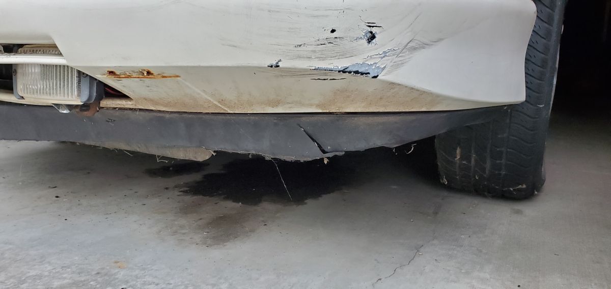

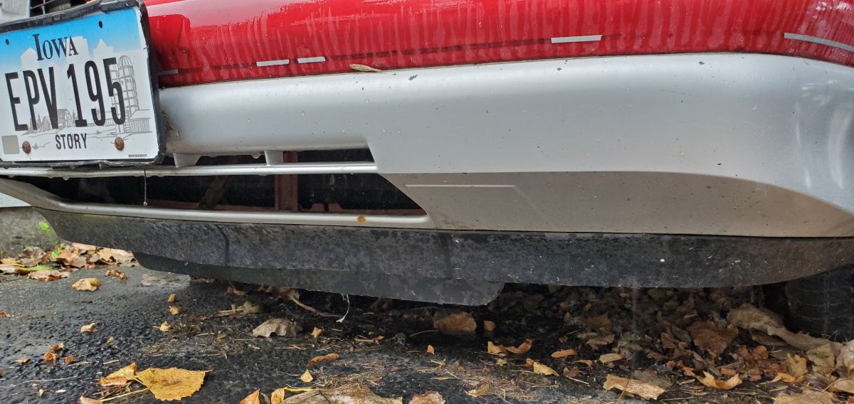

I didn’t read anything just took the pics. lol.
If any are not clear enough or you need anything else let me know and I’ll send you better pics
