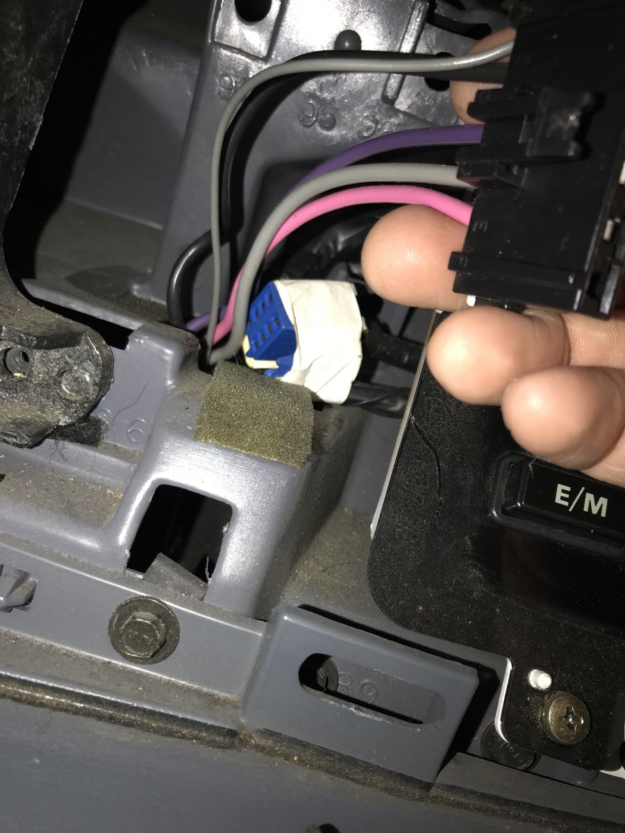

K&R Posted September 7, 2019 Report Posted September 7, 2019 I’m pulling the top pad off the dash of my 90 Vert and behind the top switch was this connecting wire wrapped in tape. Although I have a aftermarket radio I don’t think it goes to it. Since this car left the factory a coupe and converted later could this be the outlet for the fog lights or bass audio switch? Quote
Bake82 Posted September 7, 2019 Report Posted September 7, 2019 That does look like the fog light switch connector that is in my cutlass that has 89 coupe wiring. Quote
mmyers70 Posted December 24, 2019 Report Posted December 24, 2019 Thinking that might be the connecting wire for the heads up display jiggity76 1 Quote
jiggity76 Posted December 24, 2019 Report Posted December 24, 2019 (edited) I would strongly say no on the possibility of the fog light/audio bass control and HUD connector options. I have all these items and if you look at the female connector on the back of them, they take a large number of pin/block shaped male connectors. The HUD male connector/wiring will also be high up in the middle of the dash more in center with the digital dash because of the HUD location as well. K&R, if you look at the block shaped blue pin connector wrapped in white tape in your pic at the bottom, that would be the connector I bet for the fog light/audio base control switch. It has 8 pins and a single blade locater that matches up. I will look on the parts car tomorrow and see if I can help you figure out what that more slender connector is for. Edited December 24, 2019 by jiggity76 K&R 1 Quote
jiggity76 Posted December 24, 2019 Report Posted December 24, 2019 (edited) 1 hour ago, mmyers70 said: Thinking that might be the connecting wire for the heads up display You know what, I think you might be right! I totally forgot the 88-90 cars had the first gen HUD units and therefor the dimmer switch is located on the left side of the dash. The HUD in my 91 Cutlass has the 2nd gen HUD unit and they have a totally different setup compared to the earlier cars. I bet this slimmer male connector is for that switch. These earlier cars must have be pre-wired for it and that's why it's just floating around in there since K&R's 90 vert wouldn't have HUD (94 was the first year for the HUD option in the verts). It would be pre-wired for it though since HUD was available on the coupes and the first year 1990 Cutlass sedan, although I've never seen a 90 Cutlass sedan optioned with HUD that I can think of. I'm going to look on my 89 Cutlass parts car and see if that same connector is there like in K&R's vert. My bad and I apologize, thank you for posting! Edited December 24, 2019 by jiggity76 Quote

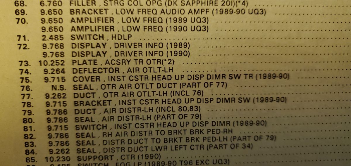

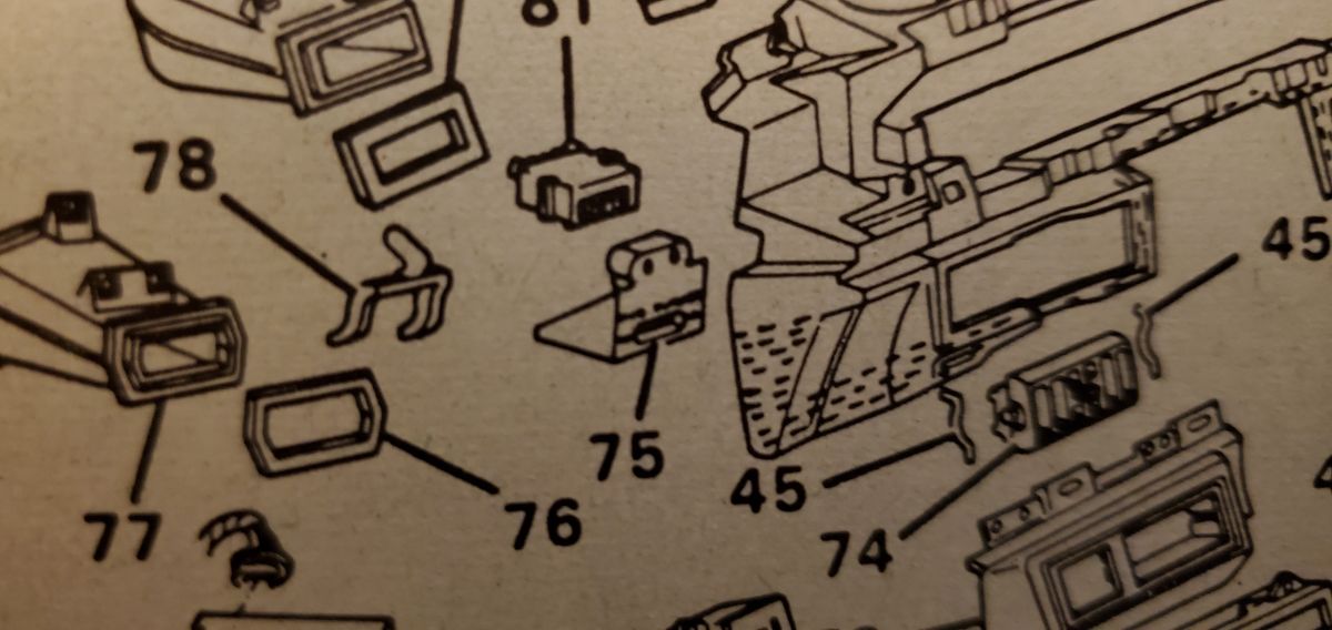

jiggity76 Posted December 24, 2019 Report Posted December 24, 2019 (edited) The part # book is what makes me think it's the connector for the HUD dimmer switch. Number #75, 78, and 81 in the diagram and part description. Edited December 24, 2019 by jiggity76 Quote
