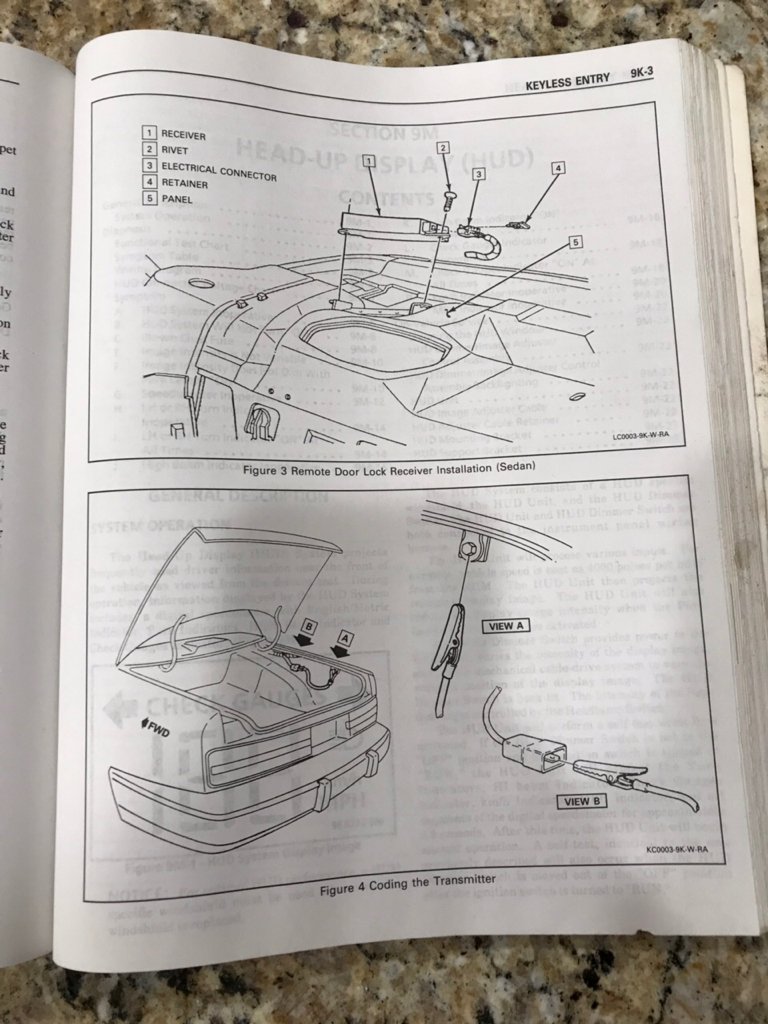

WillCut Posted June 29, 2019 Report Posted June 29, 2019 (edited) Ok, so I read the forums on how to do this procedure and found some pics from one of MephisMan's threads. I've located the black/white wire connector while fixing my power antenna. I ground the wire and nothing happens. I just got the car and don't have much history but it only has only 65k on it and seems to be in decent shape. I wouldnt suspect much hacking of the wiring and it certainly looks normal. The only remote I got was aftermarket but I'm assuming it can be programmed natively with the car. its a Prestige 105BP. I bought a used 2522338 remote since I needed another set of keys anyhow and this Prestige looks gaudy. The destination remote doesn't matter since I cant even get the lock/unlock programming mode from jumping the black/white wire. any ideas? Edit: oh lord... I just dug under the dash and found an Audiovox rx14pbl... clean install at least... Why would something like this be installed? the car doesn't remote start as far as I can tell. Edit2: Yep... I have a Prestige APS687C installed in the car. Just doesn't work for the remote start, however. Oh well, guess that explains why I cant program my normal remote! Edited June 30, 2019 by WillCut Quote

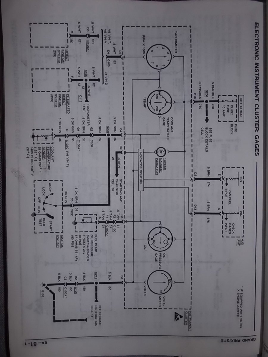

55trucker Posted July 3, 2019 Report Posted July 3, 2019 (edited) 20 hours ago, WillCut said: But yeah, wheres the darn tach wire so I can hook up my auto starter?!?! lol You've got the manual for the electrical section? Â Section 8 is where the diagrams are.....the schematic for the the cluster is in there, should/could be 8A, starting at page 80 Edited July 3, 2019 by 55trucker Quote
WillCut Posted July 5, 2019 Author Report Posted July 5, 2019 I don't have the manual. I any suggestions on the best one for this car? I have read the forums that there is a white wire (or purple) going to to the cluster that is tach but I was hoping to tap it lower and to not have to go outside the firewall. Quote
55trucker Posted July 9, 2019 Report Posted July 9, 2019 (edited) Now that I have my camera back again.... Â here is the cluster schematic for the 91-93. As far as the wiring itself is concerned do not know if 94-96 conductor colours changed. Â Â *well.........this is a 1st.....the pic rotated for some reason & I can't correct it.* Â Â Â Â Â Edited July 9, 2019 by 55trucker Quote
WillCut Posted July 11, 2019 Author Report Posted July 11, 2019 (edited) Thank you for the diagram. I tapped into the tach on the dash instead of drilling through the firewall and that worked. White wire. I could not get the damn cluster out however. omg - who designed that setup?!?! is there some weird trick? Do you have to lower the damn steering column? anyhow. I got it all working and put a resistor for the VATs and everything starts fine now.... Of course with one exception... the !@#$!$% heat/ac do not work. I'm assuming the tapped into the wrong accessory line. Do these cars have 1 ignition and 2 accessories? Also, what is the favored book of the forum for these cars? Edit: Digging further I see there are two accessories. Orange and Purple with a white stripe. Apparently the Purple/White is the climate control. Does anyone know if I should just move the started 12v out from the orange to the Purple/White? I dont really care if the stereo starts or not or do I need a relay from orange to purple/white? Thanks! Edited July 11, 2019 by WillCut Quote

MemphisMan Posted August 5, 2019 Report Posted August 5, 2019 On 6/29/2019 at 4:35 PM, WillCut said: Ok, so I read the forums on how to do this procedure and found some pics from one of MephisMan's threads. I've located the black/white wire connector while fixing my power antenna. I ground the wire and nothing happens. I just got the car and don't have much history but it only has only 65k on it and seems to be in decent shape. I wouldnt suspect much hacking of the wiring and it certainly looks normal. The only remote I got was aftermarket but I'm assuming it can be programmed natively with the car. its a Prestige 105BP. I bought a used 2522338 remote since I needed another set of keys anyhow and this Prestige looks gaudy. The destination remote doesn't matter since I cant even get the lock/unlock programming mode from jumping the black/white wire. any ideas? Edit: oh lord... I just dug under the dash and found an Audiovox rx14pbl... clean install at least... Why would something like this be installed? the car doesn't remote start as far as I can tell. Edit2: Yep... I have a Prestige APS687C installed in the car. Just doesn't work for the remote start, however. Oh well, guess that explains why I cant program my normal remote! Probably N/A at this point sounds like, but for whats it worth, my RKE module would not go into program mode (using the jumper) because the solder joints were bad in the module. I used a test light to verify I had power going to the RKE module. Once verified, I perfomed the RKE solder fix, then it would enter program mode. I know you have an aftermarket device installed, but you could still have a faulty RKE module, but not sure it matters at this point. 94 olds vert 1 Quote

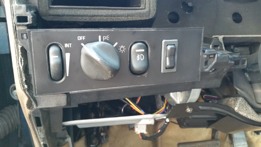

WillCut Posted August 8, 2019 Author Report Posted August 8, 2019 (edited) RKE solder fix? I'll have to look that up. RKE Module topic I thought that even if I had an aftermarket starter that the old RKE should still work. Is that the silver box mounted under the console? My car is crazy - its popping fuse #39 now, I've disabled everything I've even touched or looked at. Stereo, the cluster, this light switch (below with convertible top switch). Ugh... guess ill look under the console again, I had that cover removed when I was looking at how to hydrographics the thing...  Edited August 8, 2019 by WillCut Quote
MemphisMan Posted August 9, 2019 Report Posted August 9, 2019 RKE solder fix? I'll have to look that up. RKE Module topic I thought that even if I had an aftermarket starter that the old RKE should still work. Is that the silver box mounted under the console? My car is crazy - its popping fuse #39 now, I've disabled everything I've even touched or looked at. Stereo, the cluster, this light switch (below with convertible top switch). Ugh... guess ill look under the console again, I had that cover removed when I was looking at how to hydrographics the thing...   The RKE module on the '95 verts is located behind the rear seat back. You can see it from the trunk if you remove the carpet, but the best way to get to it is to remove the rear seat back. It will be a black box wrapped in blue plastic with two wire connectors going to it. Here it is on my 95 vert. You won't have the relay to the left of the RKE module. I put that there to make the parking lights flash when I lock/unlock the doors. Quote
MemphisMan Posted August 9, 2019 Report Posted August 9, 2019 RKE solder fix? I'll have to look that up. RKE Module topic I thought that even if I had an aftermarket starter that the old RKE should still work. Is that the silver box mounted under the console? My car is crazy - its popping fuse #39 now, I've disabled everything I've even touched or looked at. Stereo, the cluster, this light switch (below with convertible top switch). Ugh... guess ill look under the console again, I had that cover removed when I was looking at how to hydrographics the thing...  That's a good place to put the vert top switch. I don't think I've seen that done before. It looks good there!  What did you do with the original housing it was in? That is a one year only piece, so I'd hold on to it. I paid decent money to get a spare one to hydrodip so I could keep the original one pristine. Did you know the empty space in the headlight switch was supposed to be for HUD controls?  They were going to offer a HUD in the 95 Cutlass Supreme, but pulled the plug at the last minute. You can see the switch in your owners manual. As a matter of fact, if your car is a 3.4 DOHC car, it's actually prewired for HUD. I found a light switch with HUD controls about 3 years ago and ended up installing HUD in my vert. Quote
