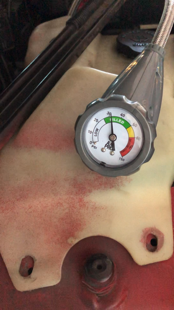

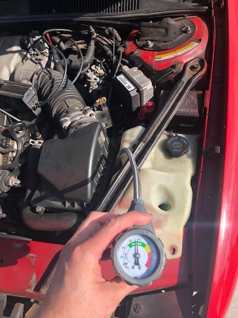

The AC in the car is just blowing very cool warmish air. I have read other places that if its hot, refrigerant would need to be filled.
I went ahead and bought ACPRO with the Meter on it. Seems like the system is green and has plenty of juice.
It looks like the compressor is working. Both Fans in front of the radiator are working normally.

I have another question if you guys don't mind. Is it normal for the fluid to go from around 40 to 30 psi when revving up the engine from the throttle? Do I need to place more refrigerant in the system?
  • 3 weeks later...
I load up as much refrigerant as I can at the beginning of summer to hit the high 40psi.  I haven't revved the engine while measuring the psi in the system.
Funny you should mention this. I went to get more refrigerant and I did put it up to around 40 PSI. Problem now, is its still blowing warmish air.
From putting all that in, I let it run for awhile and did not notice any leaks. So its still in the system, but don't quite know whats causing it not to blow. I think I have to check my radiator next, maybe wash it off with a house. The Fans both work in front of the radiator. When the I turn on and off the AC, it definitely working because you can hear the engine rev change alittle. I have no idea what else to look for lol.
