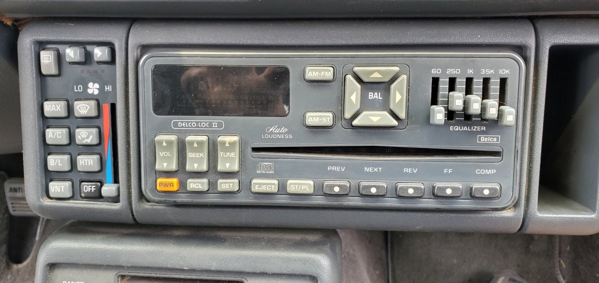

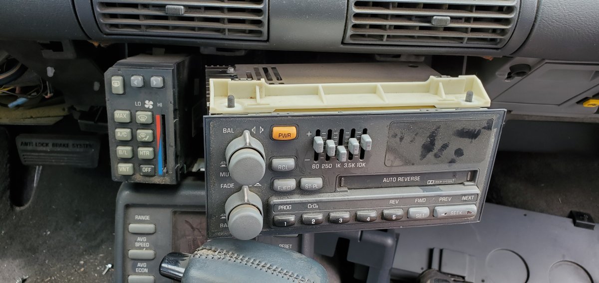

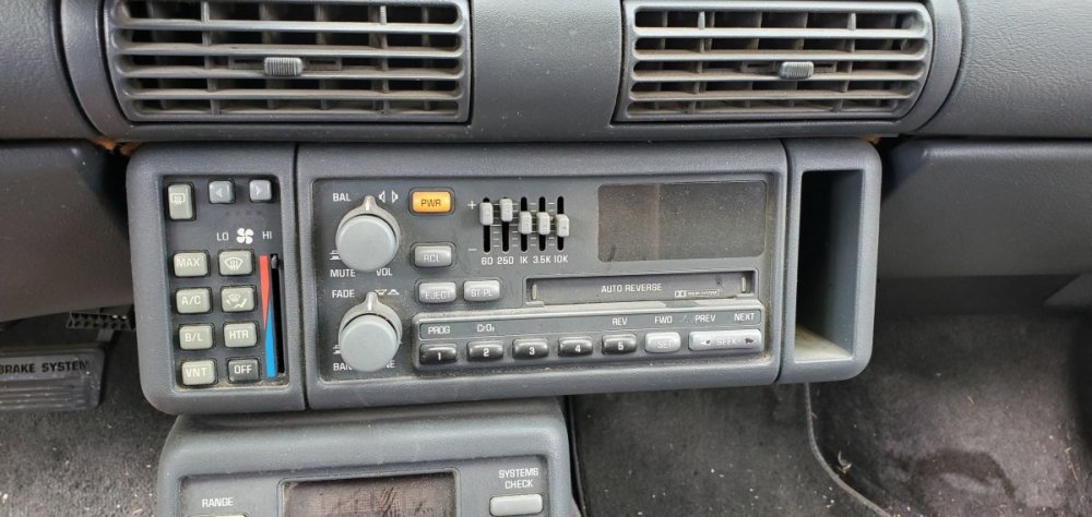

jiggity76 Posted June 23, 2019 Report Posted June 23, 2019 You guys know how this bezel or surround comes off? I don't want to damage anything and want to pull the radio. Quote
ManicMechanic Posted June 23, 2019 Report Posted June 23, 2019 Been a while since I have been in the dash of one but as I recall, it's similar to my van. There's a small screw or two behind the glovebox door and another behind the trim that goes under the steering column. jiggity76 1 Quote
jiggity76 Posted June 23, 2019 Author Report Posted June 23, 2019 56 minutes ago, ManicMechanic said: Been a while since I have been in the dash of one but as I recall, it's similar to my van. There's a small screw or two behind the glovebox door and another behind the trim that goes under the steering column. Thank you my friend. I will check it out. I didn't know if they are held on by clips or what. Doesn't look like I can get under the left part of it under the AC/heater controls but I'm going to look under the right side to see if they're are screws hidden there too. Never thought to look under the column or glove box so I'm glad I asked. Quote
digitaloutsider Posted July 4, 2019 Report Posted July 4, 2019 I don't know if you'e one ahead and done this, but it's very easy. Remove the driver's side kneeboard, two 7mm bolts hold the radio bezel up against the dashboard. Look up from the bottom and you'll see them. Open the glovebox door and swing it down (wiggle the glovebox door support arms and it will come loose) and there are two 7mms up there too. I don't remember it being clipped in at all. jiggity76 1 Quote

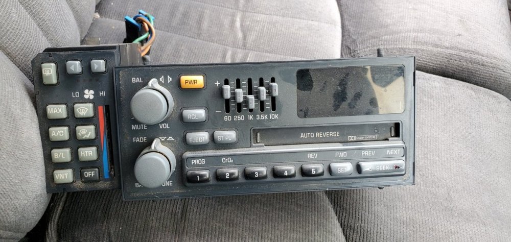

jiggity76 Posted July 5, 2019 Author Report Posted July 5, 2019 9 hours ago, digitaloutsider said: I don't know if you'e one ahead and done this, but it's very easy. Remove the driver's side kneeboard, two 7mm bolts hold the radio bezel up against the dashboard. Look up from the bottom and you'll see them. Open the glovebox door and swing it down (wiggle the glovebox door support arms and it will come loose) and there are two 7mms up there too. I don't remember it being clipped in at all. Thanks Digital! Yup, exactly how you described. Here it is! digitaloutsider 1 Quote

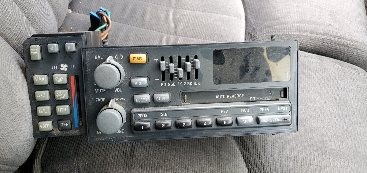

Pontiac6KSTEAWD Posted July 8, 2019 Report Posted July 8, 2019 Not meaning to HiJack your thread, just a question. Are those CD players valuable or something? I just was cleaning out my garage, and found a bin with 4 of them in it. Wondering if I should junk them or? jiggity76 1 Quote
jiggity76 Posted July 9, 2019 Author Report Posted July 9, 2019 1 hour ago, pontiac6ksteawd said: Not meaning to HiJack your thread, just a question. Are those CD players valuable or something? I just was cleaning out my garage, and found a bin with 4 of them in it. Wondering if I should junk them or? Oh sweet Lord now, please don't junk them! Can you post some pics of them! I would be interested in buying them, seriously. Quote
jimmyfloyd Posted July 9, 2019 Report Posted July 9, 2019 Sell them to Jiggity! He'll appreciate them. if not, sell them to me. I would do $20 each plus shipping assuming they are all similar vintage to that one. I clean and tinker with them to get them working and resell. it's a low success rate though (under 20% thanks to the CD player) Quote
Pontiac6KSTEAWD Posted July 9, 2019 Report Posted July 9, 2019 (edited) They are all identical vintage to the one above. Well, I will have to get a for sale thread in the making this weekend. The bin had a bunch of odds and ends. Stock TGP air intake (complete), Washer fluid tank. TGP steering wheel controls, and more.. I even still have some parts from my old AWD STE. I do remember that one of them worked flawlessly. I pulled it from my TGP when I sold it. The buyer just wanted the stock tape deck. Edited July 9, 2019 by pontiac6ksteawd Quote
RPE1992GPSE Posted July 11, 2019 Report Posted July 11, 2019 Does the VFD (clock) dim properly on that model when you dim the interior lights? I'm just curious because I know GM used pulse width modulation to dim the VFDs in the W-bodies. If you put a radio in with a rheostat dimming circuit for the clock display, it will blink at varying rates depending on the intensity of the interior dimming. That radio looks like it came from a Firebird or maybe a Bonneville, that's why I ask. jiggity76 1 Quote
Pontiac6KSTEAWD Posted July 11, 2019 Report Posted July 11, 2019 1 hour ago, 1992GrandPrixSE said: Does the VFD (clock) dim properly on that model when you dim the interior lights? I'm just curious because I know GM used pulse width modulation to dim the VFDs in the W-bodies. If you put a radio in with a rheostat dimming circuit for the clock display, it will blink at varying rates depending on the intensity of the interior dimming. That radio looks like it came from a Firebird or maybe a Bonneville, that's why I ask. They came in the High End optioned Pontiac 6000 STE AWD/SE AWD, 1990 Pontiac Turbo Grand Prixs, Pontiac Bonneville SSE/SSEi, and the Pontiac GTA (I think 90 and 91). Internally, to me, they are built just like the tape deck, but with a CD drive Mechanism. I rebuilt one a few years ago from the face plate and CD drive of this style radio, and the case and internals from a 5 band tape deck. The CD drive is not the failure point, in my experience, its a real small sensor that reads whether a CD has been inserted into the mechanism. It sits right at the mouth, and is a real pain to change. jiggity76 1 Quote
