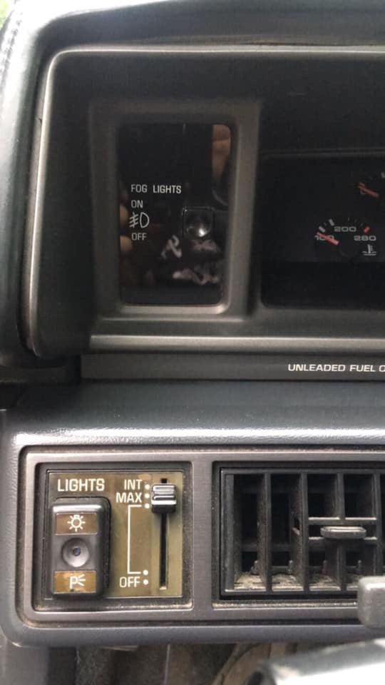

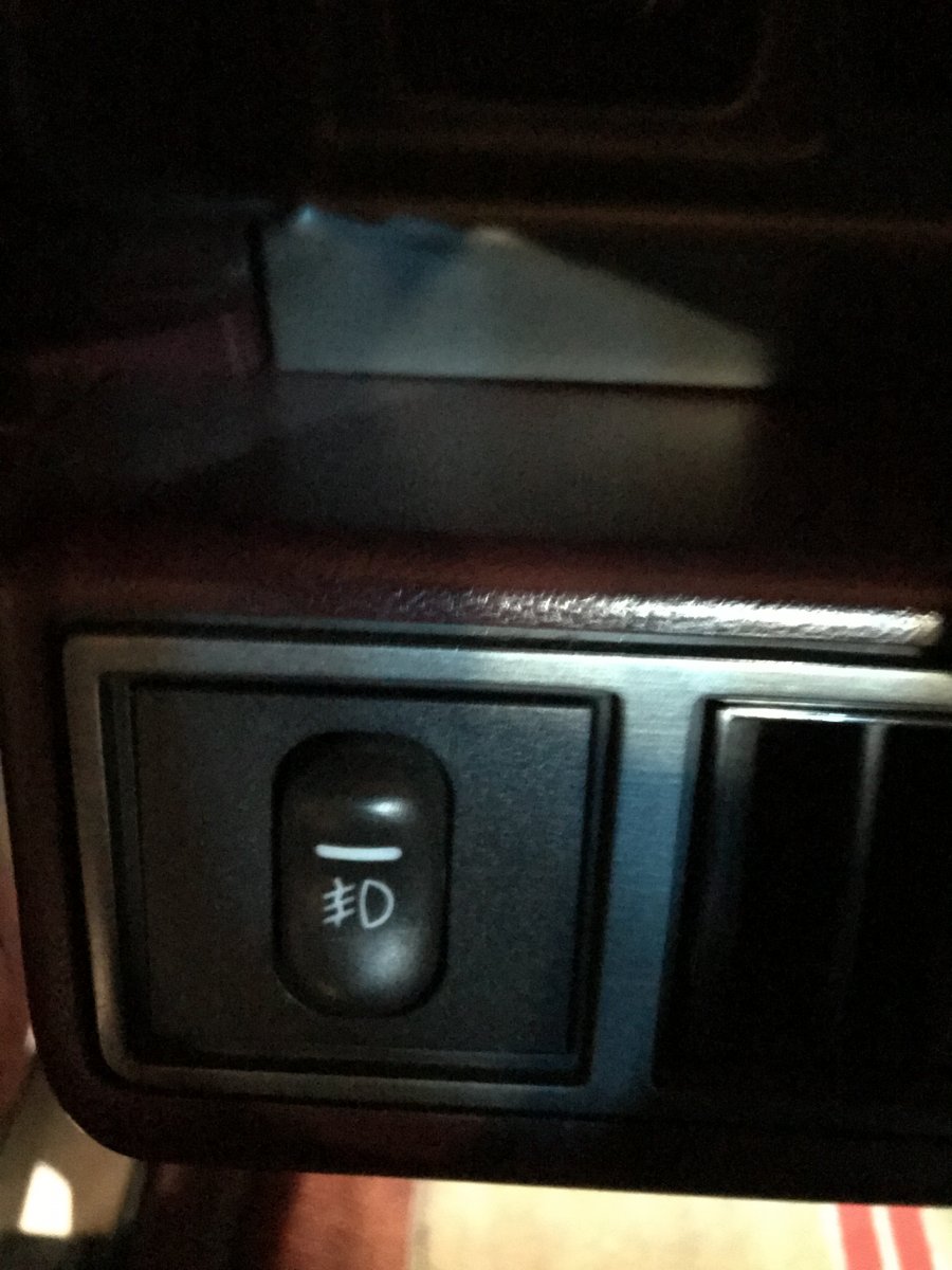

In my 94 there is a switch on left side of dash just below the light switch just left of air conditioning vent
this next answer is from owners manual
“When using fog lights, parking lights or low beam headlights must be on.
The fog lights will go off whenever high beam headlights come on. When high beams go off, the fog lights come on again.”
took pictures of my switch location
sorry cant be of more help
good luck

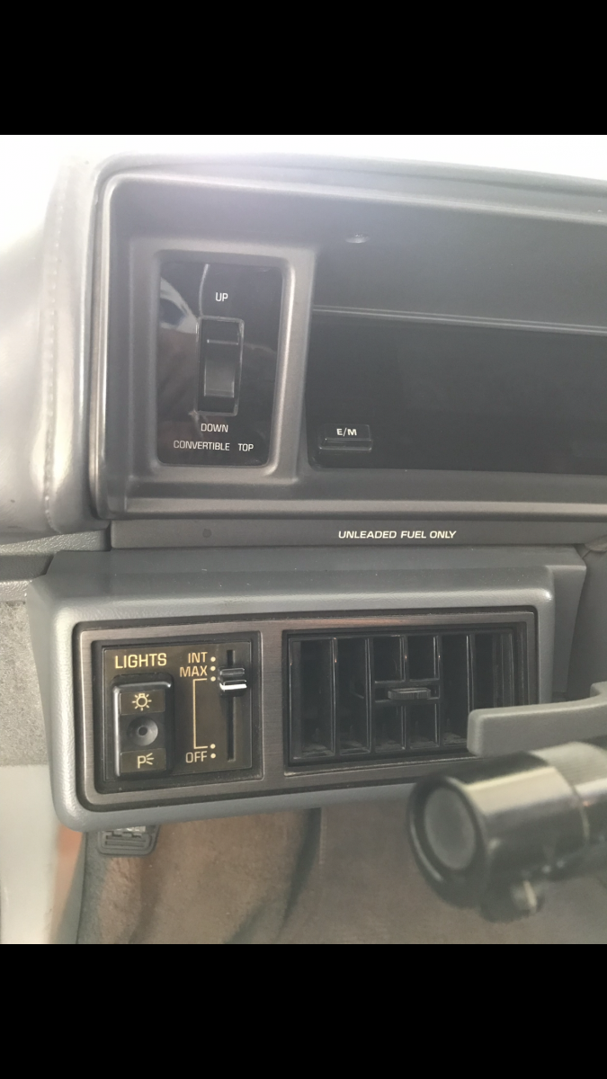

My 90 doesn’t have any of that. All I have is the headlight button. Where your light switch is is where by convertible top button is. It’s strange. I know fog lights were an option but there should still be a switch for them.

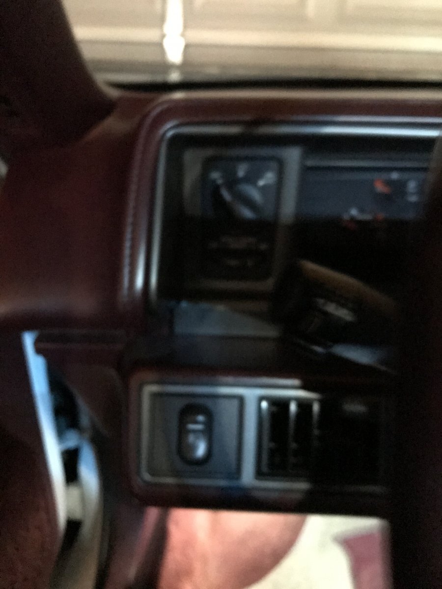

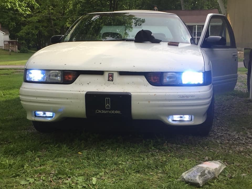

Here is a picture of the fog light switch of a 1993 Cutlass fog light switch location
location is different than mine

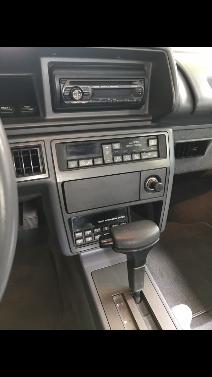

This is what you should have, 90-93 are set up like this.
There is a switch on your center console just up from your shifter handle.
This is what my dash and buttons are. There is t a button anywhere. It’s odd. 2C974337-3A22-4C93-B2A0-57C59A1E1F72.thumb.png.838f795de483c97a7e22087f8a60135d.png

Looking at your olds I’m thinking the fog lights are aftermarket try following the wires. Also that’s a nice looking Cutlass 🚀

I also agree that those are aftermarket. Wrong location for factory.

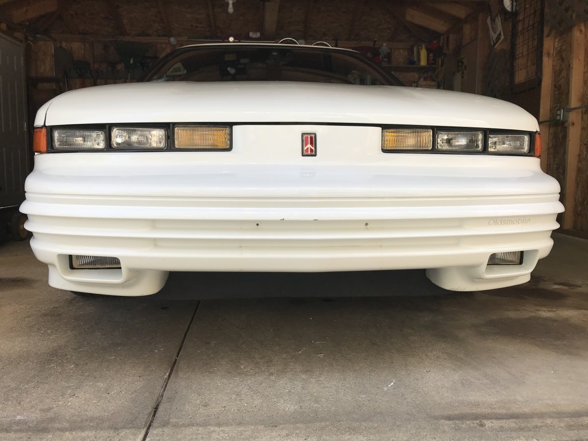

49 minutes ago, jmjp5055 said:
Top pic is my 94
Bottom pic is a friends 93
I like that the placement of the fog lights on the later cars. Inset with the bumpers. On the earlier ones they just hang out the bottom.
I followed the wires and the lights aren’t wired to anything. They’re just bolted there. You were right. They’re aftermarket.
