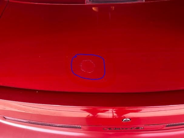

Clear Coat starting to come off
I was wondering what I could do, (if anything) to possibly make this look like the rest of the cars clear coat. If not, is there something I can put on it to help protect the paint. Thank you!
Patch it with filler and vinyl wrap it?
If its just on the trunk lid it might not be all that much to have a shop work on it.
I have the same thing on the tops of my front fenders. The clear coat has separated from the color coat underneath but is still intact. It hasn't started peeling up. I guess it's only a matter of time before that happens.
Delam is delam whether it's the clearcoat or the basecoat.  Whichever it is the only fix is to strip and repaint.  Keep in mind that it must be stripped, not feathered out, or you will end up with the same nightmare I had when the shop I used did that and the car needed to be re-stripped and repainted again.
