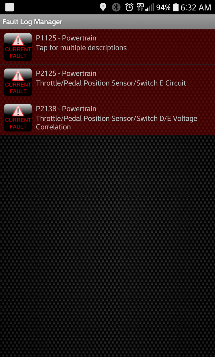

pyrohatchet Posted March 21, 2019 Report Posted March 21, 2019 Hello, I bought this car and shortly after having it a my DD it started throwing codes and going into reduced power mode. I got the codes read and my buddy told me it looked like the PPS. So I replaced that. It drove good for about a week then started the reduced power mode again. So then I replaced the TB. It's still going into reduced power mode but not as often. Here is a picture of the codes I get. What should be my next step to get this fixed? Thanks guys. Quote

digitaloutsider Posted March 21, 2019 Report Posted March 21, 2019 Here's some info on those DTCs: https://www.w-body.com/shaun/p2125.htm https://www.w-body.com/shaun/p2138.htm I'll see if I can get the actual schematic when I'm off work. It's from eSI, so the links inside the document won't work. pyrohatchet 1 Quote
