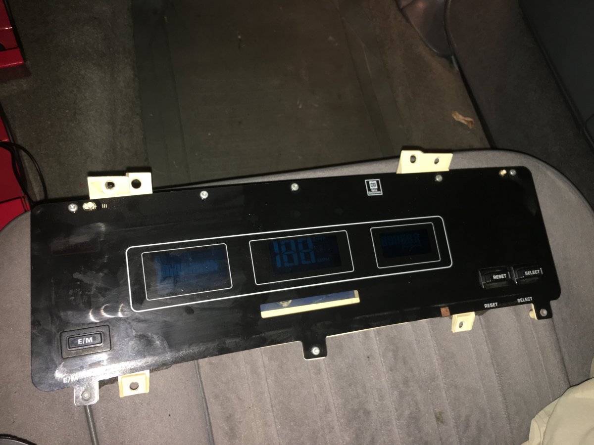

1987 GMC Jimmy Posted February 8, 2019 Report Posted February 8, 2019 I’ve only found one place on the continent that can fix my dead cluster and reprogram the odometer to not say “error” after 200,000 miles which mine should be almost at. Does anyone know what I can do? Is this something that happens every time? This company apparently used to have a contingent in North Dakota, Mr. Whizard, but they’re now moving everything to Manitoba and no longer accepting U.S. orders as of this month. I’m in a real bind here so if anyone has any ideas, I’d appreciate them. Otherwise, I’ll have to send it to someone in Winnipeg that can take it there in person, but I’d rather not pay all that money if someone stateside can do it. Thanks! I care mostly about having my mileage right, or I’d investigate getting a later cluster that’s not digital. Quote

1987 GMC Jimmy Posted February 13, 2019 Author Report Posted February 13, 2019 On 2/9/2019 at 11:56 PM, Schurkey said: News to me. Sure they won't read more than 200K? WHAT VEHICLE IS THIS??? No, this is just what I’ve been told, which sounds like a bunch of consensus no one agrees on. This is in a ‘90 Olds Cutlass with the Delco digital cluster. Is it possible that it may not display an error? I’ve also been told that replacing the entire board is necessary rather than just the chip, but I don’t know what to believe at this point... Quote

1987 GMC Jimmy Posted March 22, 2019 Author Report Posted March 22, 2019 I’ve got it working again, but the people I sent it to were pretty half ass. It’s got 186XXX miles on it so no error, but when you switch it to KM mode, it does show “Error.” Quote
