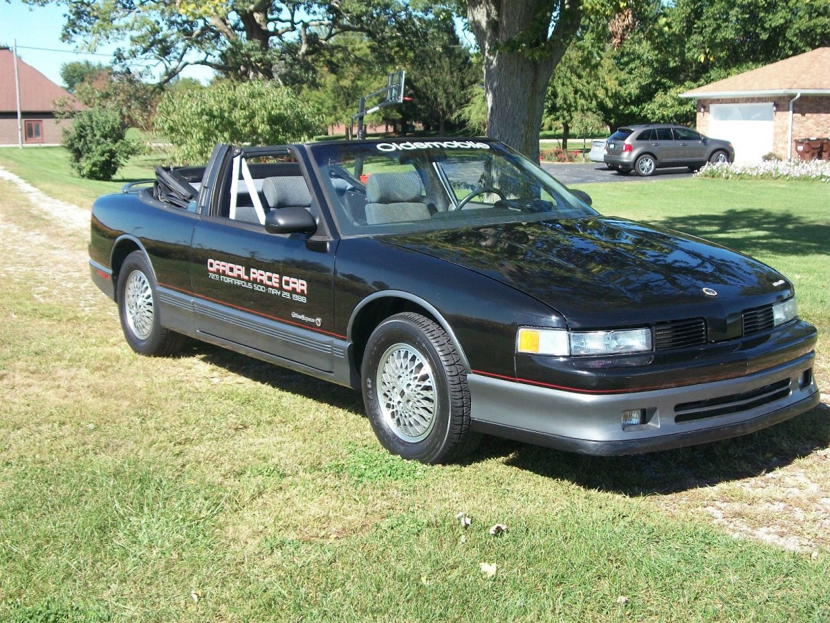

ManicMechanic Posted January 18, 2019 Report Posted January 18, 2019 Gentleman named Paul bought a bunch of Oldsmobile drafting papers and these were among them. jiggity76, oldmangrimes, rich_e777 and 3 others 5 1 Quote
jiggity76 Posted January 18, 2019 Report Posted January 18, 2019 So are these developmental drawings for engineering purposes? Pretty neat! Quote
K&R Posted January 19, 2019 Report Posted January 19, 2019 The “roll bar” is a unique design on these. Was it originally designed for a roll over crash or extra body support since some ‘88s didn’t have the bar. Quote
ManicMechanic Posted January 19, 2019 Author Report Posted January 19, 2019 The '88s that did not get it were true roadsters, no top at all. The "basket handle" offers zero protection in the event of a rollover. Quote
K&R Posted January 19, 2019 Report Posted January 19, 2019 31 minutes ago, ManicMechanic said: The '88s that did not get it were true roadsters, no top at all. The "basket handle" offers zero protection in the event of a rollover. So the handle is made for structure? Did GM not put extra bracing underneath like a traditional convertible. Quote
ManicMechanic Posted January 19, 2019 Author Report Posted January 19, 2019 4 minutes ago, K&R said: So the handle is made for structure? Did GM not put extra bracing underneath like a traditional convertible. None what so ever. The b-pillar was reinforced but between the pillars was just the same metal that was there when it began life as a coupe. jiggity76 1 Quote
Imp558 Posted January 19, 2019 Report Posted January 19, 2019 Someone was talking a while ago about the notches cut on either side of the engine bay on a 'vert. I assume those were to provide more crumple in a front end collision. Makes me wonder what other little things like that are in place that haven't been noticed. Quote
K&R Posted January 19, 2019 Report Posted January 19, 2019 Wow!! So 1990 is the first full production year for the convertible. So the weak structure caught GM off guard and that’s why their aren’t any 1989 convertibles so they had to push it back to 1990? Quote
ManicMechanic Posted January 19, 2019 Author Report Posted January 19, 2019 17 minutes ago, K&R said: Wow!! So 1990 is the first full production year for the convertible. So the weak structure caught GM off guard and that’s why their aren’t any 1989 convertibles so they had to push it back to 1990? Correct. Quote
K&R Posted January 19, 2019 Report Posted January 19, 2019 Oh wow. The handle was just a quick fix then through the whole production! So I noticed the Chrysler PT Cuiser has the handle as well. Do you know if they did the same thing or is there extra support underneath? Quote
