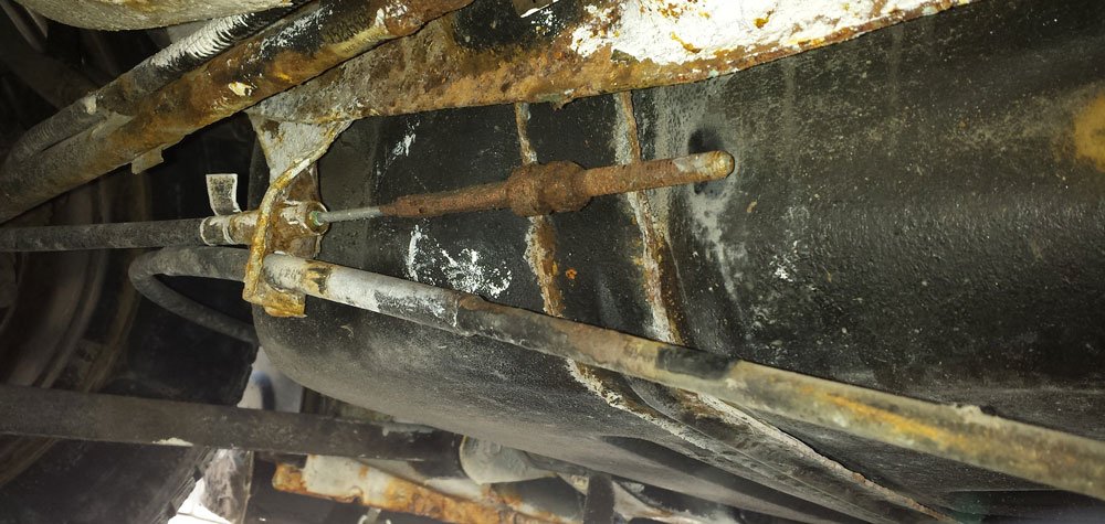

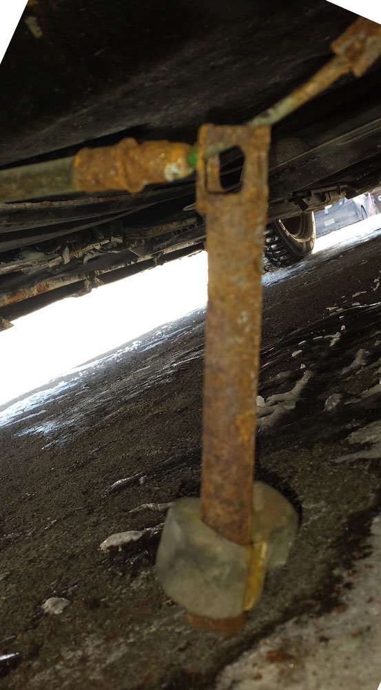

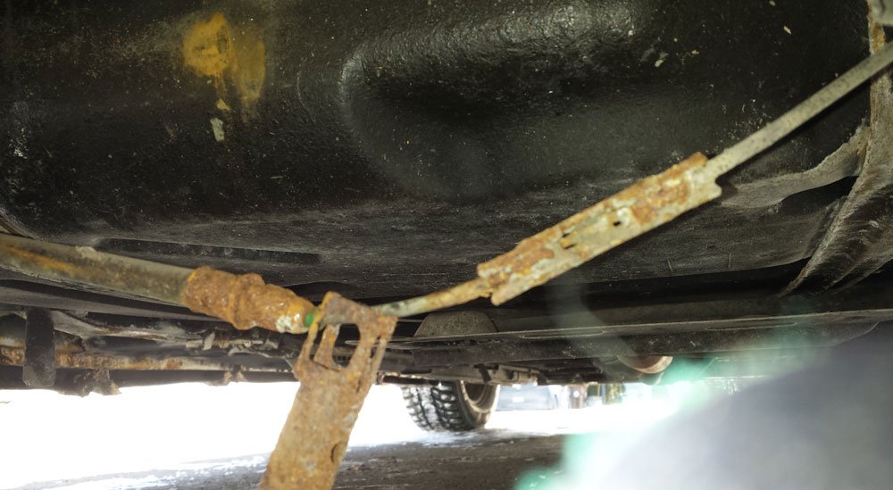

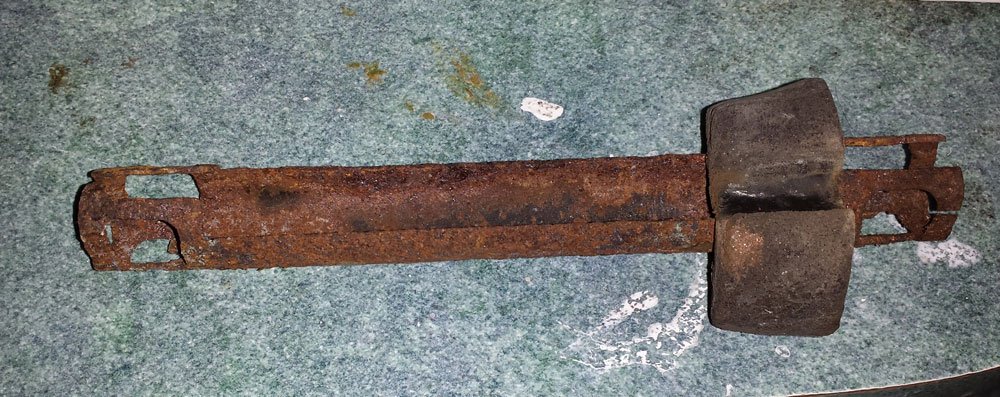

Hi all,
The car is a 2007 Pontiac Grand Prix base 3800. I went to use the parking brake and something snaped. I had a look around and you’ll see in the pictures here like the adjuster casing from the front cable broke. I managed to pull it off the cable. I would think that the mechanism is repairable please. As in could I buy just the part that broke. I did have a look for the part online, but I wasn’t able to pinpoint. Otherwise the cables are in decent shape, the two rears ones were changed. My guess is that I would have to disconnect the front cable from it.

The whole system is pretty rotten. Best to get all new cables and hardware. Go to rockauto for the cables. The cable linkages will require you to hit Napa as they’re not listed. Nothing good will come of piecing it together from Amazon. One wrong part and you’ll be scratching your head when something is to short or to long. Better get some oil on the Other rusted bits while your down there as well.
