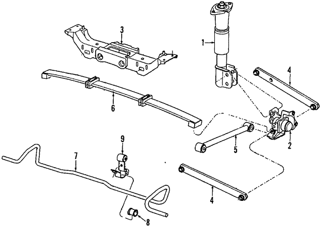

Nicutlass_Supremacy Posted December 14, 2018 Report Posted December 14, 2018 I´ve recently change all the bushings in my Cutlass. But lately it´s been doing some strange things when turning to the right. I´ve found that one of the 4 rear struts that go along with the leaf spring has losen. It seems that both bushings are loose from that bar. Is there any thing better to install there? Some adjustable struts like those in Corvette´s? I don´t want to use those bars again!!! Thanks! Quote
vipmiller803 Posted December 14, 2018 Report Posted December 14, 2018 Do you mean the lateral arms? The second gen ones are a direct fit for the rear ones with adjustability. The front either has to be shortened for the adjustable one or bought as the non-adjustable one. Quote
Nicutlass_Supremacy Posted December 14, 2018 Author Report Posted December 14, 2018 They are those mark with a 4 Quote
vipmiller803 Posted December 14, 2018 Report Posted December 14, 2018 Yep. Look into second gen ones. Like I said, the front one needs chopped about 1.5in for both to be adjustable. Quote
Nicutlass_Supremacy Posted December 14, 2018 Author Report Posted December 14, 2018 Where can I find those? Quote
vipmiller803 Posted December 14, 2018 Report Posted December 14, 2018 The auto parts store. Just ask for one for a 2000 grand prix. Quote

55trucker Posted December 14, 2018 Report Posted December 14, 2018 (edited) The BMR's are nice but somewhat overkill for general use. What one does is to purchase 4 of the OEM 2nd gen adjustable lateral arms (those arms fit a host of cars), as stated the long arms have to be shortened approx 1.5", one has to re-thread that shortened arm by the same 1.5". Now one measures two of the new arms to match the center-to-center length of the solid forward arms under your 1st gen car and locks them into place & installs them in the same place. The new rear arms are adjusted to match the old *rear* arms length & those are used to set the rear toe on the car. Using 4 adjustable arms allows you the option of adjusting the rear track width to something other than stock *within reasonable limits* if you choose to. https://www.ebay.com/itm/Rearward-Adjustable-Track-Bar-Pair-for-LaCrosse-Impala-Monte-Carlo-Grand-Prix/310869567497?hash=item4861452809:g:OmwAAOSwcnxb3VJM:rk:7:pf:0 Edited December 14, 2018 by 55trucker Quote

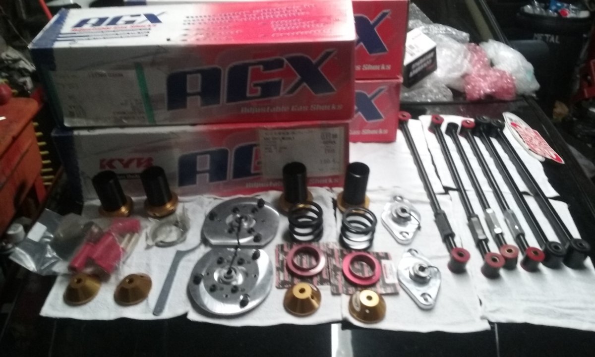

Imp558 Posted December 14, 2018 Report Posted December 14, 2018 If you look at the right side there's 4 second gen lateral links with poly bushings. Two are replacements and two were modified by GOT2BGM for me. Assuming there's a weld shop near you you could order 4 adjustable ones online, then take two of them and one of the old ones in as a template to have them shortened. Quote
