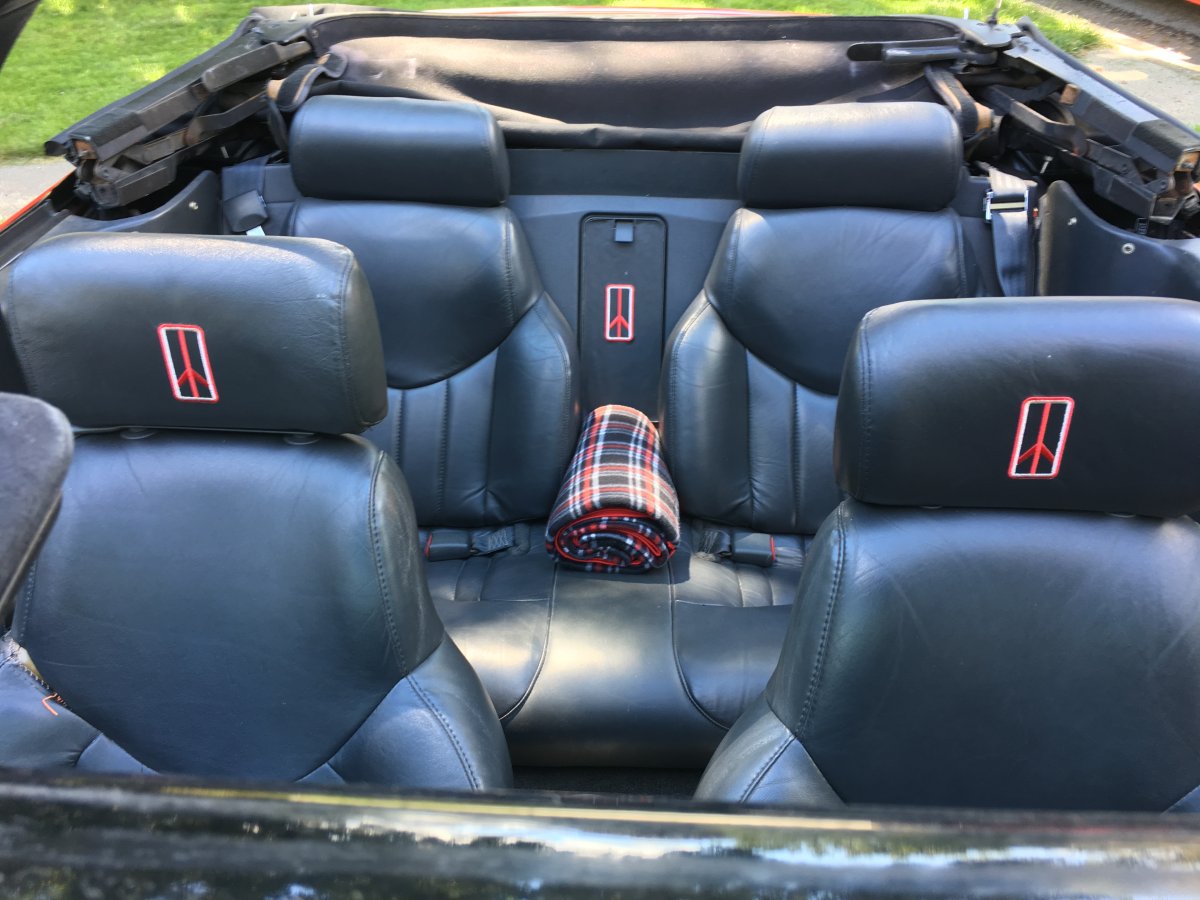

pshojo Posted May 16, 2019 Report Posted May 16, 2019 Here’s 95 that I did rear bench bottom and bucket tops Quote
