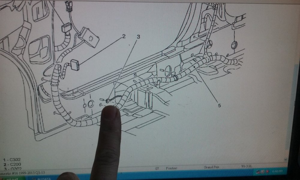

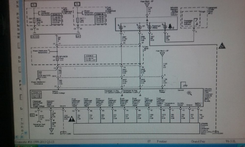

No sensor should require a handshake. According to Alldata the sensor is in the seat and the module is underneath the seat.
The module does have communications but even so I don't see why it would need a handshake since its not antitheft or theft prone.
I would try to score both from a yard car and do the module first.
