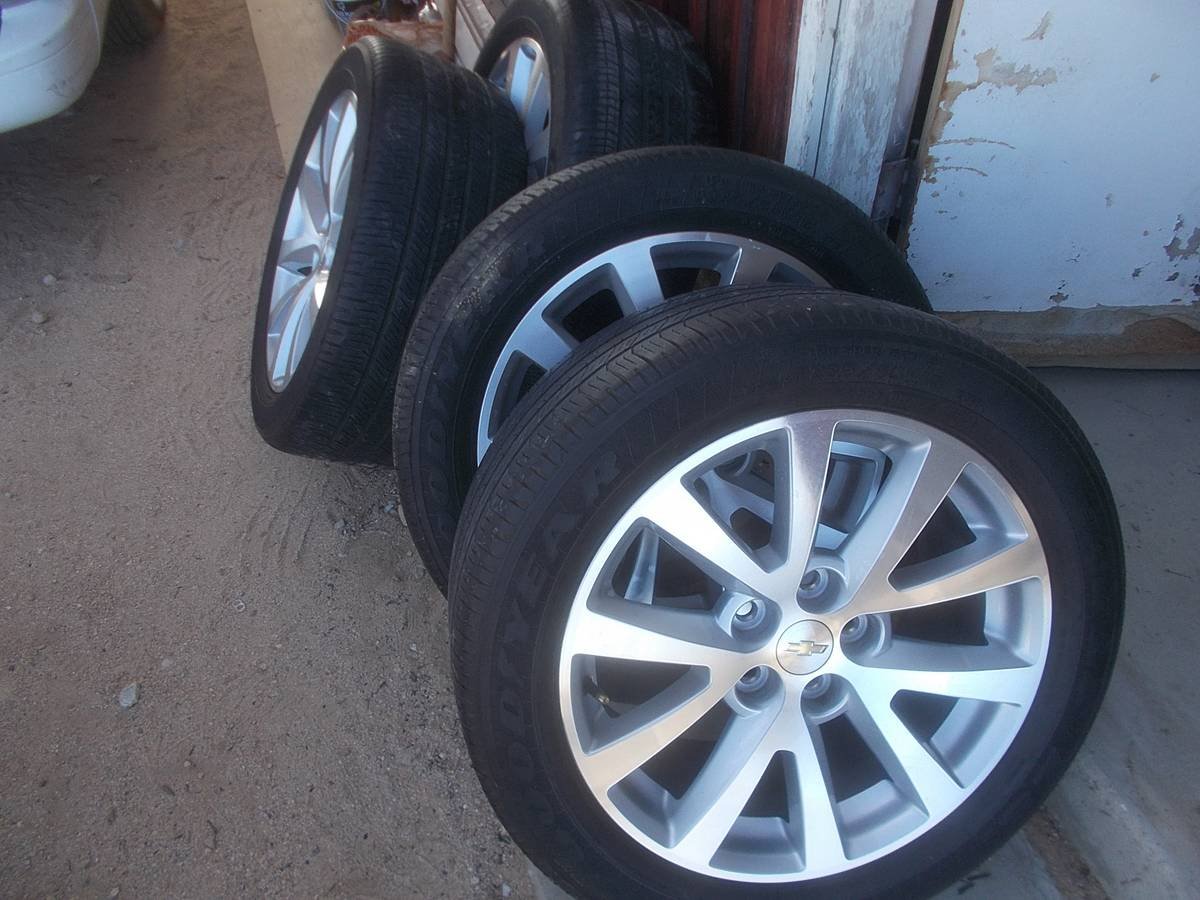

James Robert Posted December 2, 2018 Report Posted December 2, 2018 These came from a 2016 Malibu. I'm considering them for my CS convertible. Will have to try them on to see if they fit. Quote
jimmyfloyd Posted December 3, 2018 Report Posted December 3, 2018 https://www.wheel-size.com/size/oldsmobile/cutlass-supreme/1994/ https://www.wheel-size.com/size/chevrolet/malibu/2016/ And them plug the numbers in one of these: https://www.willtheyfit.com/ https://www.wheel-size.com/calc/?wheel1=215-60-16X6.5ET38&wheel2=205-65-16X7ET40&fcl=50mm&wcl=30mm&scl=50mm&sr=0mm https://www.rimsntires.com/specspro.jsp Quote
James Robert Posted December 3, 2018 Author Report Posted December 3, 2018 4 hours ago, jimmyfloyd said: https://www.wheel-size.com/size/oldsmobile/cutlass-supreme/1994/ https://www.wheel-size.com/size/chevrolet/malibu/2016/ And them plug the numbers in one of these: https://www.willtheyfit.com/ https://www.wheel-size.com/calc/?wheel1=215-60-16X6.5ET38&wheel2=205-65-16X7ET40&fcl=50mm&wcl=30mm&scl=50mm&sr=0mm https://www.rimsntires.com/specspro.jsp Thanks. I was looking for something like that online but couldn't find it. Looks like the wheels won't fit, the offset is quite a bit different. J Quote
jimmyfloyd Posted December 4, 2018 Report Posted December 4, 2018 did you check the calculators, or just look at the offset? The offset and the rim width go hand in hand, so you can't purely look at the offset and say they are too different, unless the widths are the same. This is because the offset is off the center line, and the center line will locate the wheel differently. That being said, a rim that is too wide may rub. Quote
James Robert Posted December 6, 2018 Author Report Posted December 6, 2018 On 12/3/2018 at 9:32 PM, jimmyfloyd said: did you check the calculators, or just look at the offset? The offset and the rim width go hand in hand, so you can't purely look at the offset and say they are too different, unless the widths are the same. This is because the offset is off the center line, and the center line will locate the wheel differently. That being said, a rim that is too wide may rub. I just looked at the offset, and the wheel width is over 1.25" different. I don't want to overload the bearings with a high offset. Quote
