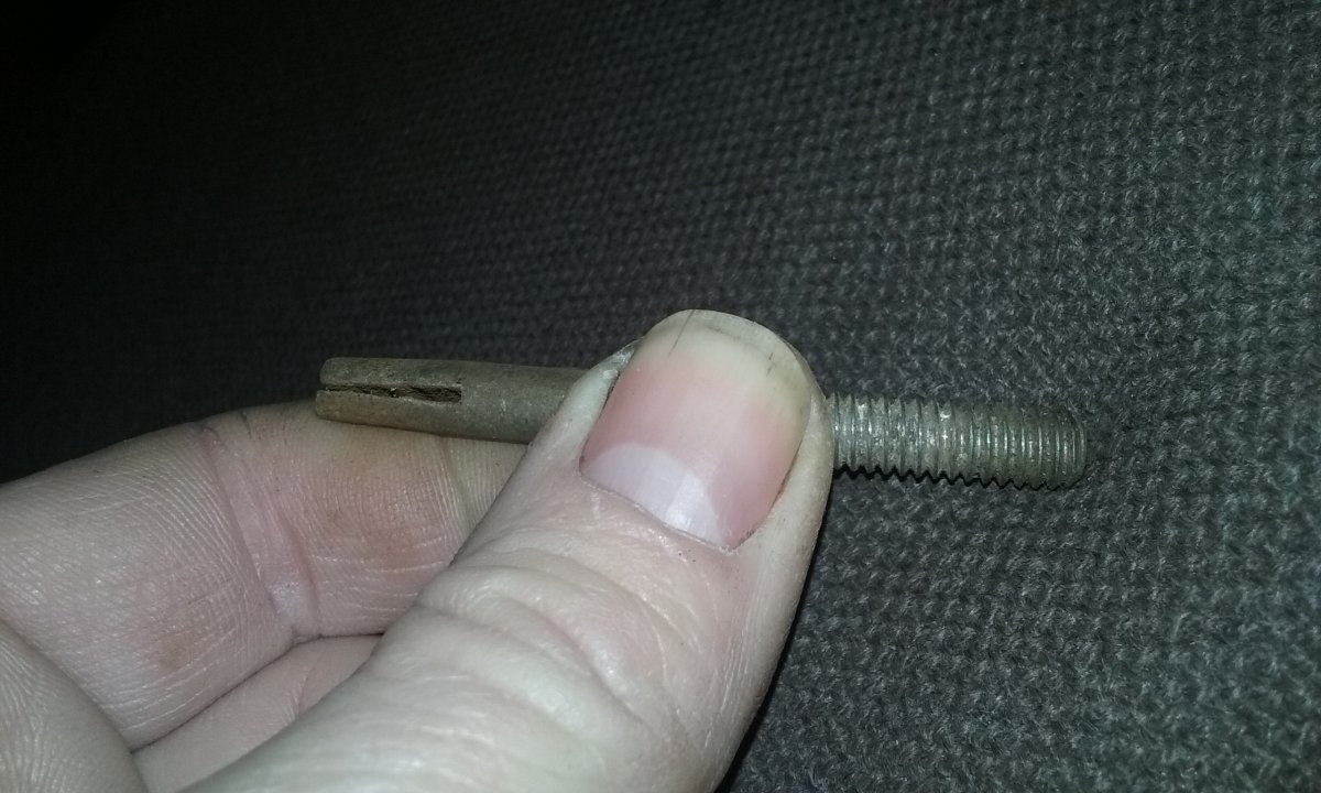

I have a tool I made that works for cleaning the slide bores and a lot more.
Mine is a 1/4" shoulder bolt, head cut off and about a half inch long slot cut in from the end.
I put a hunk of emery cloth in the slot and spin it with a die grinder or drill.
The shop I used to work at we called them "Flappers", I made mine to thread onto a little arbor that I have here but half the time I chuck it in like it is.
One day I'll make a longer one with some 1/4" rod from the hardware store.
Looks to be a good home made tool/idea.

That's essentially what the flapper does, and you can flip the emery cloth over and the back side will polish the bore.
