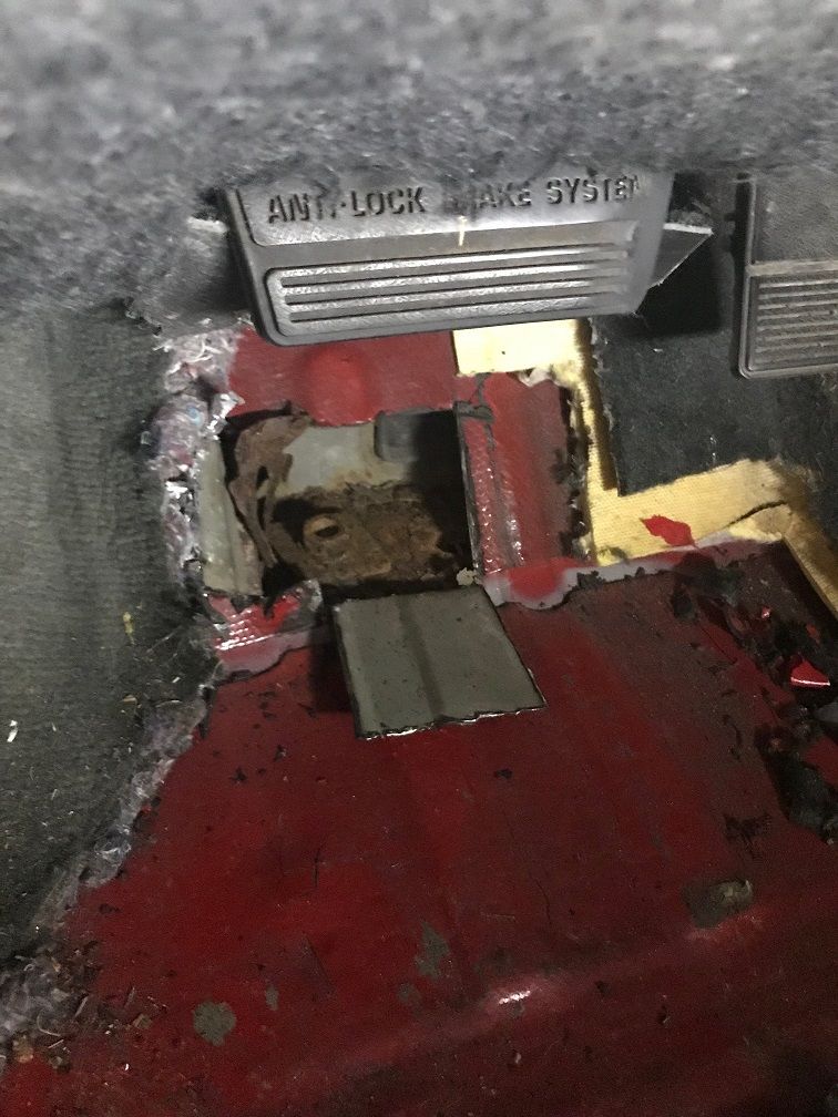

First, I supported the engine with a jack and a block of wood and cracked loose the four mounting bolts for the subframe mounts.   But I had to use a breaker bar to break loose the rear two mounts, and in doing so I broke the weld on the cage holding the hidden nut that is trapped inside two layers of the unibody by the drivers footwell.    I did NOT realize this at the time.
I spent a few hours removing the rusted, disintegrated remains of the original mounts.  Initially I just used a hammer and chisel to remove most of the metal and rubber.  But the metal parts of the mounts were wedged into the subframe and I couldn't pry them out.   After awkwardly fighting it for hours, laying on my back with limited clearance, I ended up using my angle grinder and cutting at the stuck metal  pieces.    Finally I got it all removed, put the new pieces in place and tried to reassemble them.  I couldn't get the parts to compress together, I fought it a while before realizing I hadn't removed all of the metal from the old mount, I thought it was metal from the subframe (I'm an idiot).   I tried again to compress the mounts in place but I realized that the nut was spinning and I couldn't get to it to hold it in place!    I was many many hours into the project at this point, spread out over weeks of time (vacations and other projects like my 1991 speedboat kept interrupting ) so I dejectedly gave up for a few weeks and left the car in the garage.  Eventually I found a thread somewhere here describing how a guy had to cut through the floor to get to the nut.    So, without knowing really what I was doing I cut through the carpet and insulation, cut and pried back a few-inch-square piece of floorboard (wow it was thin metal!  I've never cut a floorboard before, I just assumed it would be thicker metal), and saw the busted cage around the nut. (see pic of floorboard hole, with broken nut cage removed)  Even though the passenger side cage hadn't broken, I still cut through the floor on that side just to see for myself, I figured what the heck I'm already a bajillion hours into this project.

Anyway . . . I eventually realized that maybe I should check if the subframe was tightened properly.   When I checked, I could tell the bolts didn't feel tight (because the rubber had compressed more) so I tried to tighten them, couldn't (because the nut was at the end of the threads), and then FINALLY realized what was up, added more washers to allow the bolt to draw up the subframe mounts properly, adjusted my tie-rods again to center the steering wheel, and now four months later it's fixed!
I've driven for a couple hundred miles and it's driving better than it has in years.  I need to patch up the holes in the floorboards, currently I just bent the metal flaps I cut back into place and loosely covered with the carpet and insulation I cut out.   It's all hidden under my floormats for now, but I need to spray primer on the cut metal to slow the rusting and seal it up better for water and fire protection.

So that top nut and square plate was just spinning en capsuled in there?
Yes, there's a thin metal "cage" around the nut/plate combo to keep it from spinning, but the welds on that cage had broken off so my nut/plate was just spinning.  My guess is that the nut is not just simply welded to the floorboard because the cage design allows the nut to move around slightly before tightening, allowing subframe alignment.  I did not align my subframe, I just compensated with tie-rod adjustment afterwards.
I bent what was left of the cage up out of the way (you can see the rusted remains to the left of the nut) before the pic was taken, so I could get a wrench on the nut to hold it in place.   I'm sure there was a much more elegant way to do this.    I could have cut a much smaller hole in the floorboard but I didn't really know what I was getting into and couldn't find other pictures.  Hopefully your welds hold while you break loose the old bolts.   There's another small hole in the bottom of the hidden cavity (maybe for subframe alignment?) that is open to the elements under the car (you can see the edge of it in the shadow to the right of the nut), thus the cavity could fill with moisture and rust as you can see.   I tried squirting WD-40 inside that hole when I first started the project, to loosen up the nut but it wasn't enough.
Another issue I ran into was how to compress the two halves of the new subframe mounts together.   I tried using a jack to compress them together but couldn't, although hopefully that method works for you.   The stock bolt was just barely too short to reach the nut until the new mount is compressed.   Since I had access inside the hidden cavity, I used a longer bolt and a different nut (because the threads didn't match) and was able to draw up and compress the new rubber mounts that way.
