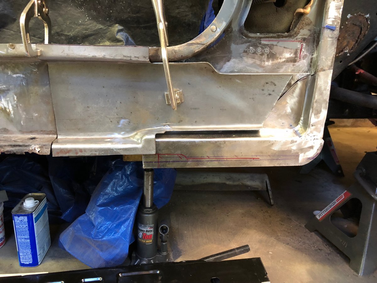

I didn't buy the right inner so I ended up fabbing about a foot of the front and another 14" of the back. Good fabbing experience as I have none. Came out pretty damn good, but took some time.
When you say made to work are we talking a few tweaks or major mods?
Thanks for taking time to reply to this rather obscure post.😎
That looks really good. The can looks like acetone so I'm guessing you know this but you have to clean all the oil from retail sheet metal or the topcoat won't adhere and it'll be left unprotected.
If you aren't planning on blowing undercoat into it afterward weld through primer really should be sprayed on the parts that are inaccessible to paint before you weld it up.
I'm looking forward to seeing more of this project.
Thanks. I appreciate it. Actually, all the metal I used was cleaned first before shaping. In some cases it had been treated with ospho as well as I had to remove a fair amount of surface rust. Once all the pieces were formed they were sandblasted to get them super clean. They were all properly treated with wax and grease remover and then sprayed with SPI epoxy.
Some files failed to upload., but here are a few more. Probably not in any order. Some before, and after plus a pile of pieces I had to fab. Welding in that lip tonight and a few other pieces this weekend. Some more priming tomorrow with the hopes of welding in the inner reinforcement next weekend followed by the outer rocker..
All internal and external pieces will be coated with epoxy. All internal and external welds will be coated with epoxy so nothing inside the rocker once complete will have exposed metal.
